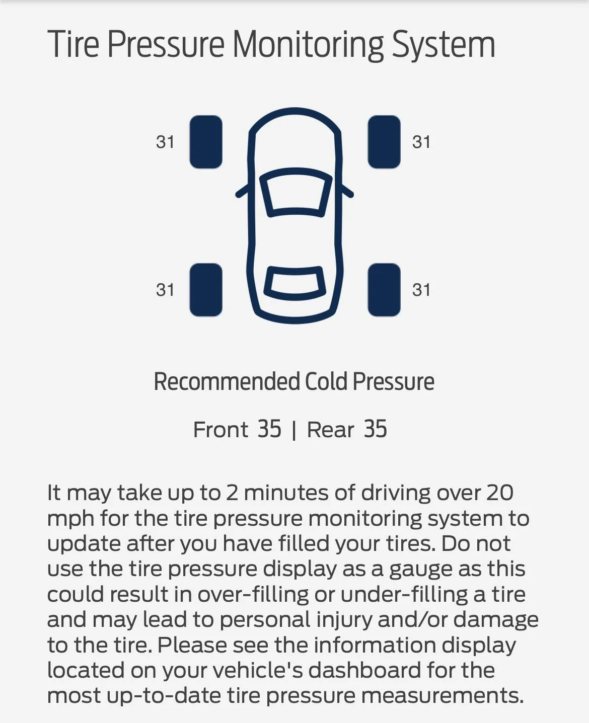

I noticed that on the FordPass on my phone has 35 psi as the recommended cold tire pressure. I believe that is Ford's recommended for best mpg.

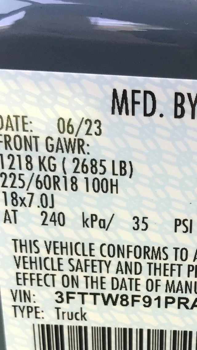

Something funny. The door sticker on my XLT Hybrid says tire pressure should be 34 psi. My tires say 44 psi. My pressure indicator on the info system confirms they are 44 psi. Obviously, 44 is correct, but why did I get a sticker with a normal car tire pressure listed? Annoying.
Use the vin sticker pressure see pic as long as your tires are stock and came with the truck
