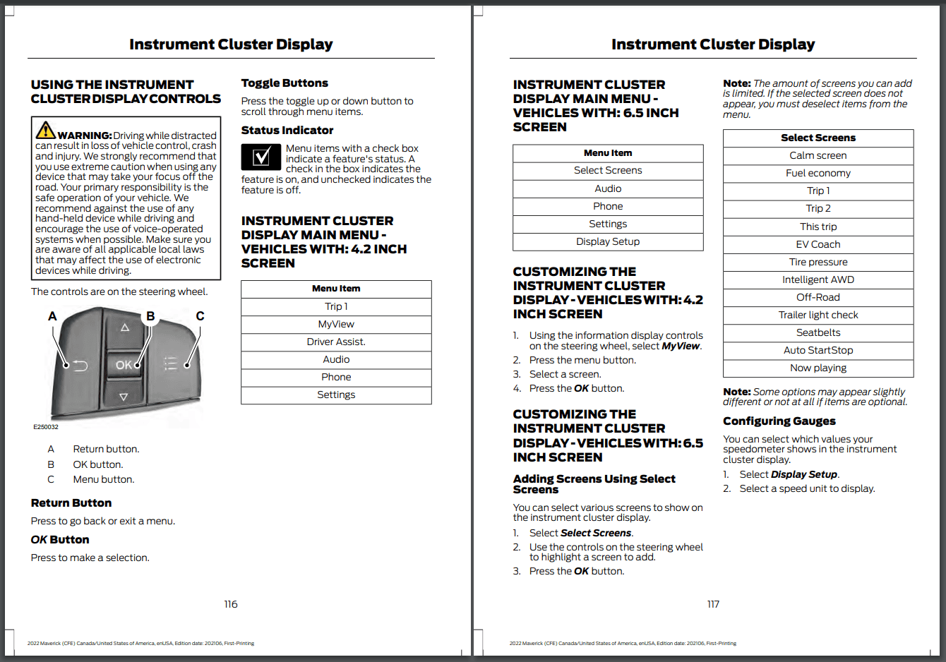

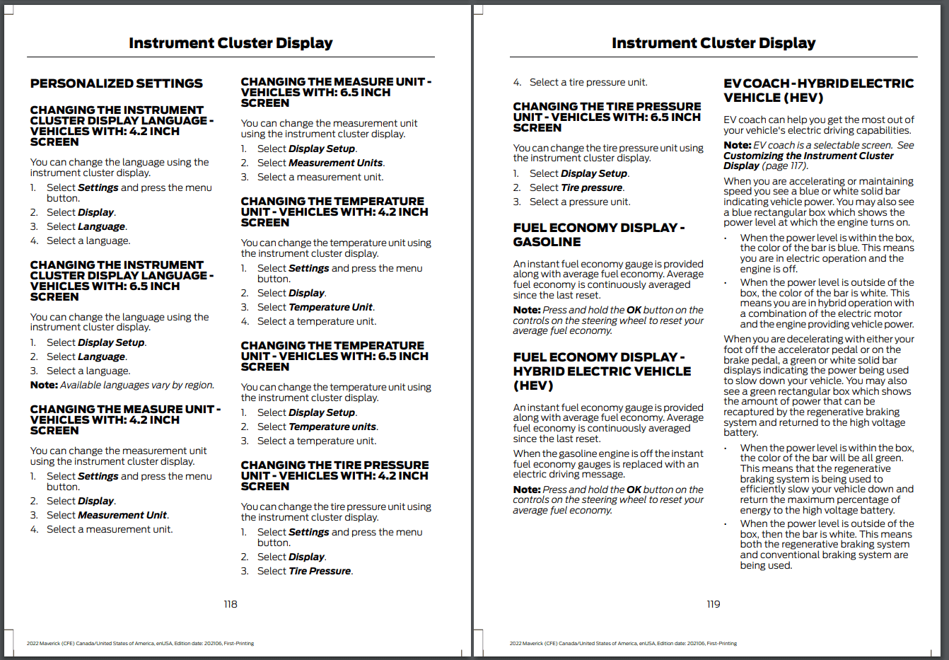

So, my Escape was setup the same way, and I had no idea you could click the OK button on the steering wheel or that it moved up and down. I read the manual and was like "mine is clearly defective cuz it doesn't have that".... so I brought it in and had someone walk out and show me in 2 seconds. I was red in the face. It literally says "click the menu button" and it all made sense after seeing it. For reference here is the Maverick manual how to:
The bottom of page 118 is how to select the display for tire pressure. Keep in mind that if you have too many screens already, you won't be able to select it. So you'll have to organize your screens. Mine is setup for Trip 1, Trip 2, Tire Pressure, and the base screen. That's it. I have no need to scroll through anything else. I don't need to know what angle I'm sitting on or have some "coach" telling me how to drive or which wheel is using power or what my music is. I just need MPG info and tire pressure info quickly and then it's eyes back on the road.
Here is a video on how to change those screens:
So in the "Select Screens" menu is where you want to deselect and select what you want to see. If you deselect everything and then go in order of the screens you want that's how it will display to you as you scroll (I think - it may be default the way it's setup in the menu, I'm not near my truck right now so forgive me for not checking).
I hope this helps clear some things up.

Thanks for sharing. Unfortunately this doesn't really resolve the issue. I use the Menu button, OK button, etc. Select Screens is only available on the Lariat edition. XLT only has MyView...and no option for tire pressure screen. Same for Trip 1, Trip 2, Settings,...as well as Phone and Audio.
I used to be able to see the tire pressure screen, but it disappeared a few days ago after I filled up my tires. I thought it used to be in MyView or Settings under Information or Display, but no option there now. Tire Pressure under Display just lets you choose psi vs kPa vs bar; that's page 118 above explains.
Thanks anyways.
If anyone has other ideas, I'm all ears.
