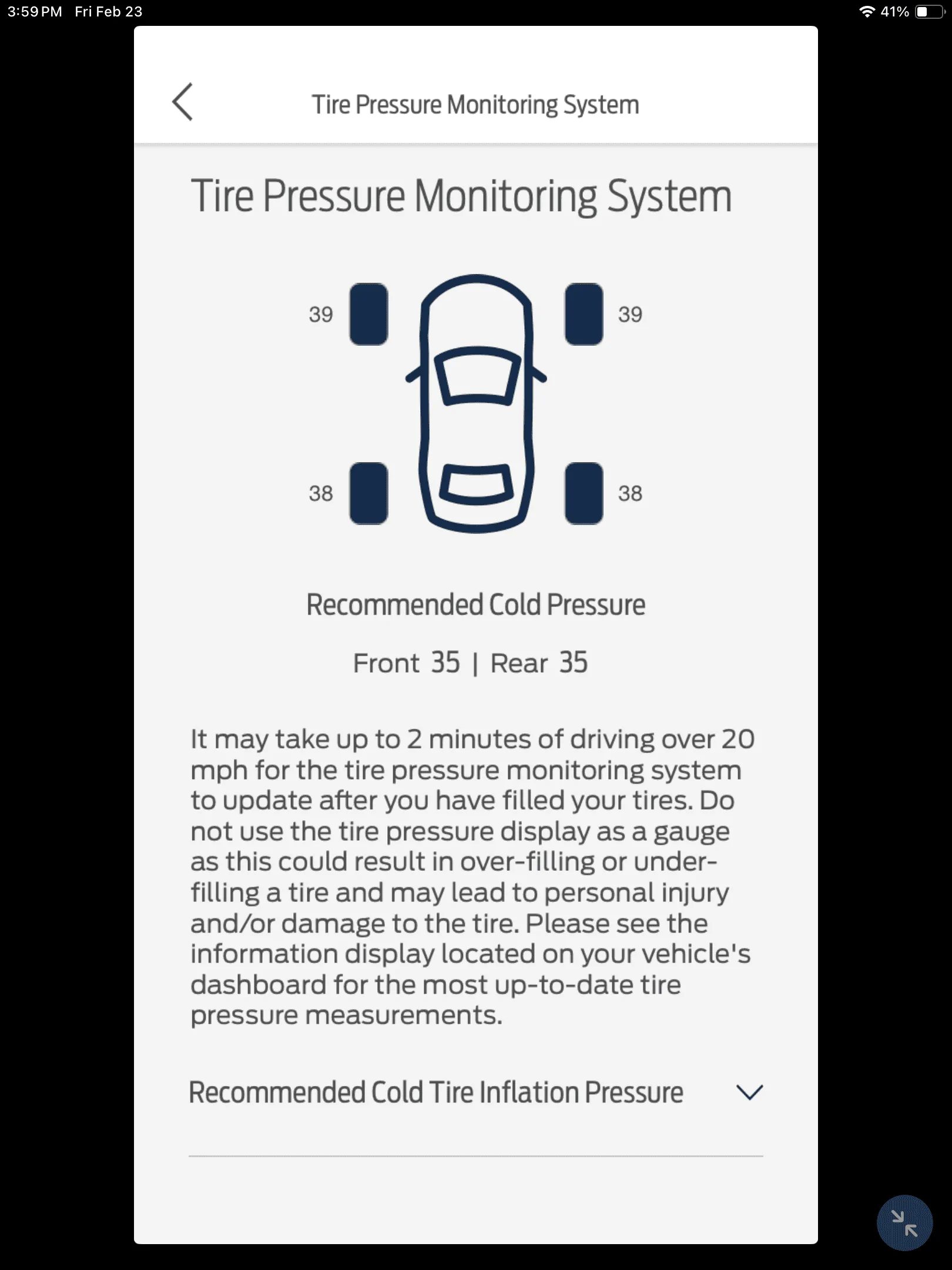

I was actually going to ask about the tire pressure on my new delivery. And about if the on board pressure readings are accurate. I haven’t checked them with a gauge cause then I’d be asking is my gauge accurate. lol
Here’s a screenshot from the fordpass app for cold tires just now - mine have been a bit high since delivery last month. The ride has seemed okay so I didn’t make any adjustments but I’ve read in the past that overinflation can lead to the center of the treads wearing faster. If the readings are accurate, I guess my dealer didn’t adjust the shipped pressure to the recommended level. Hybrid XLT if that matters.

Yep. My dealer didn't do it either (even though their pre sales inspection checklist says they did). They also didn't fill the windshield washer fluid.

I don't know if my gauge is accurate, but if it isn't, it's off by the same amount as all 4 of the TPMS sensors in my truck ...
:D my gauge agrees with the TPMS with the exception of the left front that reads +1psi on the dash.
not too bad, glad I'm not OCD. Guess if I were I could drop the LF a pound but I'd still know that, oh the horror 😱

44 is a bit much even rolling hot.
Adjust around 35-38psi when cold and that should get you around 38-42 when warm and rolling. I think I have mine set to 36 (granted, they are 245/65R17 KO2's, but still would have been the same with the stock tires maybe 37). Mine get to around 40 on warm days longer trips.
Measure the pressure at the wheels and they should be within 1 or 2 psi of the dash.
