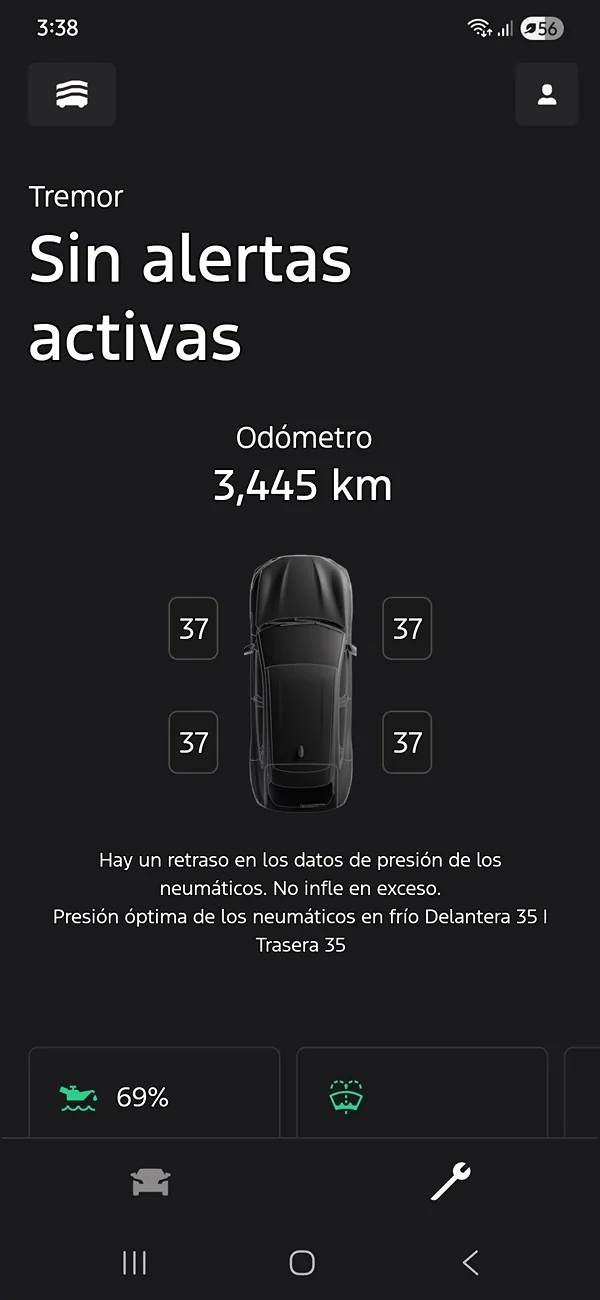

All around for better economy
235/65R17 Falken Wildpeak AT tires
Tremor 2.0l
Ford Maverick Tire pressure. Screenshot_20251111_153822_Ford
