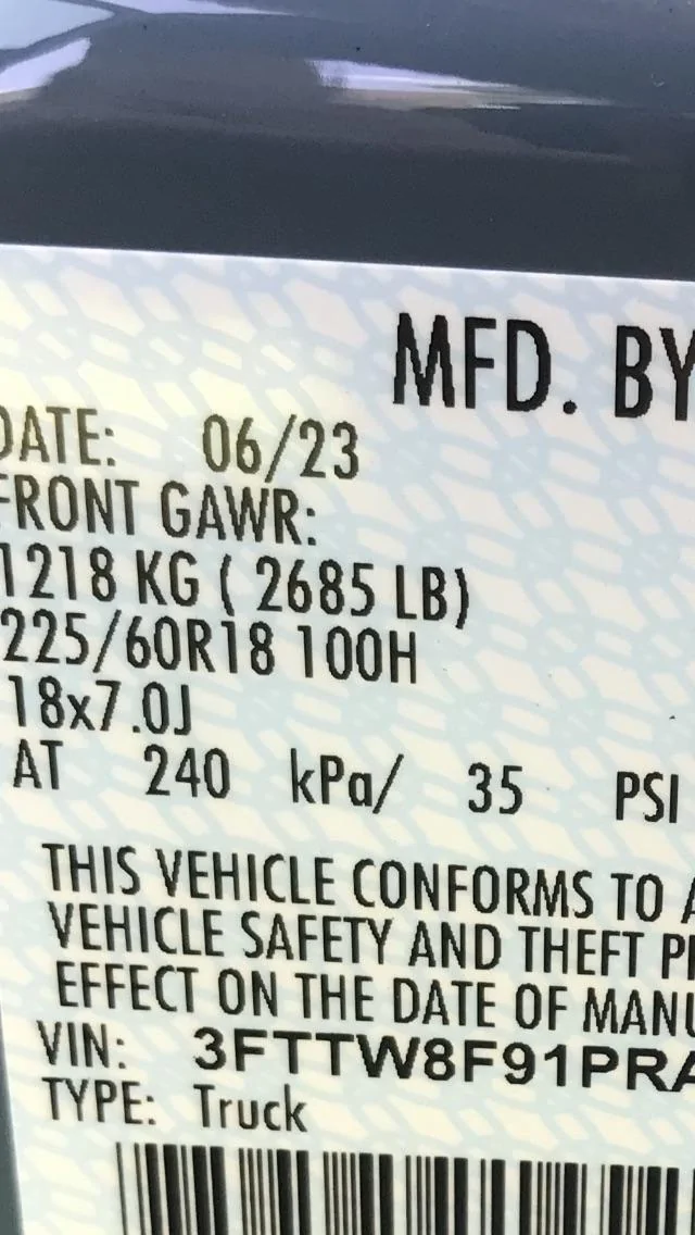

Something funny. The door sticker on my XLT Hybrid says tire pressure should be 34 psi. My tires say 44 psi. My pressure indicator on the info system confirms they are 44 psi. Obviously, 44 is correct, but why did I get a sticker with a normal car tire pressure listed? Annoying.
Check ur vin# sticker (see pic)44 is to much for a good ride dealer set mine to 45 I reset to sticker and big ride change 👍
Use door or pillar vin decal the 44 is a delivery pressure only
