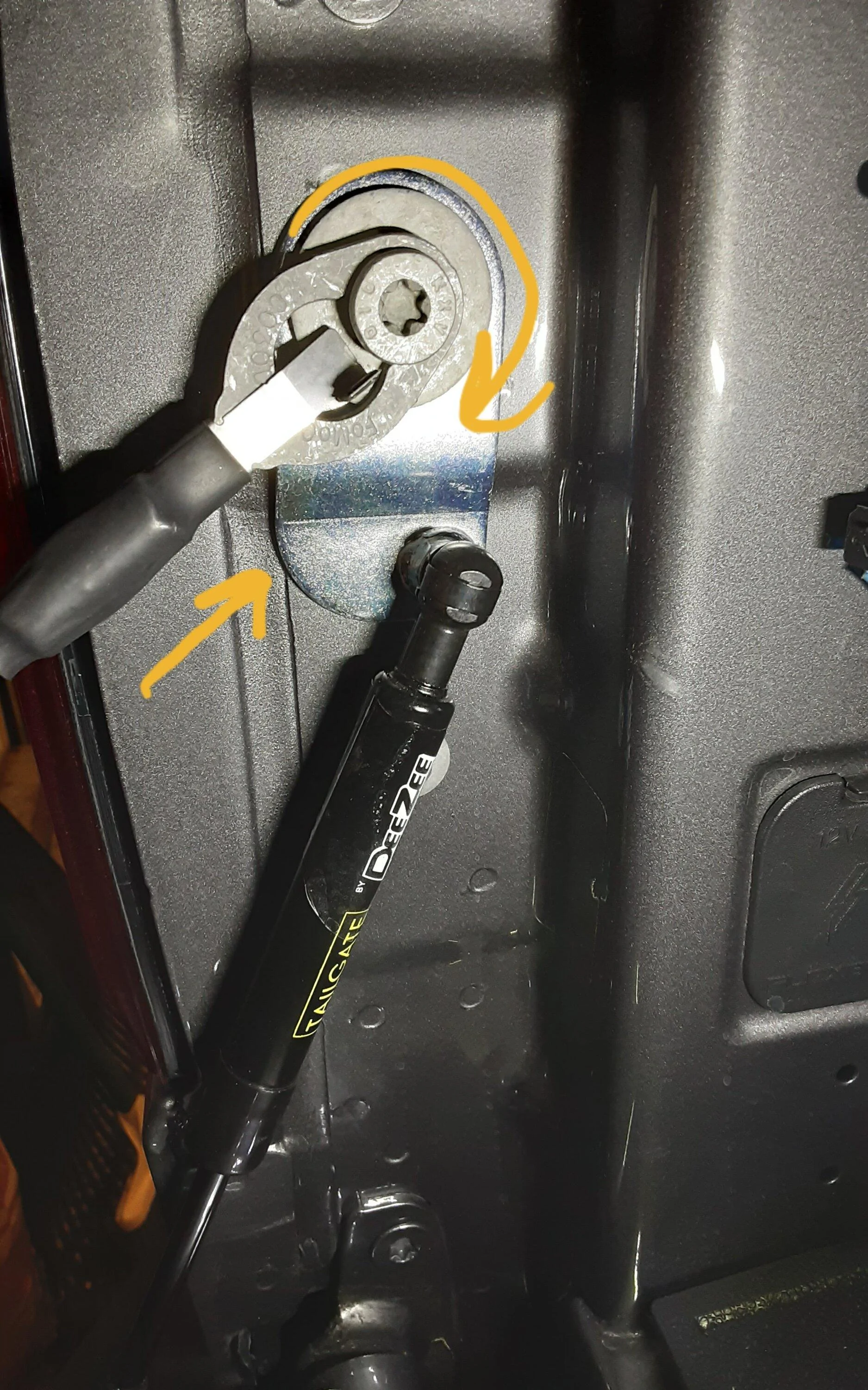

I installed the tailgate assist some time ago and just noticed today that the upper mounting plate (the one that attaches to the body of the truck) had twisted clockwise a bit - that is, the bottom of the plate swung out towards the back of the truck. The shock of the assist doing its job apparently puts enough force on the plate to turn it. The bend in the plate is supposed to fit into the bend of the sheet metal beneath it and prevent it from moving, but that is not enough in my case, even when the Torx bolt is very tight. Has anyone else experienced this and have a solution?
I wish there were a second bolt to keep the plate in place. Instead, if there's no better fix, I'll probably stick a piece of Gorilla two-sided mounting tape under the plate and see if that helps..

Yes I had that happen on mine as well. If I open the gate and immediatly let go, the small drop, before the piston engages to slow it down, rotates the bottom of the bracket out.
I just hold the gate for the first inch or two of opening and the bracket stays mostly in place.
The bottom can rotate away from bed from the force of the piston. Mine isn't too bad in this pic, but I've had it rotate pretty far out before the bend in the bracket catches. Rotates around cable support.

Id bet that if you took some clear silicone and put it on the back of the plate then tighten it down it would keep it from shifting as well as not destroying the paint.

Thanks for the alert on this — Checked out our tailgate assist and the same thing has happened. Might try the suggestion to dab a little dab or two of silicone back there, or maybe some felt padding. Something to keep it from shifting…

My cylinder is attached to the tailgate. That is weird, because I remember a thread like you're referring to and was sure I had followed the instructions properly, but nope!
Yep, that’s my problem. Thanks for posting the photos.
It sure would be nice if the tailgate had a gradual drop from the beginning instead of after falling a couple-few inches, but I suppose there are mechanical limitations to that.

Perhaps a locking star washer under the mounting plate instead of a flat washer would help.​
