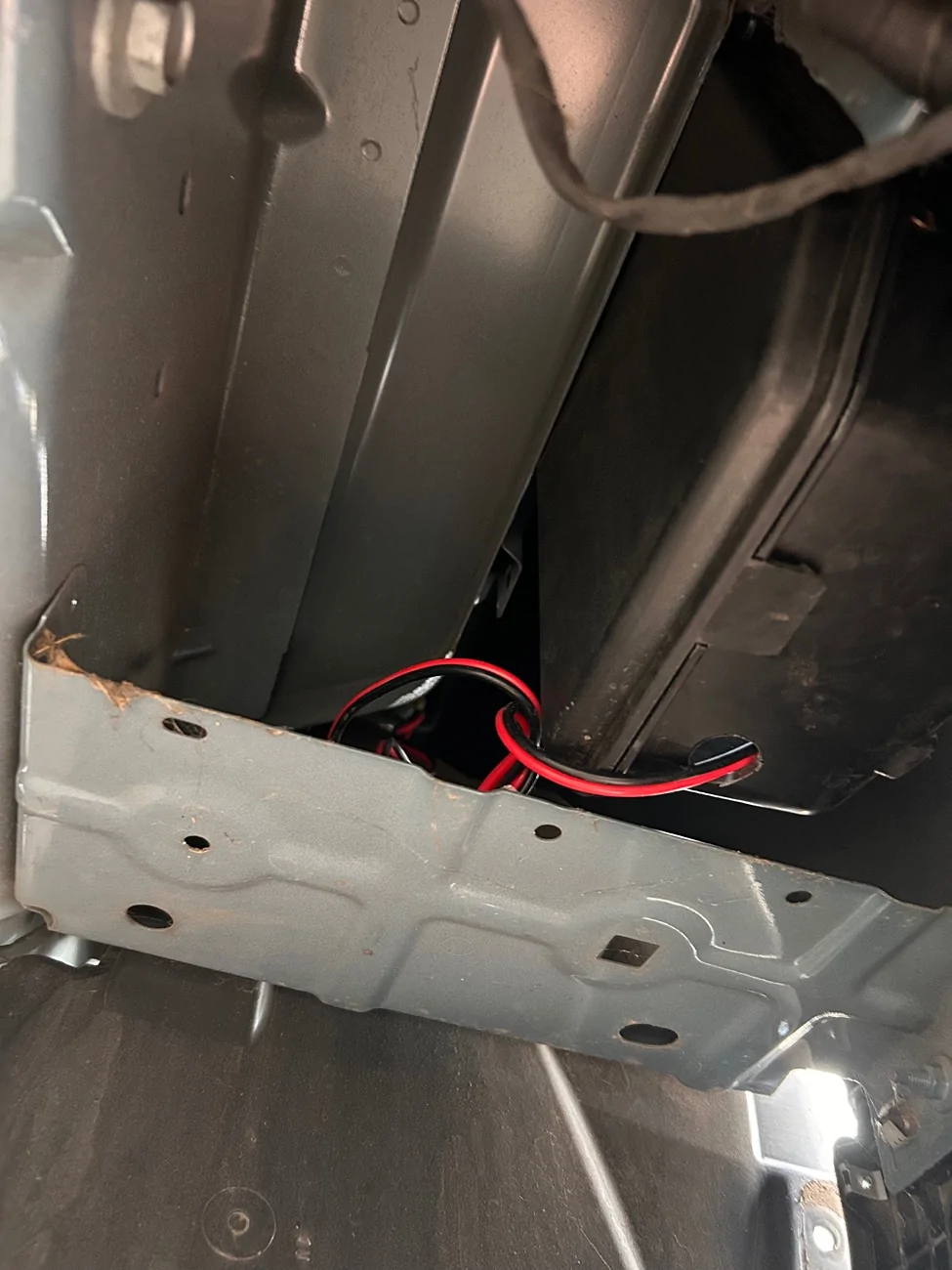

I am contemplating adding a 1 gallon tank underneath the cubby inside the rear fender. This is looking up at the bottom of the cubby with a plastic panel removed under the truck. That sheet metal would be a perfect spot to mount a reservoir, strong enough to hold it also hidden and out of the way.
what would you put in there?

I would say both for that reason and to protect the wires.
Butyl tape / gum will work as a quick DIY. Mounting holes will leak too. Not sure how you fused it...grab some tesa 51026 / 51036 to protect the wires from the sharp edges.

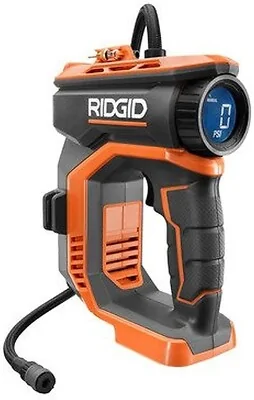

I keep a rigid battery inflator under my back seat ,works great!!
That looks perfect. The only reason why I went with one I have is that I needed 120 max PSI support at the time. I don't need it now and probably would get something smaller but I already have this one..haha.
