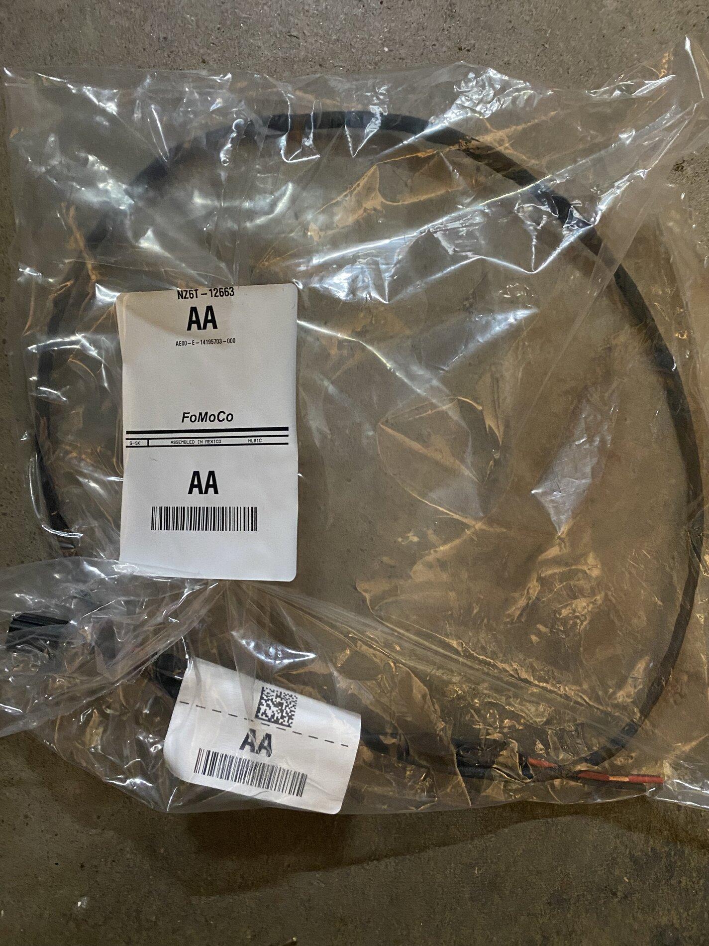

Picked up my truck today and it came with only one wire. There are two spots to connect it. Here is a pic of it with the part number
The 2 mating connectors come stored in the glove box.I remember seeing or reading that two connectors come with the vehicle.
I would hope Ford supplies 2 connectors but this thread also says they only got 1 with their new truck. What's the random wire under the rear seats for? | MaverickTruckClub.com - 2022+ Ford Maverick Pickup Forum, News, InfoThe 2 mating connectors come stored in the glove box.
