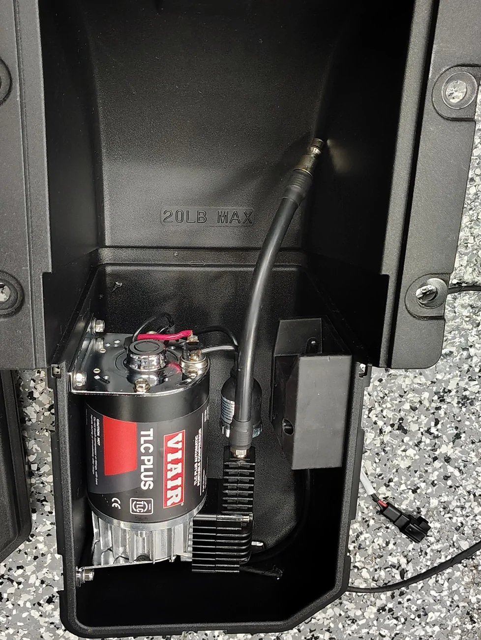

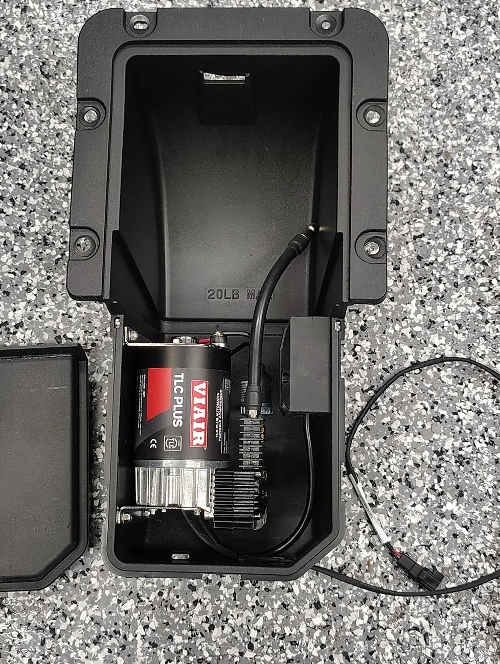

I implemented something similar with a few tweaks:
  • To use the 20A Flex bed power connector, I lowered the Viair start/stop pressure switch to 85/105 psi. This keeps the compressor draw under 18A, allowing it to run safely off the Flex Bed 12V tap.
  • I revised the wiring to include a more robust 30A weatherproof switch. I didn’t trust the compressor’s factory power switch to avoid accidental activation.
I wrapped the harness with cloth wire harness tape and it looks factory! and the kids can't run of with it (or steal it)!
Ford Maverick Stealth onboard air compressor install in bed. IMG_20260411_211816729_HDR
Ford Maverick Stealth onboard air compressor install in bed. IMG_20260411_211812538_HDR

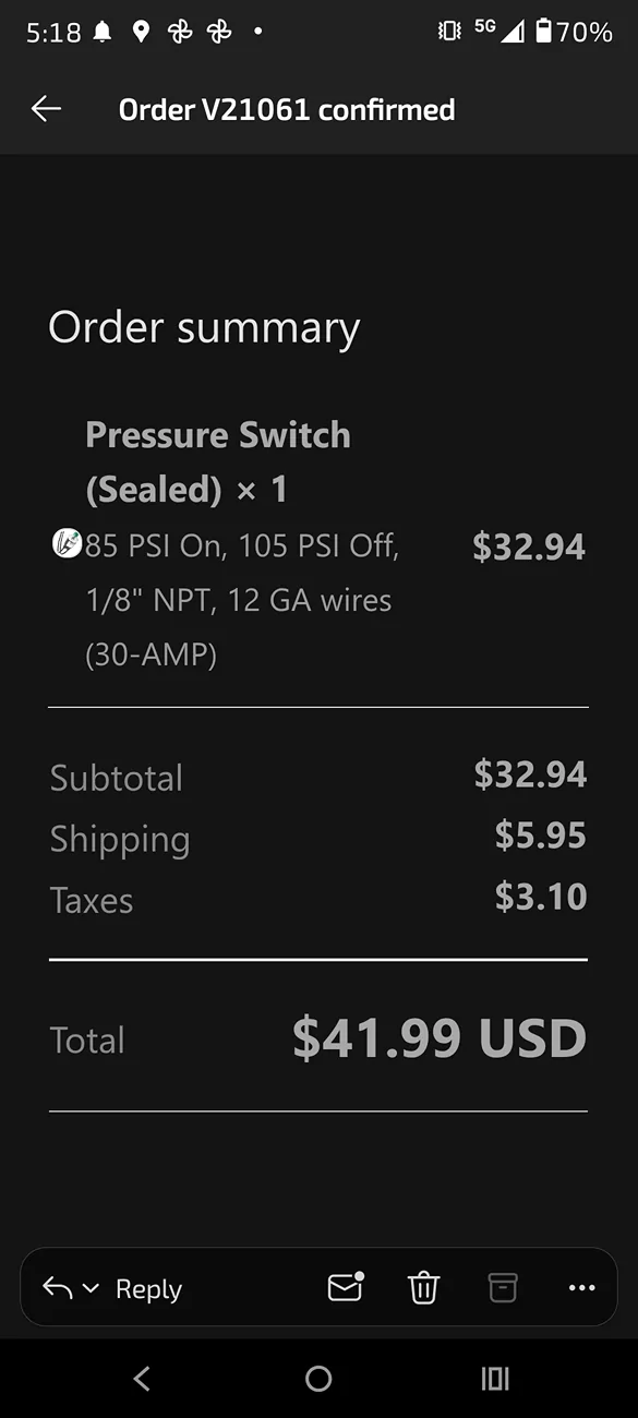

Oh sick! I’m going to update the front post with the 85psi trick to use the flex bed! I didn’t even think of that!
I bought a water proof 30amp switch too but got lazy and didn’t install 😂
I forgot to post the details on what VIAIR switch I ordered to do the modification:
Viair Sealed Pressure Switch - 85 PSI On/105 PSI Off, 1/8in. Port, 12 GA Wires, Model# 90212
Ford Maverick Stealth onboard air compressor install in bed. Screenshot_20260806-171802.Outlook
