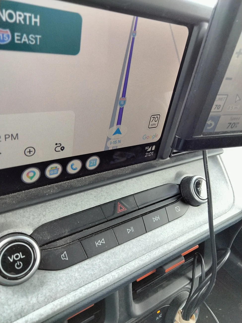

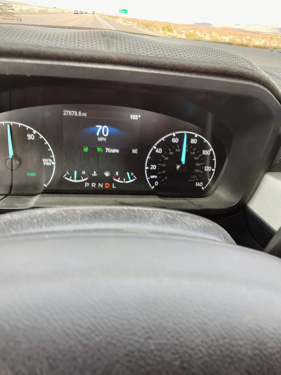

I guess I'm lucky. With almost 28,000 miles on my original stock tires my speedometer is exactly correct.
Edited
If I had thought about it ahead of time. I would have brought my other two handheld GPS units.
Ford Maverick Speedo reading 2 mph higher than GPS IMG20260721140129
Ford Maverick Speedo reading 2 mph higher than GPS IMG20260721140124
