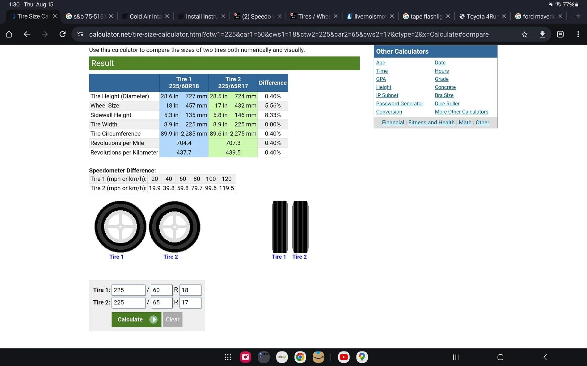

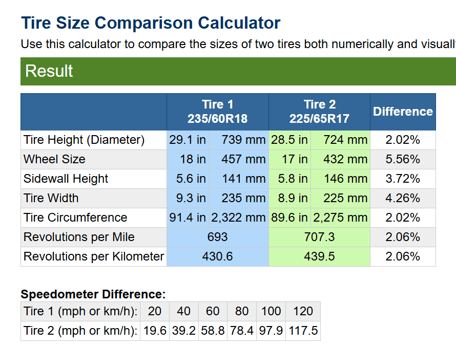

New to me 22 XLT is also showing 2-3 mph slower than GPS on Waze, Google Maps and two different GPS speedo apps I installed. Not the end of the world but weird.
I do need to check the tires, not sure if they are stock, close but not sure.
