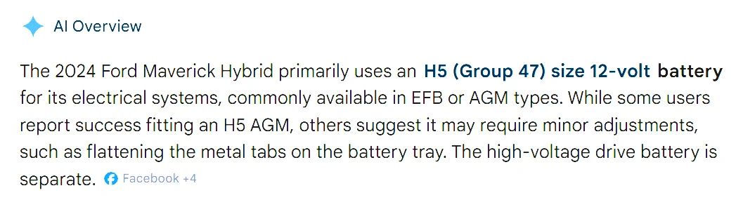

Reading this again, it both says H5 is correct AND says that H5 requires adjustments. Thanks, Robot Overlord. I don't know if I want to modify the battery tray to fit an H5, so I'll get an H4. I don't need higher capacity (amp hours).
asking what size battery, several sales sites like Autoparts stores and other retailers said H5.
And I got this reply from the Robotic Overlords:

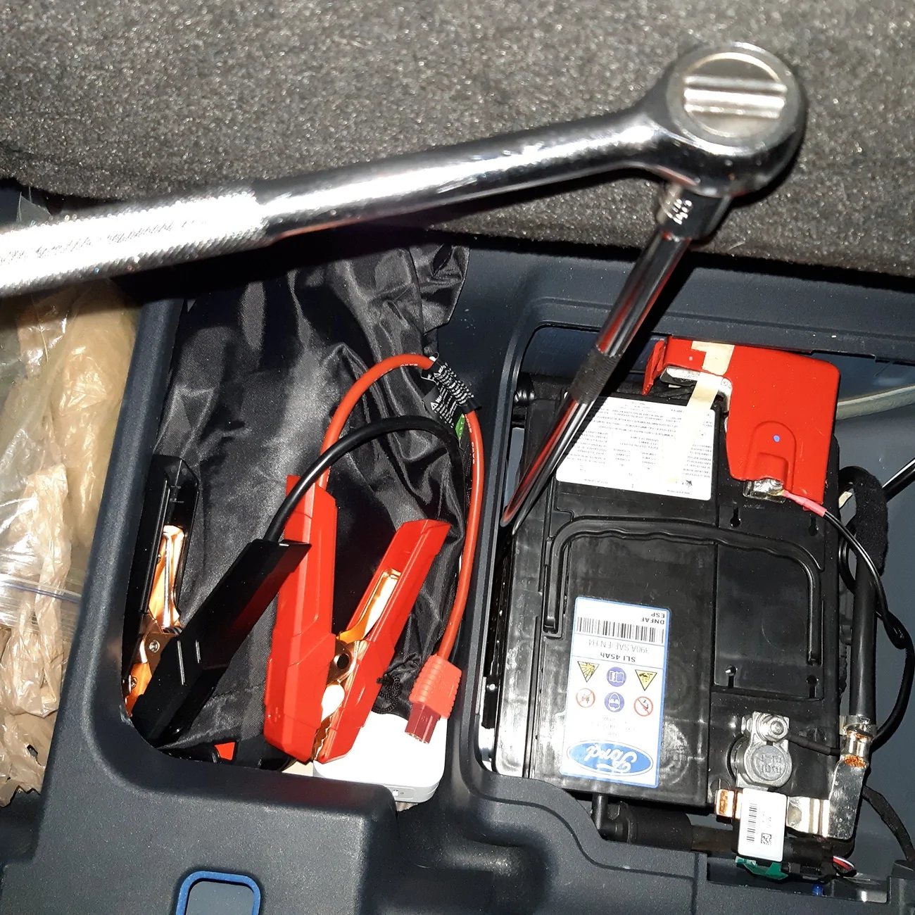

The correct size is H4 unless you want to do modifications including, bending some metal and removing the plastic surround allowing you to install the larger H5 battery.
If you are planning on installing the battery yourself you may want to plan on getting one of these a magnetic socket from Amazon.
Amazon magnetic socket link
Ford Maverick So, NO START this morning. What is it? 20260328_085040
Give me a moment please..... this is going to be a long and involved post

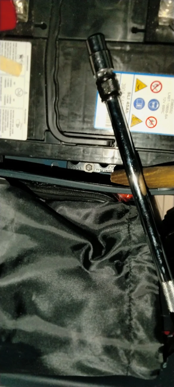

Removing the battery clamp nut isn't the problem, but reinstalling it is.
As you can plainly see.
Even with the proper size H4 battery it's a tight fit.

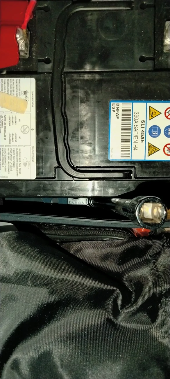

Ford Maverick So, NO START this morning. What is it? 20260215_110428
When I eventually end up replacing my battery.
I don't know if I will remove the plastic surround or order a 10 mm magnetic socket. I would think it's harder to get the battery hold down clamp in the proper position with the plastic surround in place.

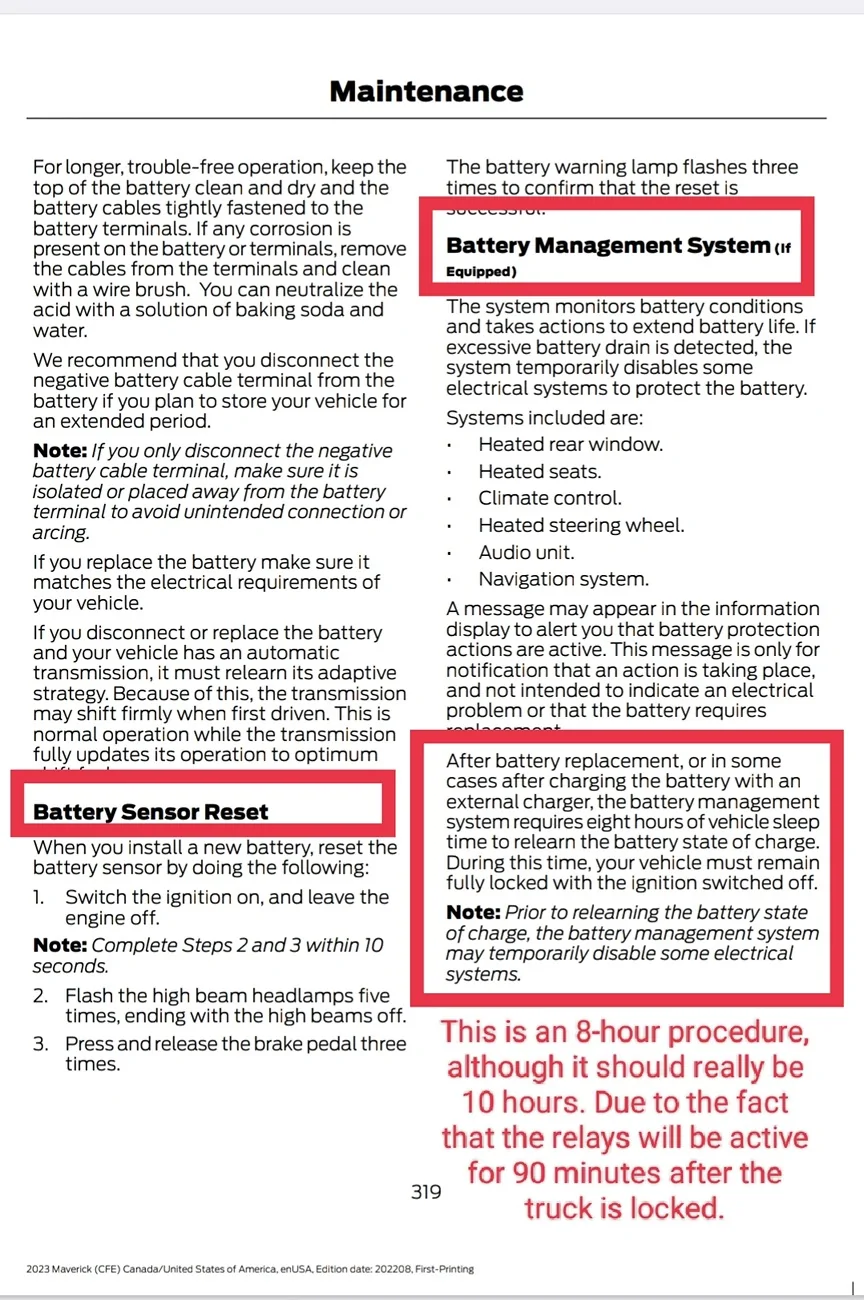

Then there is the process of making sure the new battery is charged 100% before doing the BMS relearn. This is something most places that install your battery probably will not do.
From the manual.
The correct size is H4.
I don't know if I will remove the plastic surround or order a 10 mm magnetic socket. I would think it's harder to get the battery hold down clamp in the proper position with the plastic surround.
From the manual.

In mine I left the battery OUT of the truck for 12 hours. Put it in.
Did nothing else. And it relearned everything instantly.
The 12 hours without power seemed to do the same reset. At a minimum made it forget what it previously knew.
