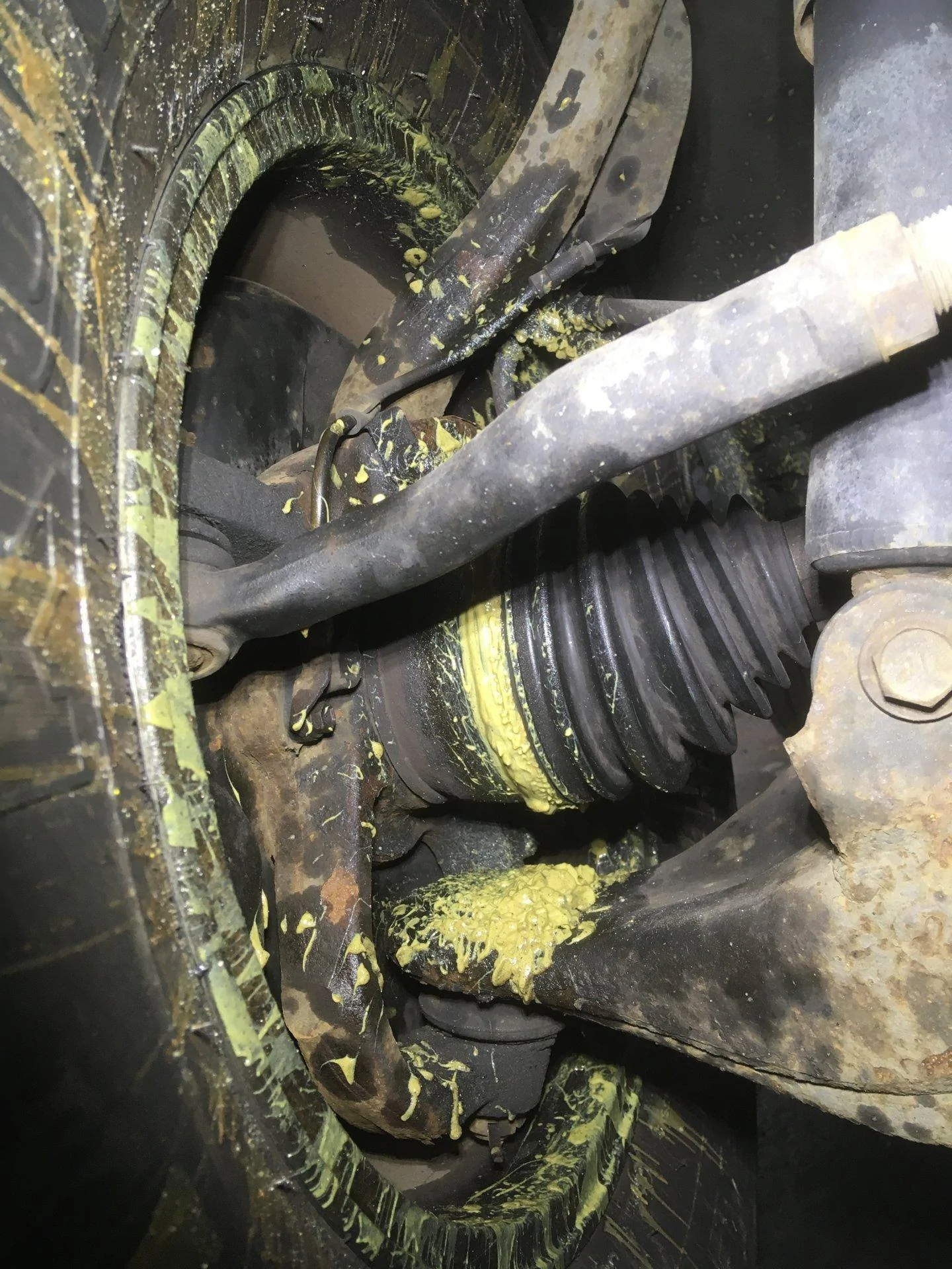

Maverick Tremor Lariat
Just picked my Maverick up from getting detailed, ceramic coated and paint protection film.
They said they found this when they pulled the wheels. What is this?
Ford Maverick What is this? Yellow Grease IMG_4498
JBryant
Jesse
Nov 7, 2022
1,629
2,710
Bowie, TX
2023 Maverick Lariat Hybrid Alto Blue
If not, then some of the schoolbus color got put in there by mistake.

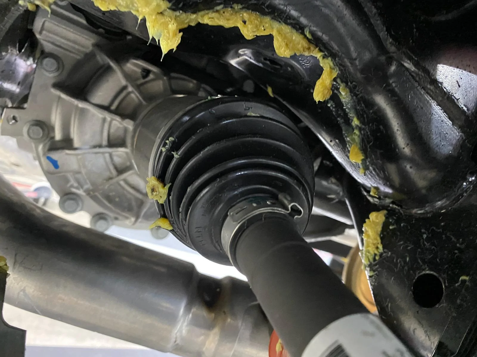

Looks familiar.....CV Boot tear for sure. Back to the dealership!

Sykokilla
Sykokilla
Adam
Apr 13, 2023
Ugh, yeah called dealership and they got the part ordered. My lil 1000mi surprise I guess.
Thanks guys

I just had the same part replaced on my Escape under warranty, the boot had a tear. I just figured they would put on a new boot but they replaced the whole axle. Apparently labor wise it is easier to put a new $149 axle on rather than have them work on breaking down the old axle.

Might be the cv boot clamp was improperly installed.
