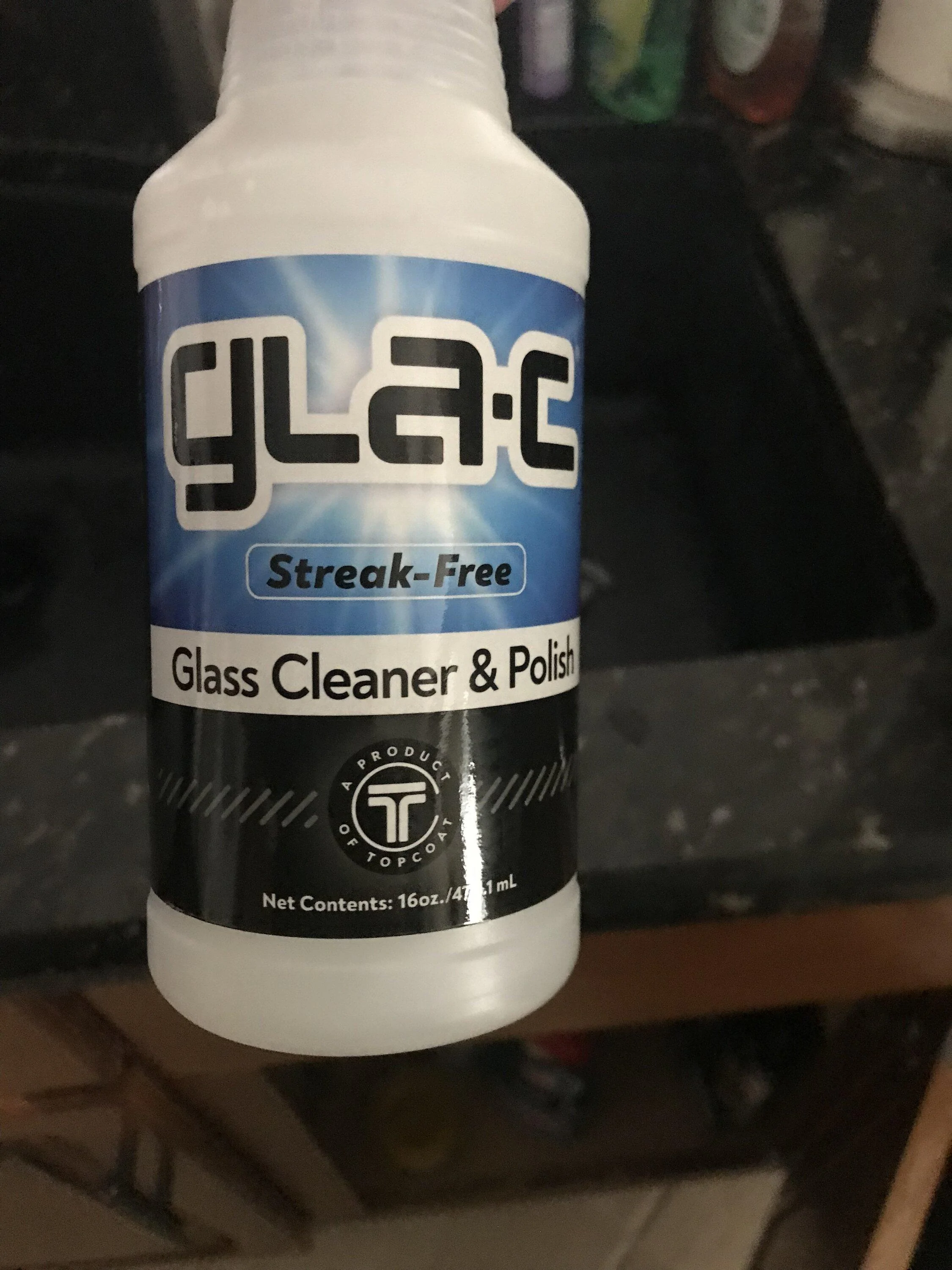

I have been dealing with the skipping/jerking wiper issue now since I bought my truck. I am starting to see it cropping up on many other people’s trucks too and hoping we could discuss what could be causing it.
What I'm referring to is only when the wipers are on intermittent mode, when they reach the end of the cycle to rest at the bottom of the windshield, they seem to skip/jerk ahead to a further stop rather than resting at the original point. When the windshield is dry it doesn’t do it and when using the regular low/high or washer modes they work perfect as well. I have checked and my wipers are aligned to the marks on the windshield, and I have even gone through a couple sets of blades and cleaned the windshield.
I have had it to 2 different dealers who could not replicate the issue. So based on feedback from other owners, I went ahead and just replaced the wiper motor myself. It’s an easy job and I had Ford points which made the part cheap enough to be worth the gamble.
The wipers are doing EXACTLY the same thing as before. I’m completely stumped now and all I can think of is this is either an inherent design flaw or maybe it’s the wiper linkage that’s to blame? I have no idea and this issue drives me absolutely crazy. Would love some input from other owners on this!
Added some videos as well to explain (note not all videos are mine).
I use glas c (see pic) with blue fine clay bar cleans window fallout off. Then reclean with glas c glass cleaner until window is spotless.mine work great no skipping
Ford Maverick Skipping/Jerking Wiper Issue Saga Continues - New Motor Did Not Fix 6AEC7B5D-C327-4040-BF57-B6F52E844606
