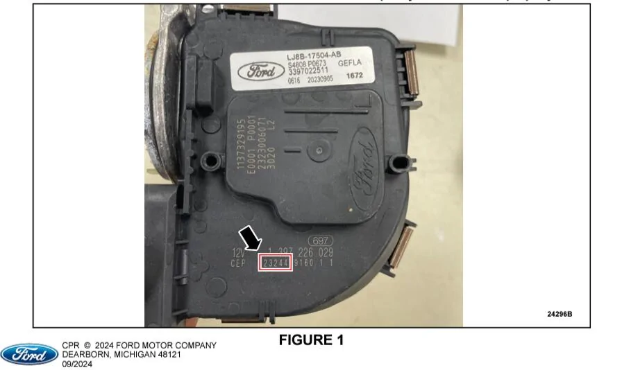

The most recent dealer communication has the affected batch dates they're looking to replace
2. Inspect the back side of the wiper motor for one of these two Julian date codes (23169 or 23244). Are the first five (5) digits in the Julian date code 23169 or 23244? See Figure 1.
