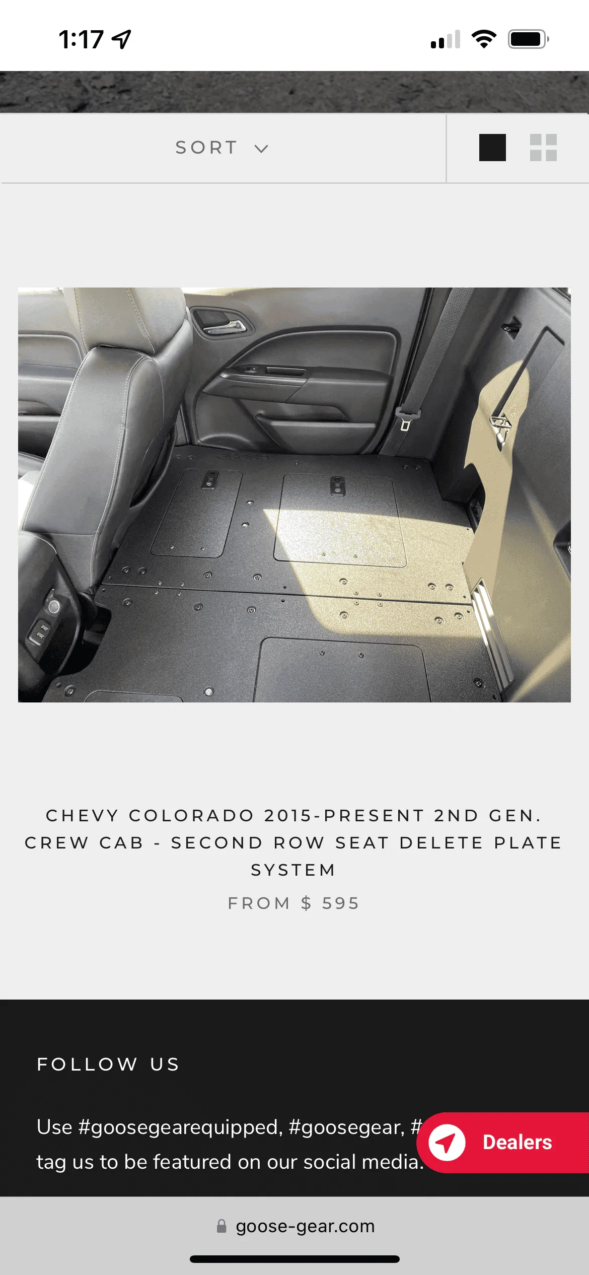

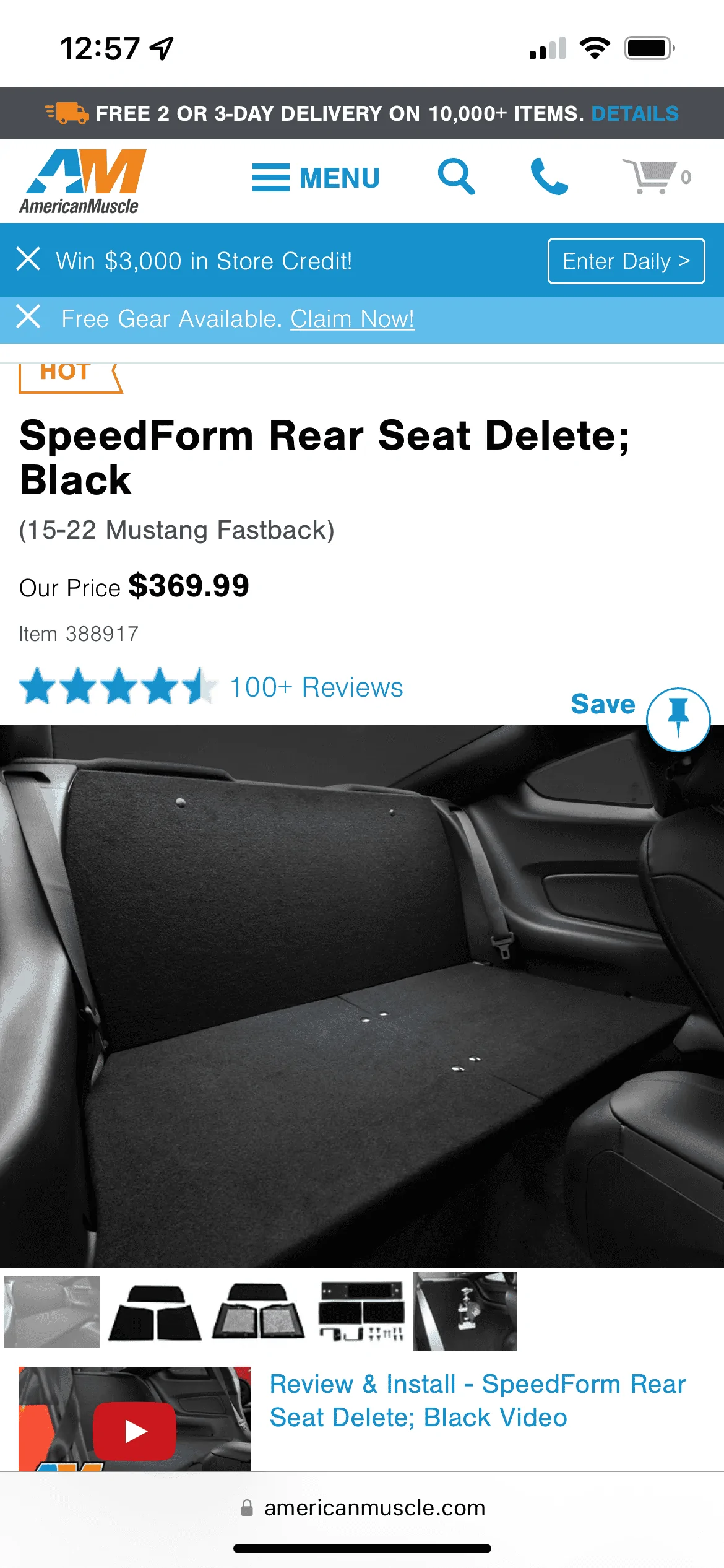

I think that sounds easier than it is. If you delete the rear seat now it's only an occupancy 2 vehicle. No seatbelts, any associated SRS, seat occupancy detection, etc. And even if you reinstall/reprogram all that you need to modify the title/registration.
On the production side that also means new molds for the upper and lower C-pillar to remove the seatbelt openings. Plus a new backpanel for appearance and noise; the pressure vent hidden behind the seat lets a lot of road sound in if you have the seat down.
After I posted I realized that the solution lies in the aftermarket. These are for a 2022 mustang and a Chevy Colorado.
