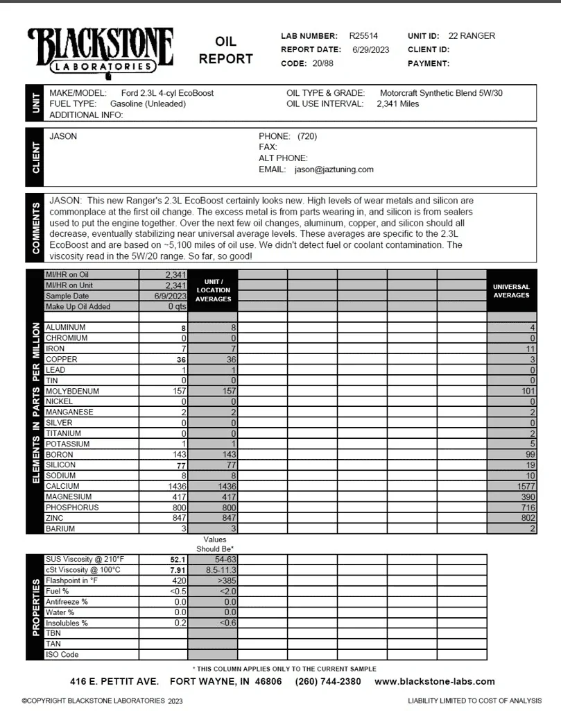

Here is my Ranger at 2,300 miles. I'll be changing the Maverick's initial oil at 2,000 miles. I will send off for sampling. I wanted to get the break-in wear metals out and see the condition of the oil. It thinned out enough for me to know I probably won't run this oil. I did replace with OEM oil and will drain/sample at the same mileage interval and likely go to a ester based oil and change every 5k miles.
Ford Maverick Short Oil Life 1694298096923
I've built enough motors... I ALWAYS expect glitter on a new engine. If you're really arguing this, you're probably not a car-guy, which is fine. But some of us know better.
