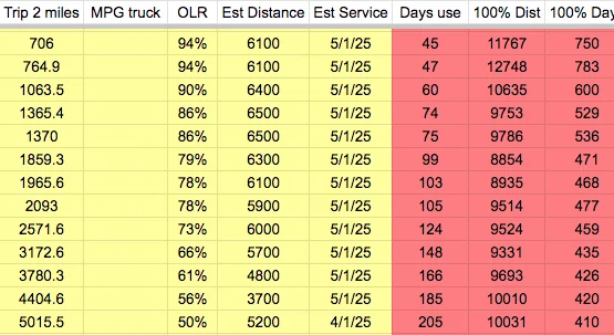

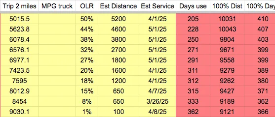

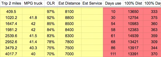

So the EB is doing the same as the hybrid now - at least the Fordpass app is showing the same thing.
1K distance remaining for every 10% OLM.
So around 8600 total.
I'll bet that estimated remaining distance changes at some point - curious if at 50%.
Was there an app update in May - that's when mine changed to 1k/10%. 1st year of usage, not.
But if it was only mileage based algorithm - then about 2000 miles for 34% of used oil life - means 100% would be 5882 miles to reach 0.
If only time based - you said 3 months or 120 days for 34% used - means 100% would be 353 days to reach 0.
So is your annual mileage more on track for almost 6K miles, or 8600 miles?
Gentle miles, no tow/hauling, extended idling, ect?
No winter yet either, that could change things.
