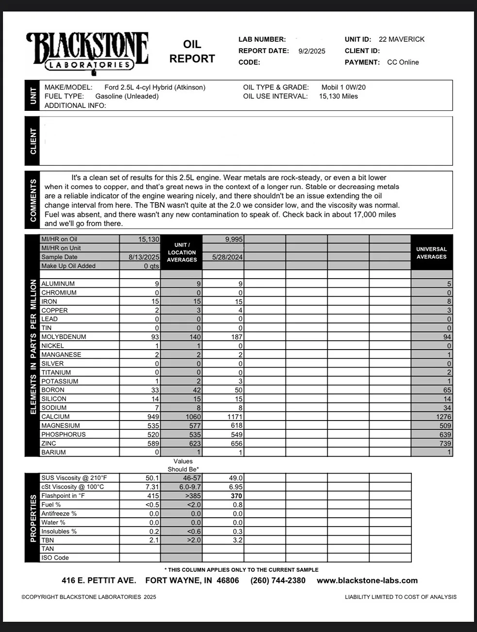

The oil life meter is WAY MORE accurate than the human guess-o-meter behind the wheel.
Want some proof?
First one was 75% city / 25% highway.
Second one was 50/50.
I comfortably take the Oil Life down to 1%
One not tested was 80% towing (coast to coast vacation) and oil life hit 1% at 6,000 miles. So I changed it at 6,000 miles.
15,130 miles and Oil life at 1%.
Zero added oil in about a year.
Used reports at 10,000 (more city) and 15,000 (more highway) are nearly identical.
Nice report, pretty tough to argue against an actual analysis.
I plan do an analysis of SuperTech 0w20 /w a Motorcraft 910S filter vs. Penzoil Platinum with a Premium Guard XL filter, both at 7,500 miles and adjust accordingly, for my own peace of mind over the long haul of owning this vehicle. Only thing that raised my eyebrows with the OLM over the first 10K miles was that it made no modifications through the winter where I made tons of short trips with the engine not reaching full operating temp, but I guess the analysis will show whether that really matters or not for contamination and viscosity breakdown.
Have to remind myself sometimes going down the oil rabbit hole that the sludge factory horror stories are almost always defective owners who use the CEL as the problem monitor, then scream about the consequences.

That is a bit concerning. It should have reflected the operating temps and declinated the indicator quicker. Do you live in a cold climate?

We have 4 seasons in Nebraska, at least for now, usually only ~6 weeks of winter /w temps regularly below 20F.

Ah yes, Nebraska... I am getting chills thinking about it! LOL For a short while I lived up near Omaha. Can't say I am a fan of NE weather! I would have certainly thought the OLM would have been clicking off the percentage for sure.
