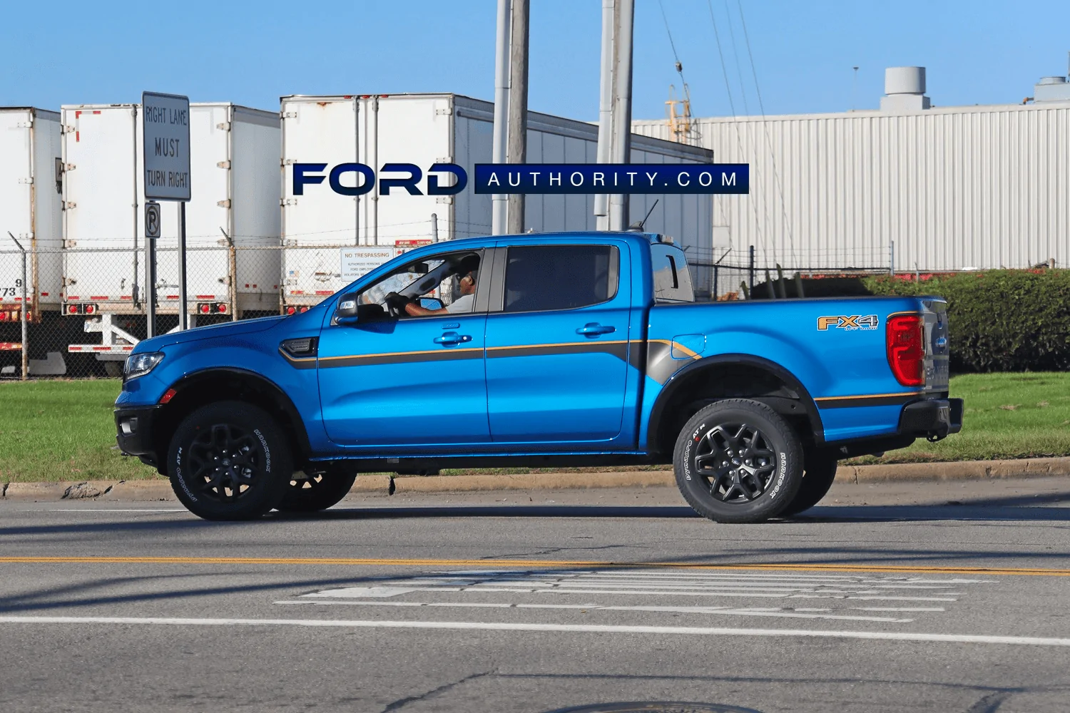

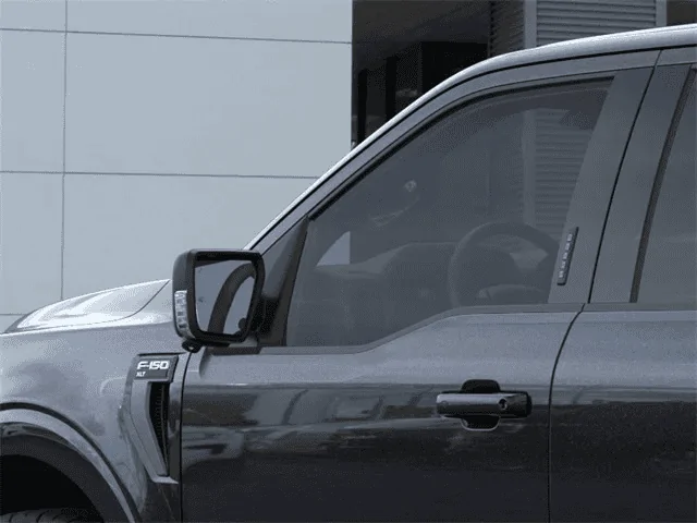

It's a truck. Ford's trucks still get SecuriCode keypads with physical buttons because truck. All others (best I can tell) get the capacitive ones hidden behind the glossy B-pillar on the driver door.
F-150
Ford Maverick SecuriCode Keyless-Entry Keypad is available again for Maverick 1689891441263
Ranger:
Ford Maverick SecuriCode Keyless-Entry Keypad is available again for Maverick 1689891548111

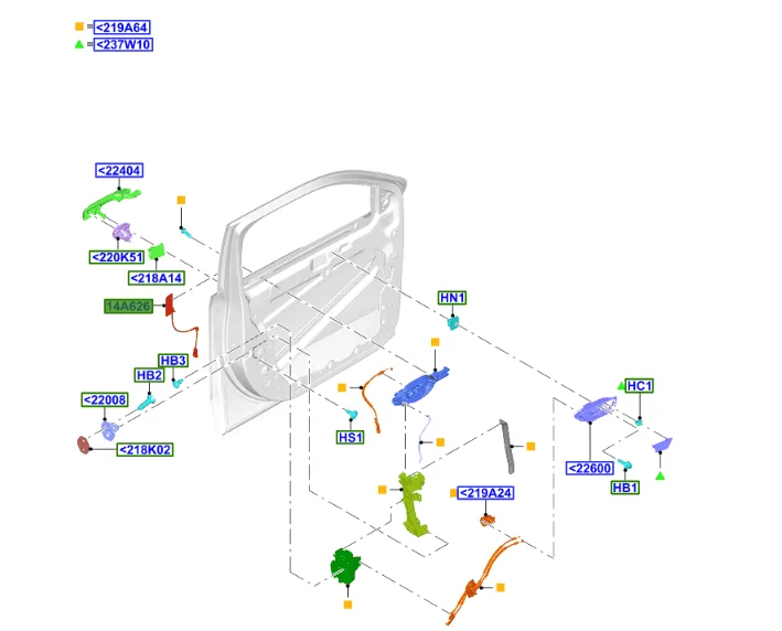

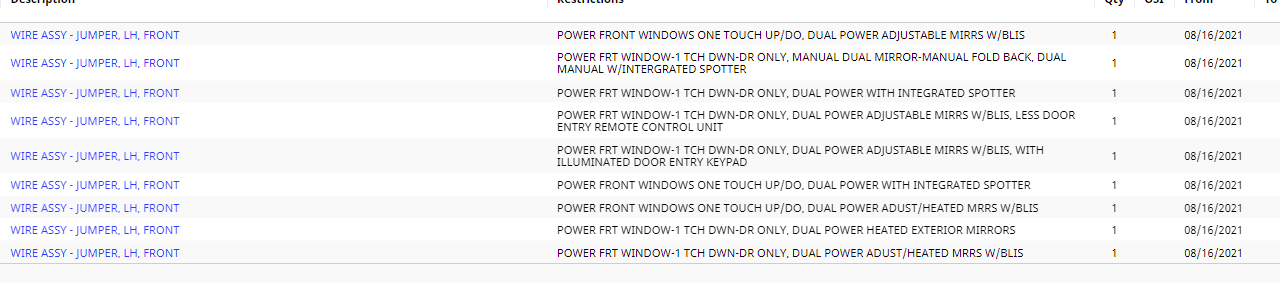

I hate to burst the bubble, but it will NOT be the 12v vehicle powered pad, The wiring will not be there, Ford has 9 different options for Drivers Door wire harness.
Ford Maverick SecuriCode Keyless-Entry Keypad is available again for Maverick 1689892060891
And who knows what dash harness you would need to mate to make it work. And it is wired in the door and The actual Door is different between the two options.
Ford Maverick SecuriCode Keyless-Entry Keypad is available again for Maverick 1689892189117
Ford Maverick SecuriCode Keyless-Entry Keypad is available again for Maverick 1689892477322
If Ford was still building them like in the 90s and earlier when there was just one wire harness and you could plug and play, it would be doable. But with all the different configurations, it is impactable to hard wire it in.
Not sure how that translates to 2024. For 2022-23, XLT and Lariat get SecuriCode standard, so those variants of the harness listed have the wiring for it. Have they changed the harnesses to drop the keypad wiring?
Only XL didn't get it, which is why there's the version for BLIS without keypad. The only options that XL got that should affect it are with/without CP360/BLIS, no keypad, no heated mirrors, etc.
Ford Maverick SecuriCode Keyless-Entry Keypad is available again for Maverick 1689892905008
This one sounds like XL without CP360 package except it's listed as having the spotter mirror that XL doesn't have.
Ford Maverick SecuriCode Keyless-Entry Keypad is available again for Maverick 1689893148573
