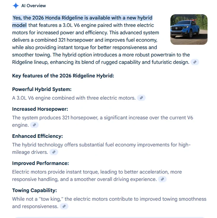

Not completely unusual with vehicle manufacturers to offer different equipment options later in production schedules, mid-year updates, etc. Ford has done this many times, with different changes in like "job 2" "job 3" builds. You can see that in this forum on the maverick over the years.
Is it a certainty - No, never said it was Could it happen - Yes Like I've said all along, a rumor that the OP might want to inquire about.
Type in a search to the "Google AI" that's touted so highly, you'll see numerous results
search: does the 2026 honda ridgeline have available a hybrid model
OK please don't take this the wrong way but you need to tune up your BS filter.
If you click on the links that Google provides at the bottom of each paragraph, you'll see that the ONLY source for that info is a YouTube channel called "Tech Triumph" which is one of those bullshit sources that use AI to generate fake news in order to harvest clicks. IT'S TOTAL BS
Do you realize how garbage AI is at providing reliable info? It just harvests info from any source and makes it look like facts. I could start a thread here saying the Job2 2026 Mavericks will be available with a GE J79 turbojet engine; pretty soon an AI bot scrapes that info from the site and then starts feeding it back as "rumours"
