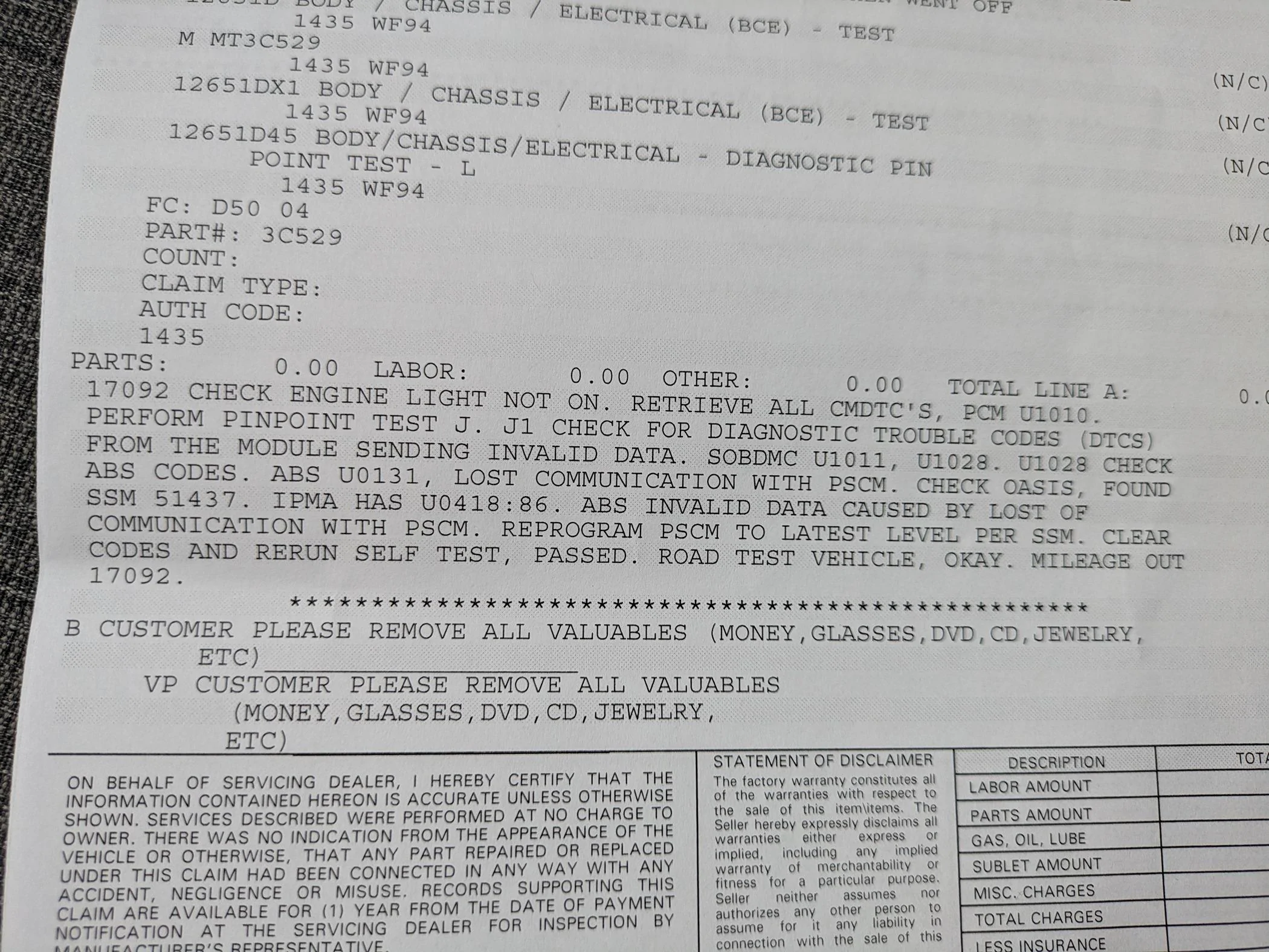

I didn't read through this entire thread, but I did the blinker and PCM recalls on my hybrid a few weeks ago then the other weekend I lost power and had the straight flush of warning lights and error codes while driving on the freeway. Lost power, got off on an exit and into a parking lot in limp mode. Anyway the truck ran okay after I powered off for about ten minutes and then two days after the solid check engine (it was blinking while in limp mode immediately after the power loss) light went away. Finally got my service appointment done today and, in case it helps anyone, this is what the paper said:
Power steering module, wow.
Just more evidence supporting my theory that they changed something in the canbus.
For sure something fishy is going on with our trucks.
