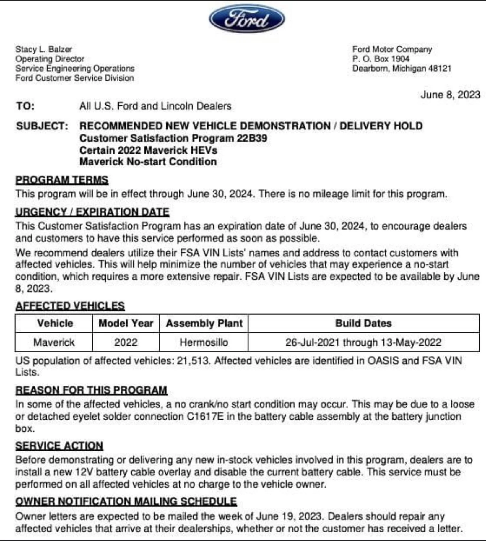

Might this be related to the just mailed Customer Satisfaction Program 22B39 12 volt battery cable overlay, i..e., the bad connection 'twixt the low voltage and high voltage cable?
jsus
Dec 20, 2021
2,887
3,895
2022 Ford Escape Hybrid AWD
Entirely possible at least in some instances but it's not the only potential cause.
See the thread on 22B39 and anyone with a Maverick hybrid built through May 13, 2022 should strongly consider making an appointment with a dealer to get this addressed if you haven't already had the 12V harness replaced.
https://www.mavericktruckclub.com/f...mer-satisfaction-program-delivery-hold.32720/
Just saw this posted by Tommy on another site. I searched here and haven’t seen it posted yet.
