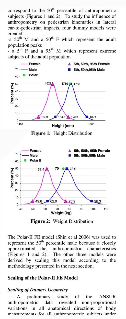

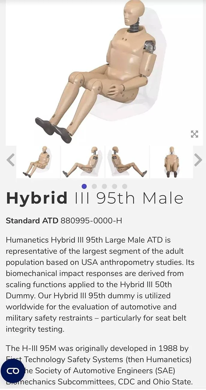

Here’s the thing, the NHTSA doesn’t just use the weight of the average American and pretend like they are a round blob. They need crash test dummies that are shaped like humans, sized like humans and have masses like humans and weight distributions like humans, including muscle mass differences between men and women. So the crash test dummy makers need to have all of the anthropometric data: height, weight, inseam, femur length, tibia length, chest circumference, shoulder width, etc, etc.. And that data is hard to come by. The best data set is from the Anthropmetic survey of US Army personnel (ANSUR). The most recent ANSUR data set is from 2012. It gives a very good snapshot of the height and weight distribution curve of healthy and relatively fit American adult males and females. Companies that make crash test dummies, like Humanetics, use the available anthropometric data sets to make the most realistic dummies as possible, but this data excludes the morbidly obese, as they are not eligible to be military personnel.

In the end, they crash test with the 5th percentile female and the 95th percentile male to make sure they pass the minimum crash safety standards, but they don’t release that data to the public. The data they do release is with the 50th percentile male. He is also what the crash worthiness ratings are based off of. Why the 50th percentile male? Because the 50th percentile male will receive less injuries than the 5th percentile female and the 95th percentile tile male. Also because males drive more miles than females and they get in crashes at a higher rate than females because of speeding, aggressive driving, and alcohol consumption.
