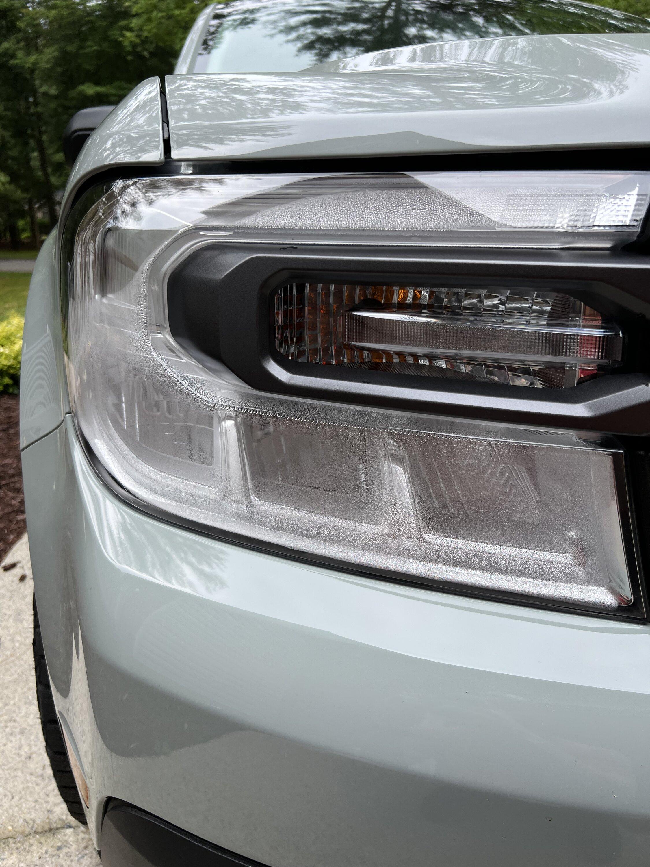

Have a friend with a Maverick and he has moisture in a taillight. I go out today and I have a very cloudy headlight. Anyone else experience this?

Based on that pic, it looks to be warrantable to me. The criteria for "excessive moisture" in the exterior lighting is:
More than 50% condensation coverage, large water droplets, drips/streaks, puddled water (without damage/modification).

I recently drove my old car through the auto wash (to prep for sale) and it got water in 1 side. They are 3-4 year old aftermarket headlamps. Dried in a week. I could have dried it in a day by removing the bulb and leaving it in the sun. No more "auto" high pressure washes for me.
Either way, get it warrantied soonest. Shouldn't happen in the first 1-2 years, IMO. Car washes are just something to be aware of.
