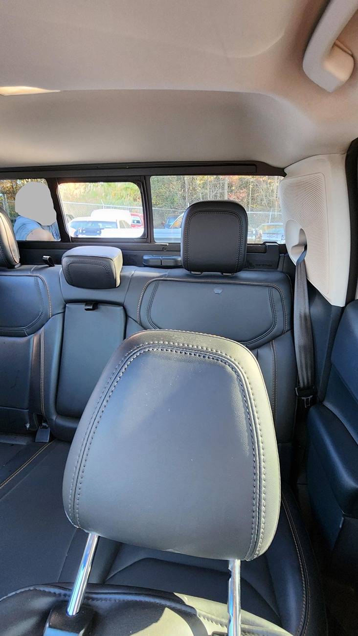

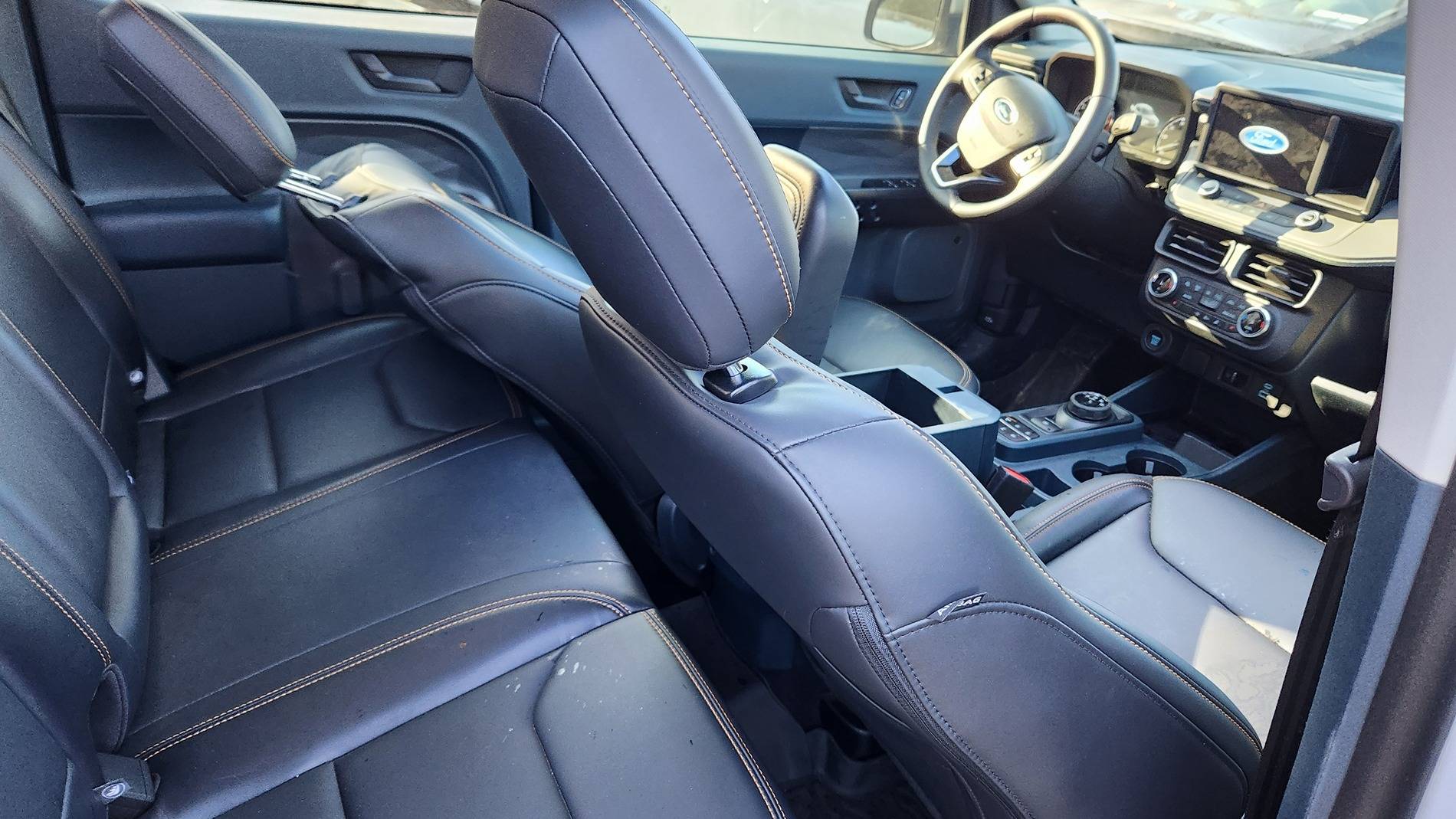

Phimosis definitely knows more about injuries and law than he does turbocharged engines. :wink: Seriously, that is very helpful commentary and insights.
I doubt the crash test dummies go as high as the OP's body weight (325 I believe he said?) so accidents he is involved in will be outside the bounds of testing for sure, and maybe outside design.
It looks like the seats functioned as designed. There most definitely are incidents of infants being crushed behind a front seat adult whose seat goes rearward in a high-energy collision. But that doesn't mean the alternatives are any better. Vehicles are far safer now than they ever have been, and while we don't like to see Mavericks totaled from (what seems to be) minor rear-end accidents, the rear crumple zones definitely make a huge difference in accidents of this kind of violence.
Unless the OP is competing in world's strongest man or playing the line in the NFL, the best thing he can do for his family isn't buying another vehicle.
Also, I don't see the injury lawyer serving much purpose assuming he and his wife are not seriously injured. You don't get compensation for 'almost' having a life-changing injury. Truck is surely totaled, get a larger one if it makes you feel (or actually be) safer.
I didn’t see where the OP stated he weighs 325 lbs. If that is accurate, then it explains why the seat extended beyond the 35 degrees of rotation safety limit. To me it looks like 40 degrees of rotation (keep in mind that no one sits at 0 degrees of rotation normally, but the seat starts at 15 or so degrees reclined.
The NHTSA uses 6 pediatric dummies and 4 adult dummies. I’ll focus on the adult ones only. First, the smallest one, “small adult female” is 4’11” and 97 lbs. This is the one that is most likely to get injured. The air bags are too powerful for her small size and the seat backs are too stiff for her low weight, so she is more likely to get a spine injury. Then there is the “5th percentile adult female”, which is 4’11” and 108 lbs. Standards get built off of this one, as safety devices are designed for people in the middle, from the 5th percentile to 95th percentile. Then there is the old generation “50th percentile male” that is 5’9” and 160 lbs. And as American’s weight has increased over the years, the new generation 50th percentile male is 5’9” and 171 lbs.
A 325 lb driver weighs 1.9 times as much as the largest test dummy, which means that his drivers seat would have 90% more rotational deformation than with the largest crash test dummy.
Again, I didn’t see where the OP stated his weight, but if it is 325 lbs, this amount of rotational deformation of the seat is completely expected and somewhat unavoidable.
Many lawyers have brought law suits saying that the seat backs allow too much deformation and need to be stiffer, but then the NHTSA scientists get involved and start showing physics data on what happens to the small female and 5th percentile female dummies with the current stiffness requirements. If they go stiffer, it will create more injuries for small occupants.

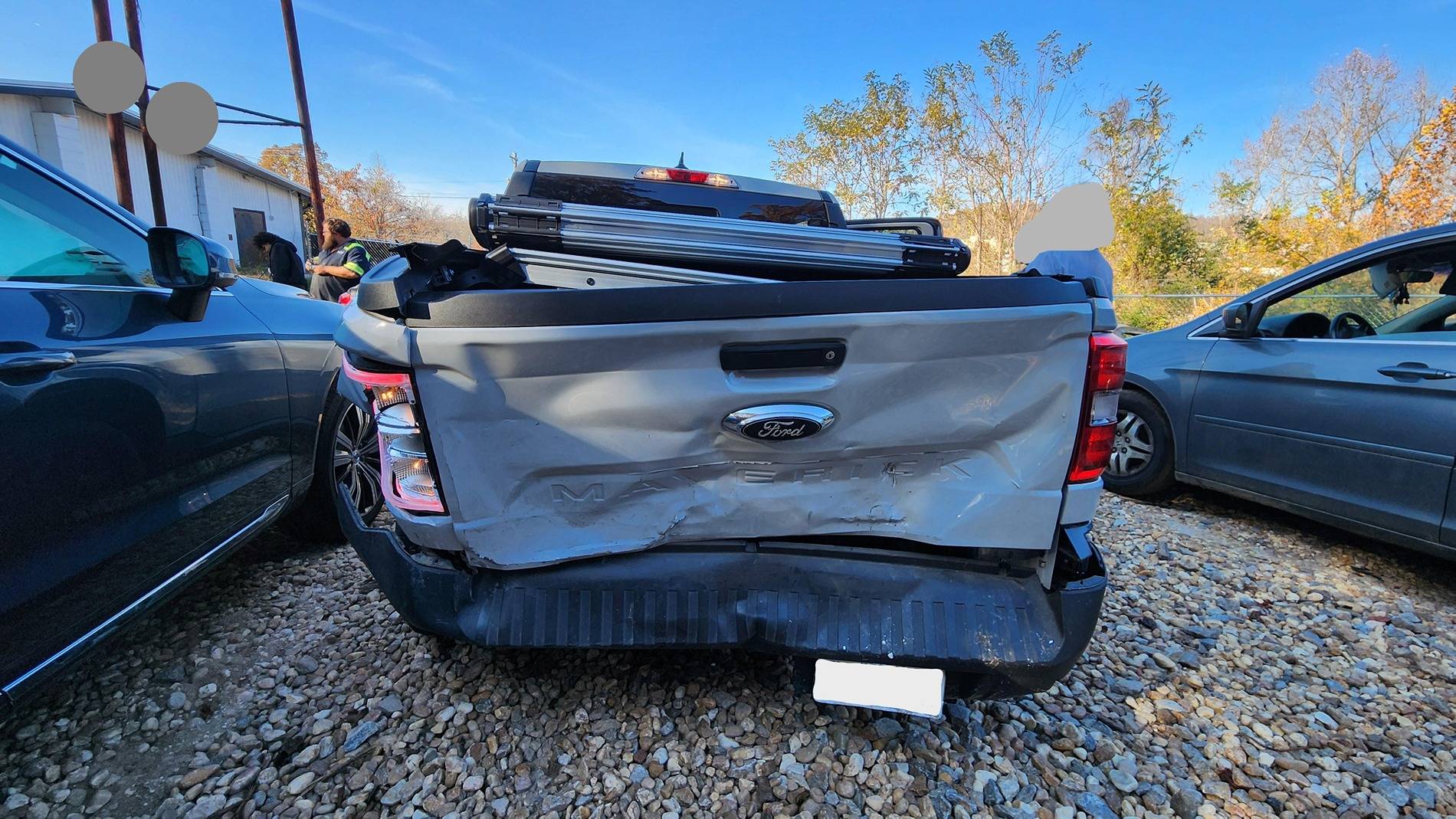

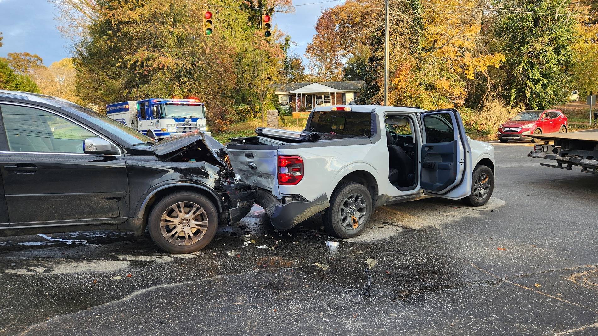

Hey friends. This is a follow-up to my previous post here. I wanted to start a new thread for visibility.
Back story: Owner of a '23 Lariat Tremor. I was on a 2 lane road at a traffic light, waiting to turn left with my signal on and yielding to traffic. Speed limit is 45. My wife was in the passenger seat. We were rear-ended by a Volvo SUV at what was likely the speed limit. The hit was pretty dead on. There were no brake marks and witnesses said there was no indication of braking. Seatbelts were on. Airbags didn't deploy, which seems to be intentional as they wouldn't have done anything.
My seat collapsed fully, and my head rest nearly came off. I went backwards hitting the top/back of my head on the rear seat just below my headrest, breaking the skin. The glossy spot in the below photo is my blood. My wife's seat collapsed, but stopped 2-3 inches short of the rear seat (the photo angle distorts how low it actually was). She was uninjured aside from whiplash.
I've registered a complaint with the NHTSA, as well as located a similar complaint with a '22 that can be found by filtering to "seats." I've not contacted Ford, given their history with this scenario.
I will absolutely never likely won't purchase a Ford again and am actively looking to get rid of my wife's Bronco Sport. My 12 and 20 year old typically ride in the back and the truck was our road trip vehicle. If my 20 year old had been there, their legs would have been crushed and the top of my skull would have gone right into their nose area, causing god knows what kind of damage. My 12 year old would have definitely sustained leg injuries as well. Now we're down a car and having to all ride in a SUV built on the same platform.
This is a known issue, in all vehicles, due to an outdated NHTSA safety standard. You can read about it here and here, and about the act introduced to correct the issue (which I believe has not gone into effect) here. Also a video from CBS here. Wild to think a long-running issue that's killing children isn't a big enough deal for car manufacturers to invest in correcting.
