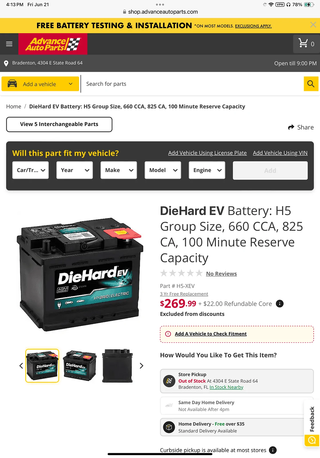

For those who have replaced their 12V batteries.
Have any of you done a Battery Sensor Reset??
GB.
Thread started.
Several times. Twice, I think by the dealer, and I did the blinker, brake reset at least 3 times now.....really had no effect. Reset it again when I put the Diehard in.... fingers crossed.
I think you're supposed to have your fingers crossed while you're doing the reset. 😁
What group size did you get in your DieHard?
