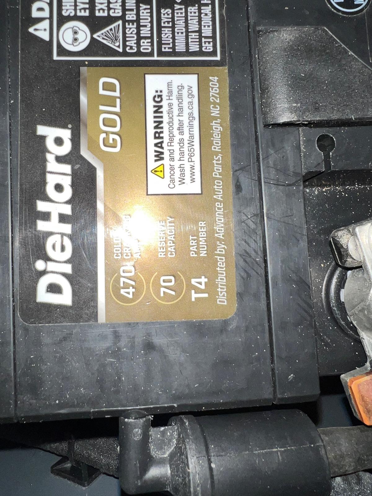

I think you're supposed to have your fingers crossed while you're doing the reset. 😁
What group size did you get in your DieHard?
Thank you.
It was a diiehard gold T4. 470 CCA
