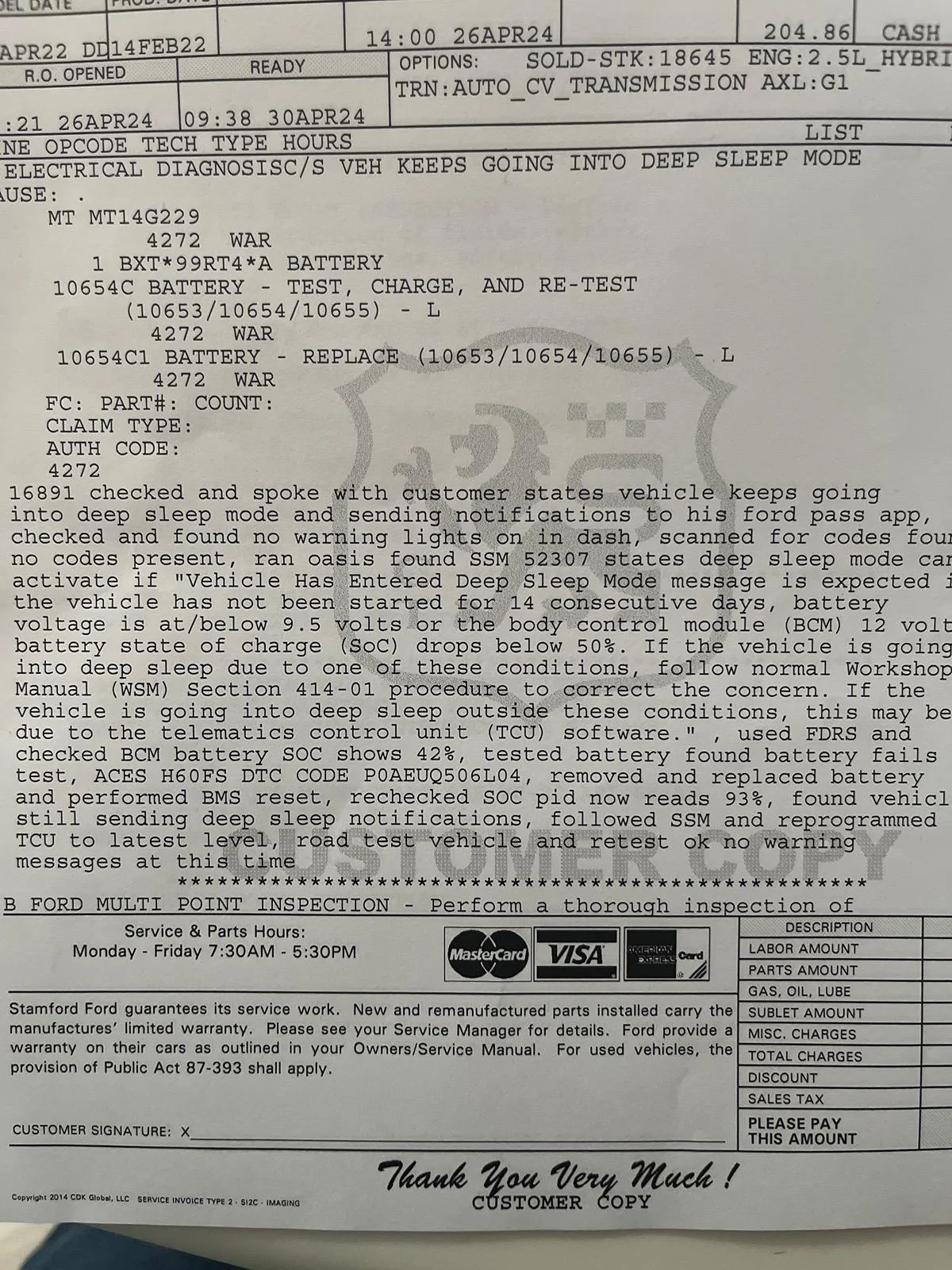

Do you get pinged by Ford Pass 2 minutes after each drive that your Maverick is in Deep Sleep Mode? Cabin lights don’t turn on when you get into car at night? Intelligent Access unlock doesn’t work on passenger side? … My CT dealer was able to finally fix this after 9 months with this persistent Deep Sleep Mode issue on my ‘22 Hybrid Lariat… here is the tech write up.. ask your dealer to perform these steps… my truck battery saver/deep sleep problems are GONE!

The summary is the tech found that the battery monitoring system (BMS) was reporting the battery was at 42% state-of charge (SOC). Tech tested battery, found bad, replaced battery. After reset while SOC of the new battery was at 93% the telematics control unit (TCU) was still reporting a Deep Sleep status to the Ford network so the tech updated the TCU programming in accordance with a service bulletin.

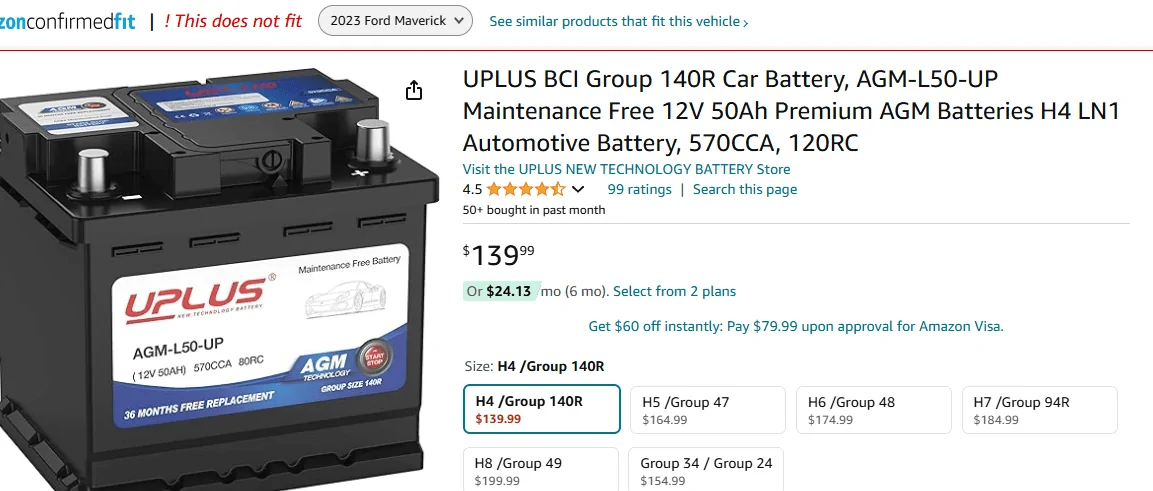

Thanks for all the input! I can't see spending $250 or so for an AGM battery at this time, budget just won't allow it. Hopefully my extended warranty will keep things humming along.
$139 for the battery agm.
Ford Maverick Deep Sleep Mode - CURED!! Battery Replacement uplus battery
Was that all done without you paying for it?
I would like to get my hands on that bulletin in case and if I need to go into a dealer
