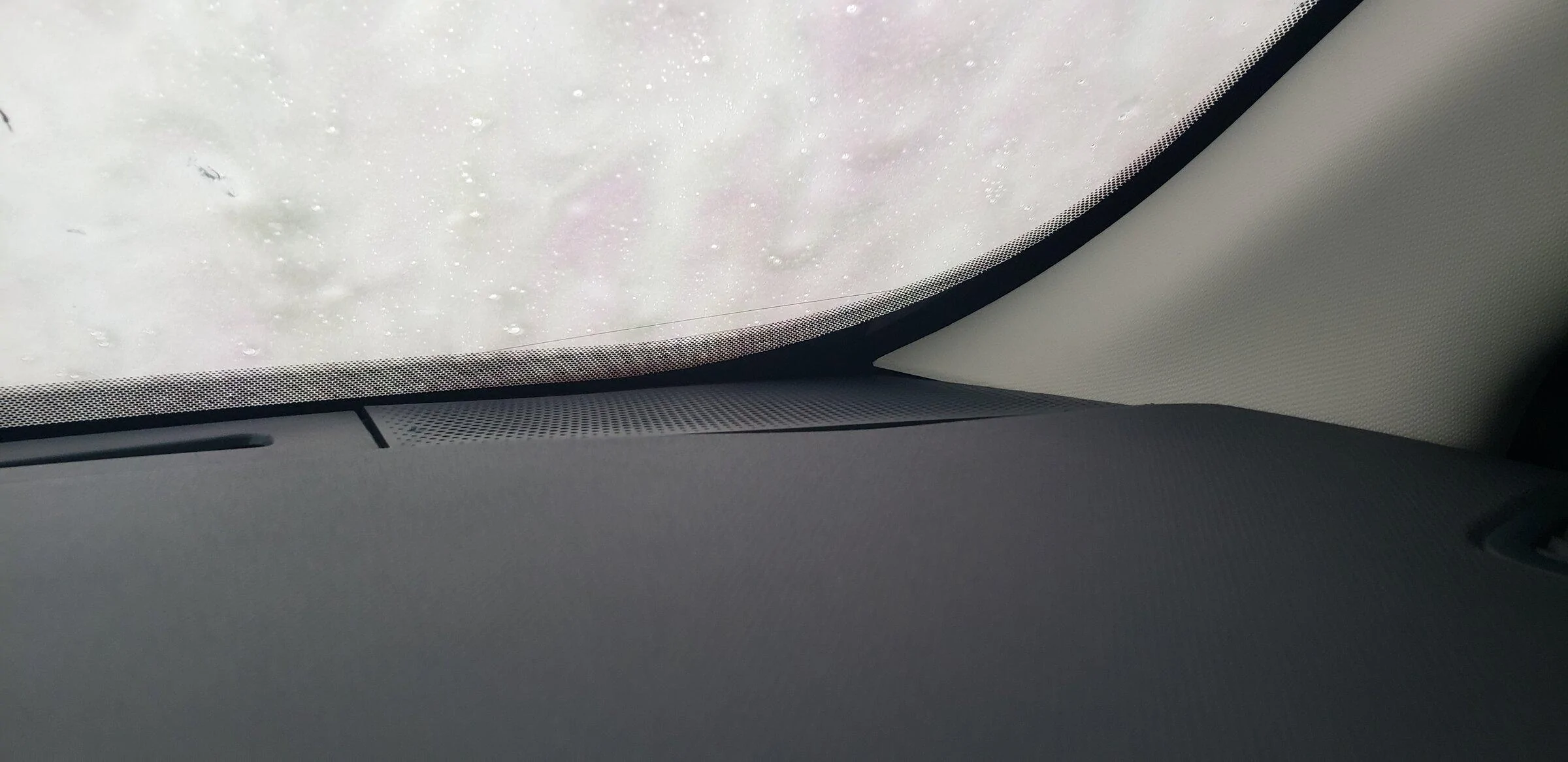

Sounds like they didn’t replace the windshield! Take a peak and picture of the bottom inside left of windshield. There are some stamped words and such there post it let me look at that. Because if it was replaced this will be different from mine….
g
Finally got around to nabbing a pic that you can actually make it out. Still have to get the left side.
Ford Maverick Rattle in the dash (a minor yet major annoyance) 20220315_093903
Does anyone else have something like this? (Ignore my tweeter cover)

Nice… need to see the left side for the wording… but I am assuming it was replaced based on your wiper de-icer lines are actually very visible vs mine. Also, where are your wipers at? I think mine need adjusted you can see the passenger wiper up on the windshield when in park or off? Very interesting… and you still have noise after windshield replacement
