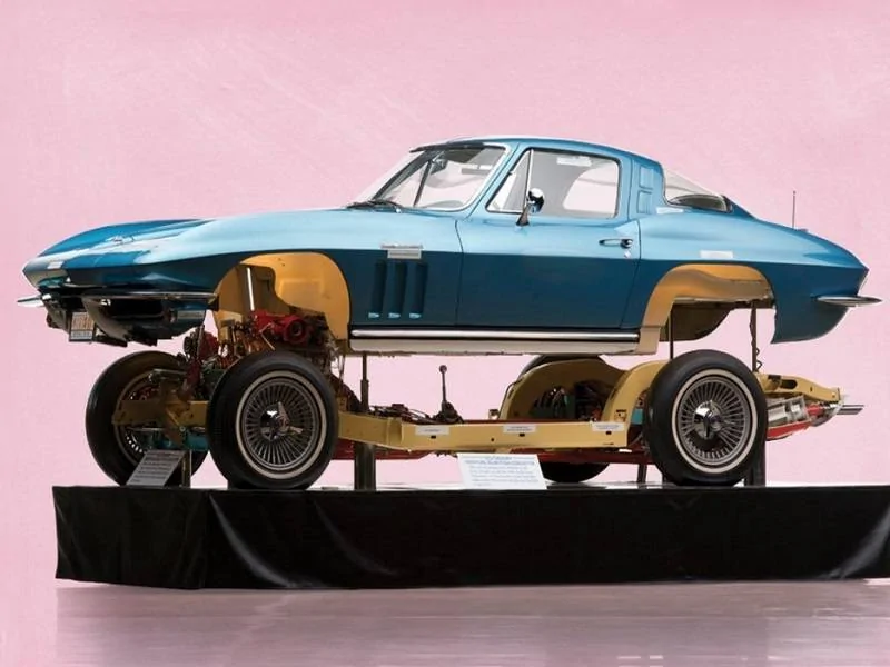

For example, older corvettes had both a ladder frame and a one piece body.
Ford Maverick Pushed the towing limits IMG_2400
Where they considered to be unibody? Nope. They were body on frame. The body didn’t provide the structural rigidity or crash worthiness. In a crash, the fiberglass would fracture apart and all that would be left is the frame.

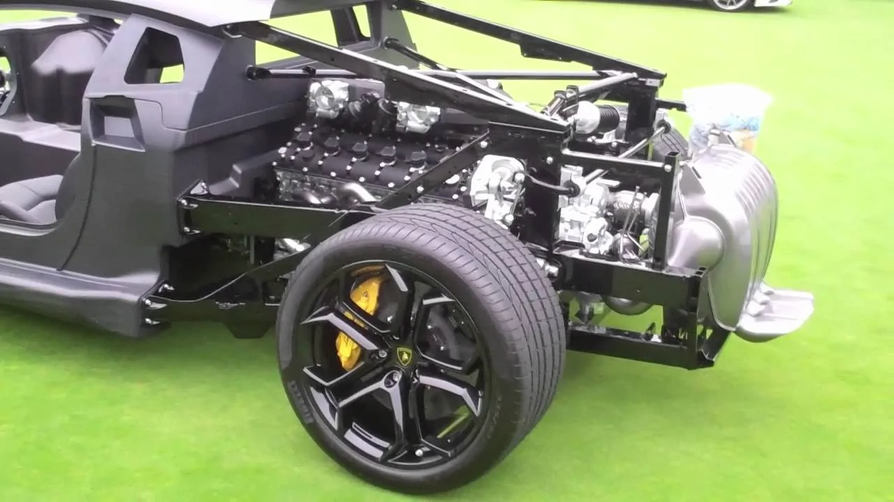

Or consider the 1990’s Italian monocoque design:
Ford Maverick Pushed the towing limits IMG_2396
It clearly doesn’t have a one piece body “unibody” and it has front and rear ladder style sub frames that the body pieces are bolted on to, like the old school body on frame cars. Yet it is considered to be a “unitized body”, or unibody. Why? Because the monocoque, or “tub” is where the strength, the structural rigidity and crash worthiness come from. When these things break apart in high speed impacts, the only thing left intact is the monocoque.

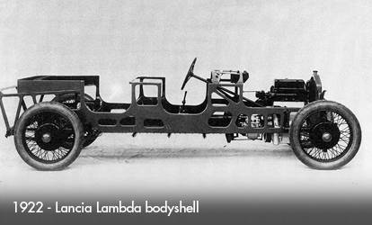

And lastly is the evolution of the unibody. Even though today’s cars are a single body assembly that is all welded together into one piece by a dozen welding robots, it didn’t used to be that way because welding was time consuming and expensive.
The oldest unibody cars were still bolted together as multiple assemblies.
Ford Maverick Pushed the towing limits IMG_2402
And you could even drive around in the frameless platform, without having the body panels on it.
Ford Maverick Pushed the towing limits IMG_2401
They key point was that there was no frame
Ford Maverick Pushed the towing limits IMG_2394
And it was the body that was creating the structural rigidity and crash worthiness.

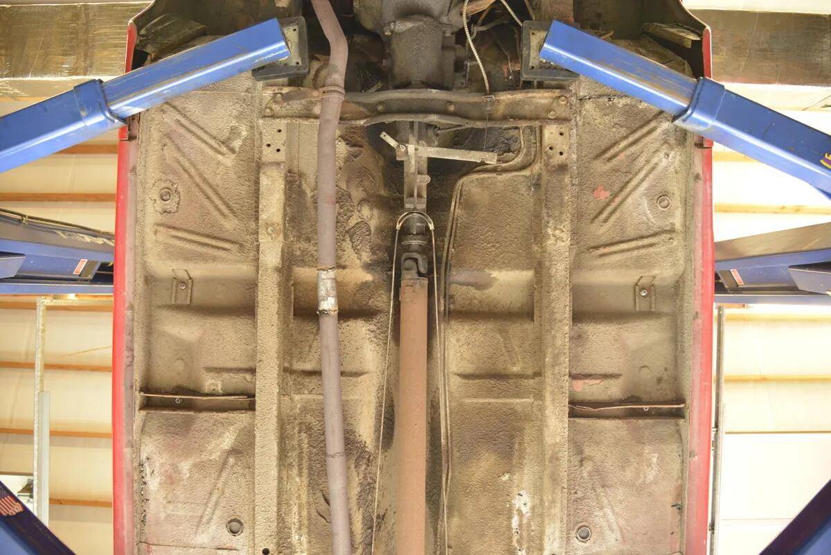

The early Rancheros on the Falcons were the same chassis as the falcon. Slightly different than the uni-body of today but it was not a full frame. Here is the underside of a 1960 Ranchero.
I stand corrected, I was thinking it was a full frame like the 61-63 F-100. It’s been several decades since I was under neath a Ranchero. Last time was a 1974 model
