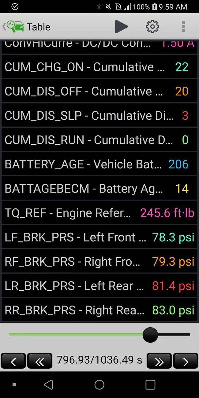

So for the braking aspect while using Low in Normal mode. Used on my drive into work.
When you do get the pads in that last 5-10 mph stopping - just even pressure, like Normal. But regen area is indeed all regen, it only appears to pin the needle on the line.

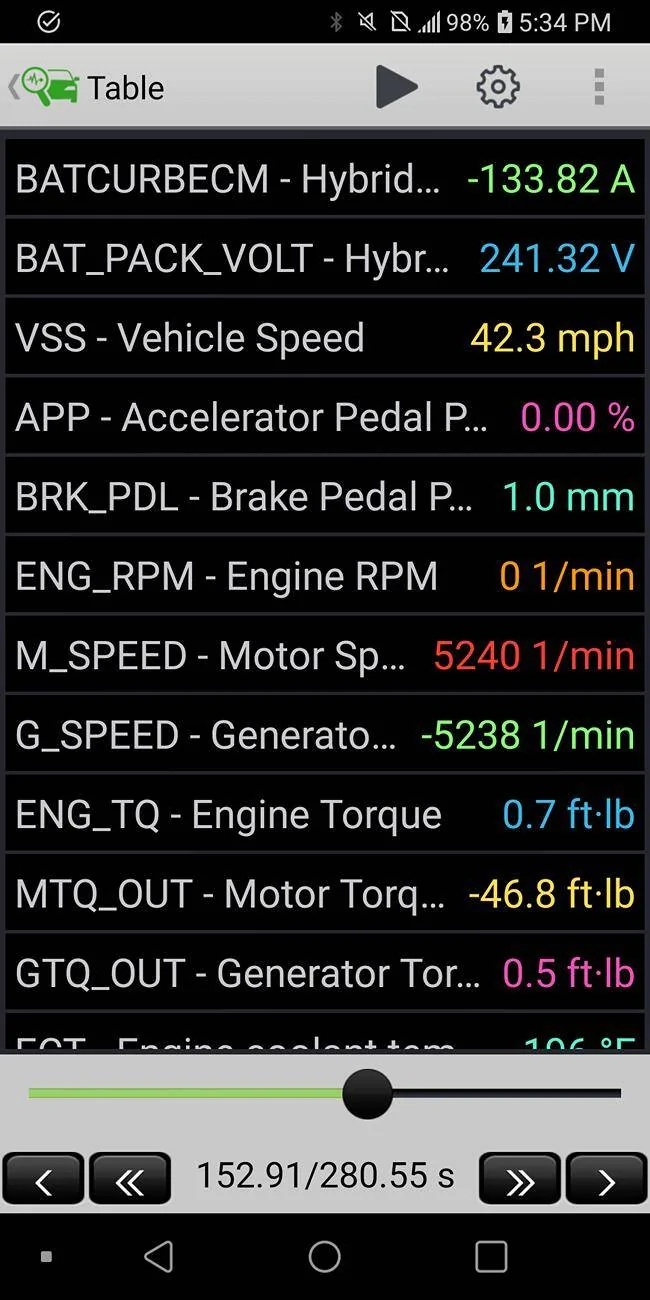

Now - max regen in Low mode with foot off Go pedal? Perhaps no.
That's 145 A max.
I've seen close in Normal mode at decent speed and going past regen into pads, so getting close to max regen then. 1mm on the brakes, didn't have the pressure logged for this, but EV Coach said beyond regen.

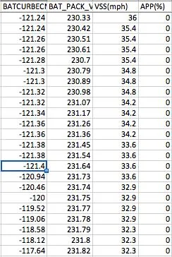

For Low mode, this is what was gotten taking foot off Go pedal at 36 mph - 119.36 Amps, and it appeared to pin the needle.
Snippet of final moments off and back on APP. Which may have slight reading delay.
Ford Maverick Premature rear brake rotor wear 1747760211654-vn
A tad more Amps going a tad faster, so perhaps max can be hit at higher speeds/momentum.

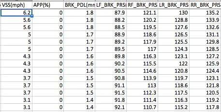

Wanted to show a little more of the Slippery mode rear brake engagement, after I adjusted the columns for the fact they are each 1 entry delayed extra for each wheel.
The entries where I'm just sitting with equal pressures indicate I got the adjustment right.
So this is snippet of final 6 mph for a bit is each time. Not huge amount of extra pressure difference to the rear.
Not sure what's going on with LF brake.

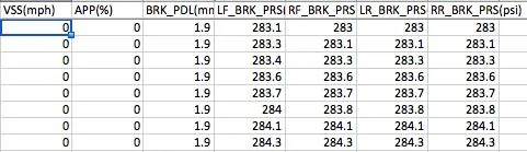

Just a few showing it does equalize finally while waiting at light, and matches exactly finally.
Guessing the booster/ABS just isn't that exact on where the pressure goes.

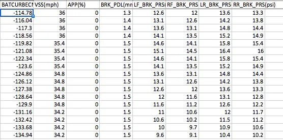

While moving and regen not enough, so into the pads, and at this point, starting to release the brake pedal. Again not much extra pressure to the rear, but unlike Normal mode, fronts not engaged first.
Ford Maverick Premature rear brake rotor wear 1747770793670-pd
So I'm tending to believe, that if your use of Slippery mode is only digging into the pads on the final stop 5mph and less - you'd have to have a whole lot of stops, then those could add up to really wearing out the rear more than others.
And if you are like me trying to use Slippery, and frequently misjudging the distance and the stopping power, and not great at fine tuning the pedal on the bottom end of regen and constantly slipping into the pads - then ya, probably even faster wear on the rear, especially if just barely slipping into the pads.

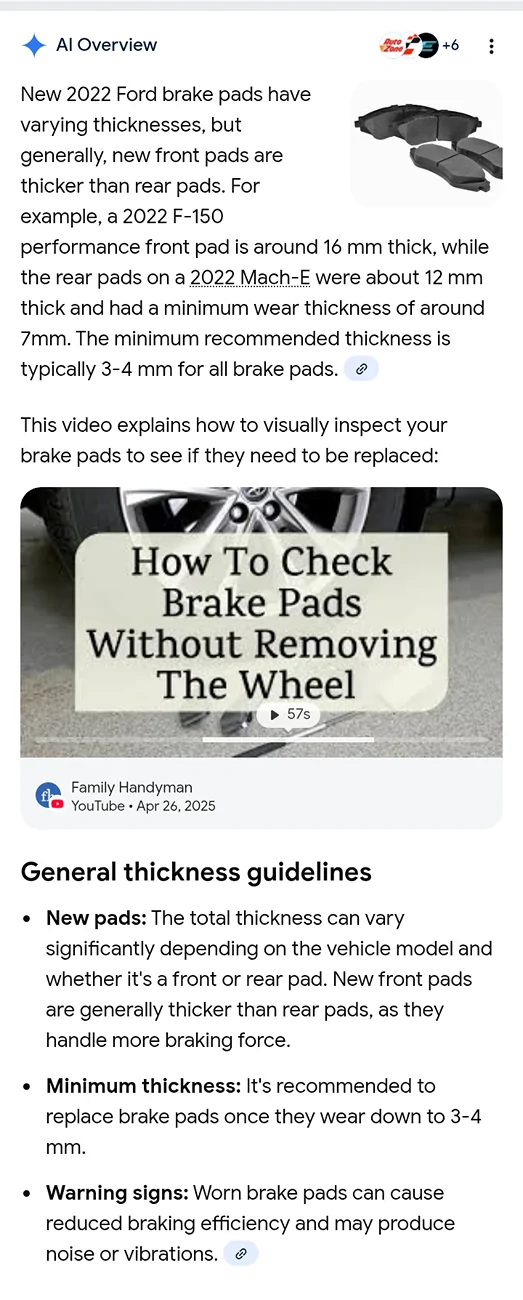

I checked my brake pads yesterday.
The fronts have easily 50% more material than the rears do. I tried but couldn't get a good picture of the difference. I expect to have to replace my rear brakes before 50,000 miles. That's on a hybrid.🤷‍♂️

Check original pad material thickness for difference?

Yes.
I was going to say, front and rear rotors are different, so front and rear pads were probably different from the factory.
