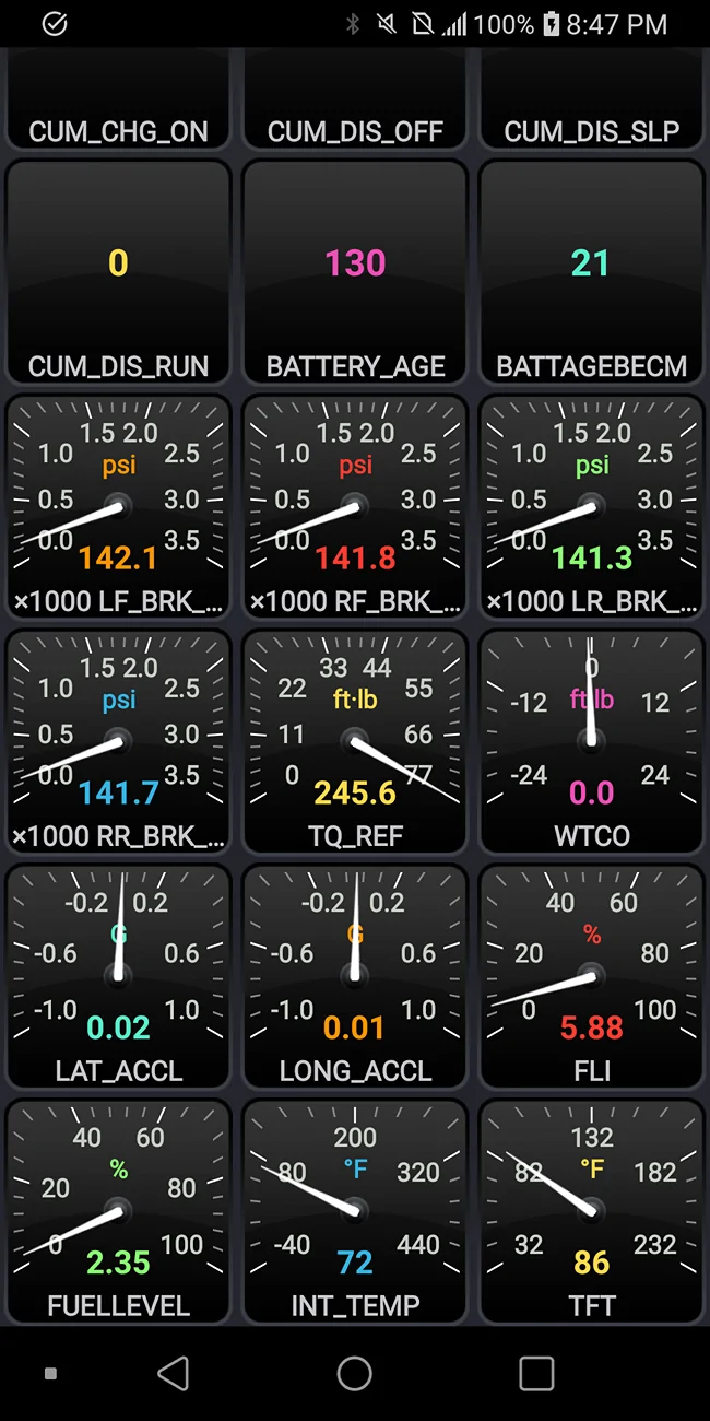

Ok I understand now but with all these different “holds” I guess I’m just wondering which brakes are the ones being held, front or back? Not trying to start any flame wars here, I just am unsure, and since I’ve been here, 5 months, Ozarkbeard has, in my opinion, been a great wealth of useable advice!
Good question. I thought that the auto hold affected all four brakes. Hmmm…
HeyBales
May 3, 2024
5,141
4,841
KC Metro area
It does - pretty much equal pressure to all 4.
