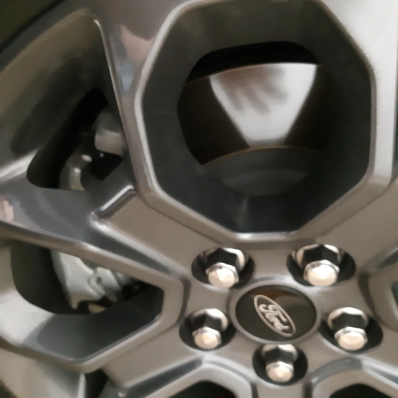

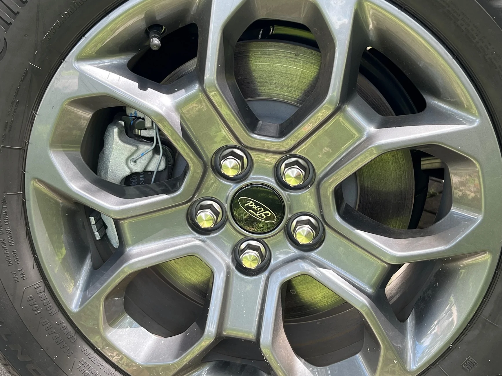

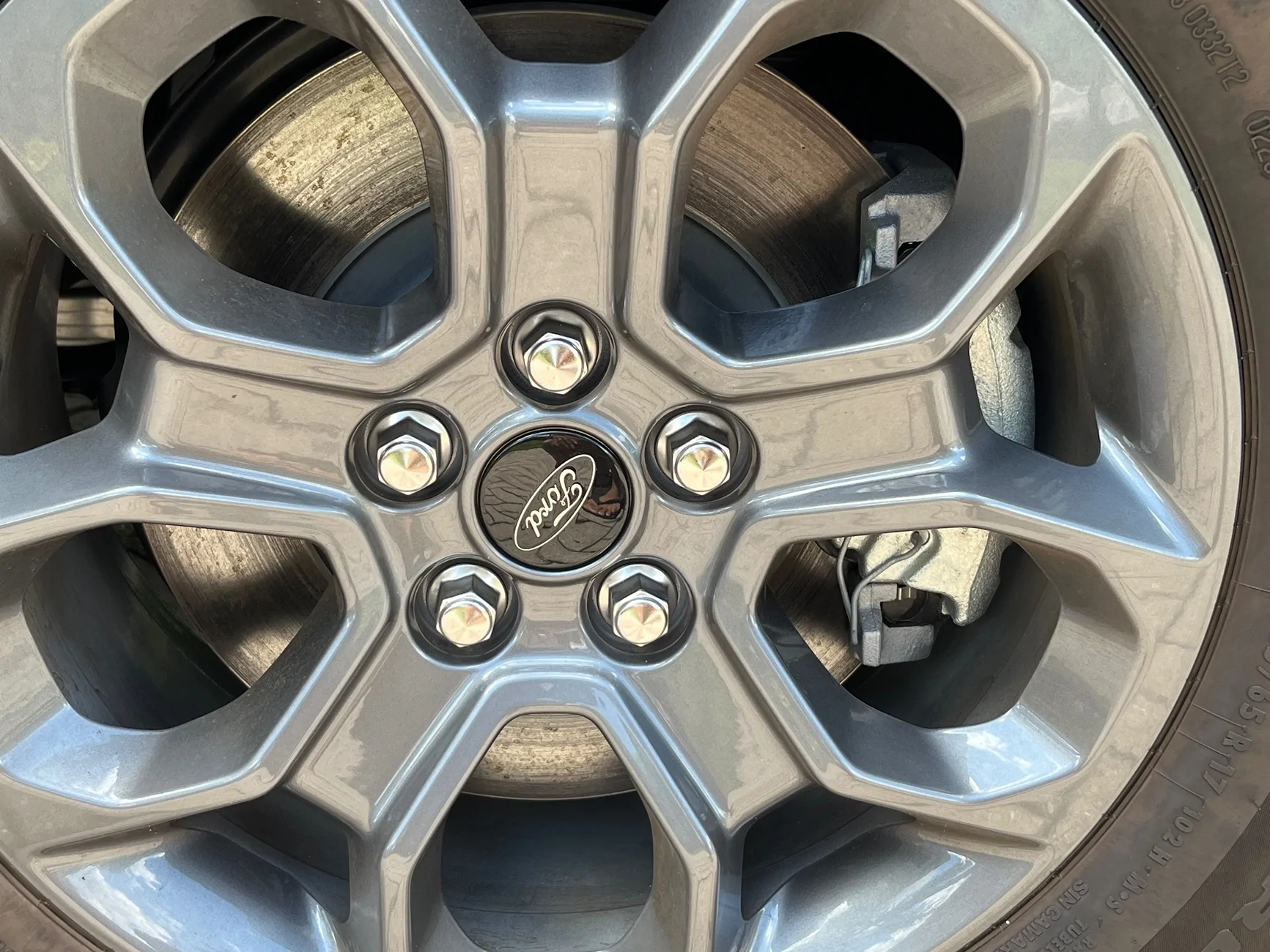

The second picture is the only one that looks good my friend. (ignore the surface rust)
The other rotors show obvious signs of wear and I suspect that your brake pads are down to the rivets.
Please have a mechanic look at it, my friend.

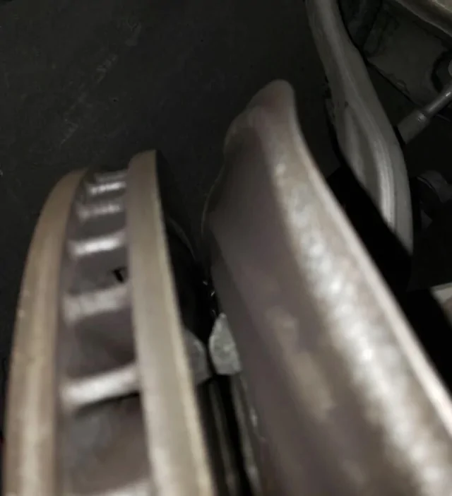

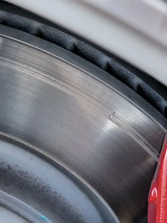

There's something stuck between the brake pad and the rotor, a small rock maybe
Agreed.
Ford Maverick Is something wrong with this brake rotor? IMG_3891
Ford Maverick Is something wrong with this brake rotor? IMG_3892
Ford Maverick Is something wrong with this brake rotor? IMG_3893
Not a manufacturing defect.
Not covered under warranty.
Not necessary to do anything at all.
Even if the dealer said you need to replace the rotor, that would be just so they can squeeze you for profit. It’s going to function just fine and last normally.
Take the wheel off and look for the rock. It may or may not still be in there. If it is, gently coax it out with a plastic putty knife.
The mark will go away in a few hundred miles.

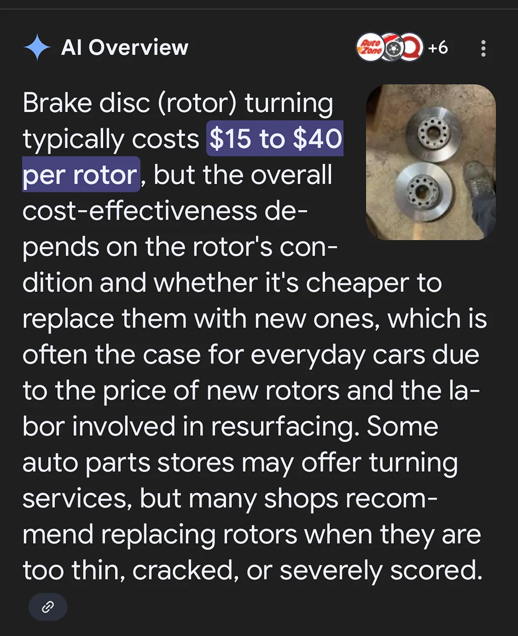

What makes you think someone resurfaced the rotors? I’m not seeing anything in these images that would indicate resurfacing.
Picture 3 looks like a really bad and deep rotor turning job, or it could be that the pads are worn down to the backing plate.

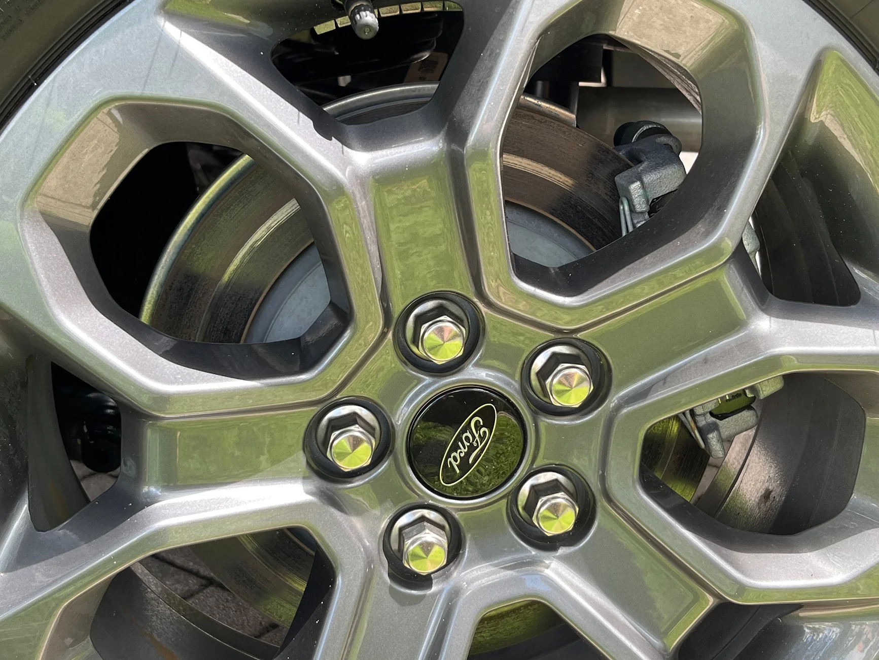

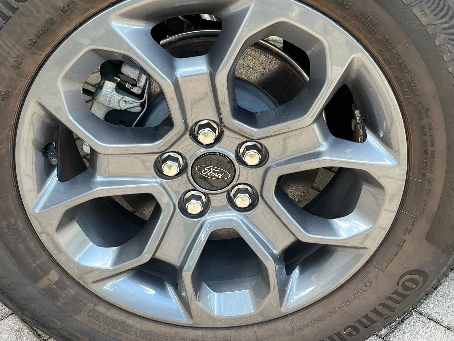

Rear drivers side.
The the rest below
I know why post here, my dealer is almost 40mins away so. It doesn’t look right.
Update Please.
Did you try braking hard while in Neutral to polish your rotors?
How did they look after braking hard in neutral? I say brake on the hard side to ensure you get pressure on all four.

The odds of any "rotor turning" involved here are between slim and none.
A) this vehicle is fairly new
B) Modern vehicles, especially low cost entry vehicles do not come with enough meat on the bone to allow turning
C) Maverick rotors are probably disposable, non-repairable components.
And Slim left town.🤣
Auto manufacturers do everything they can to reduce the weight of the vehicle to increase the mpg.
It makes sense that the rotors are one time use item.

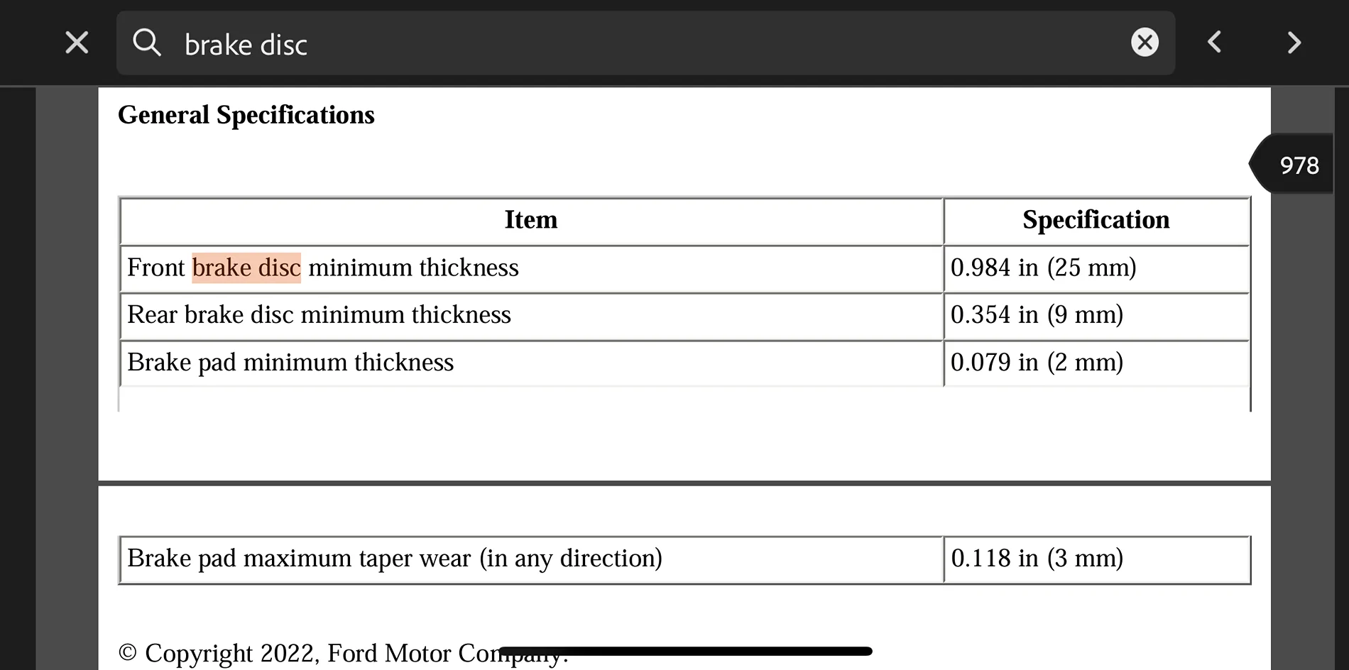

To know for sure, gotta get out and measure.
Ford Maverick Is something wrong with this brake rotor? 1755878344057-yf
Fronts are hollow (vented).
Fronts New: 1.063" Discard at 0.984"
Fronts New: 27mm Discard at 25mm
Rears are solid.
Rears New: 0.433" Discard at 0.354"
Rears New: 11mm Discard at 9mm
Goes on to say:
"Off vehicle bench turning is not allowed. On vehicle turning is allowed using Ford specified tool and procedure."
new Ford OEM discs: $88
New third party discs: $50
who's gonna turn them?

Never updated. It appears there might’ve been something that got caught and then eventually came out. Basically left the mark. No prob with braking just visual. Dealer said they could re surface but it’s going to make it thin for no reason. So left it as is.
