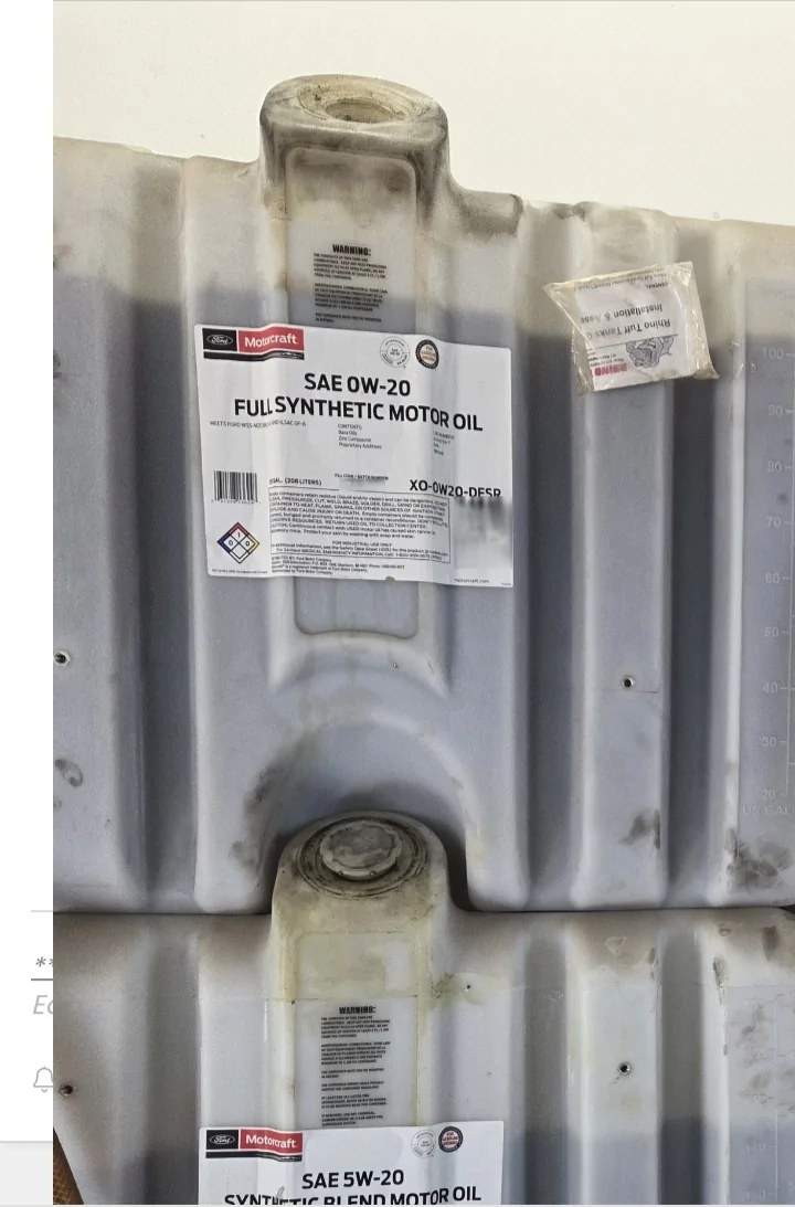

Motorcraft 0w 20 full synthetic is available in bulk at the dealership.
