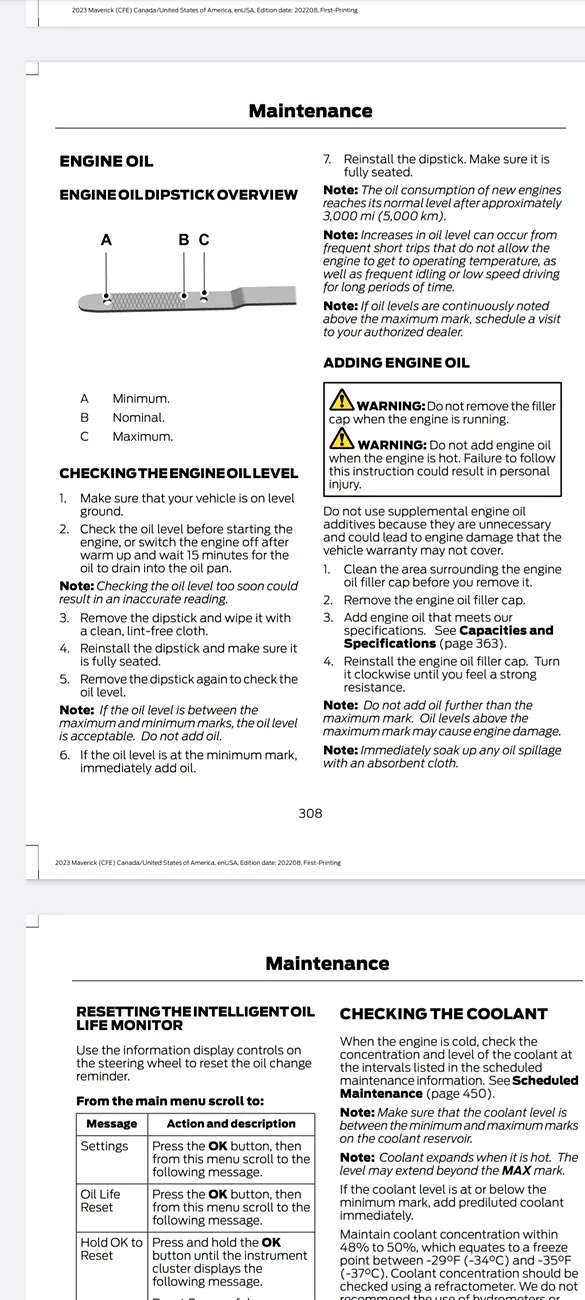

Truthfully, the "hole" is the "you've gone too far hole, now take some out" hole.
You SHOULD be anywhere in the cross-hatched area for proper performance.

This is what the manual shows for a 2023 hybrid. Hole "C" above the hash marks is maximum.
Okay, but mine is an EcoBoost and I would just like it to be at the second hole or a teeny bit lower. My dipper doesn’t have a hole ‘c’. So I just want it at hole B. This is starting to sound weird😱 Anyway….

Enhance .... enhance .... enhance
There is nothing but a line for B in that picture.

If it is anywhere between "A" and "B" and below "C" you are good, but I am like you and would want it close to or at "B".

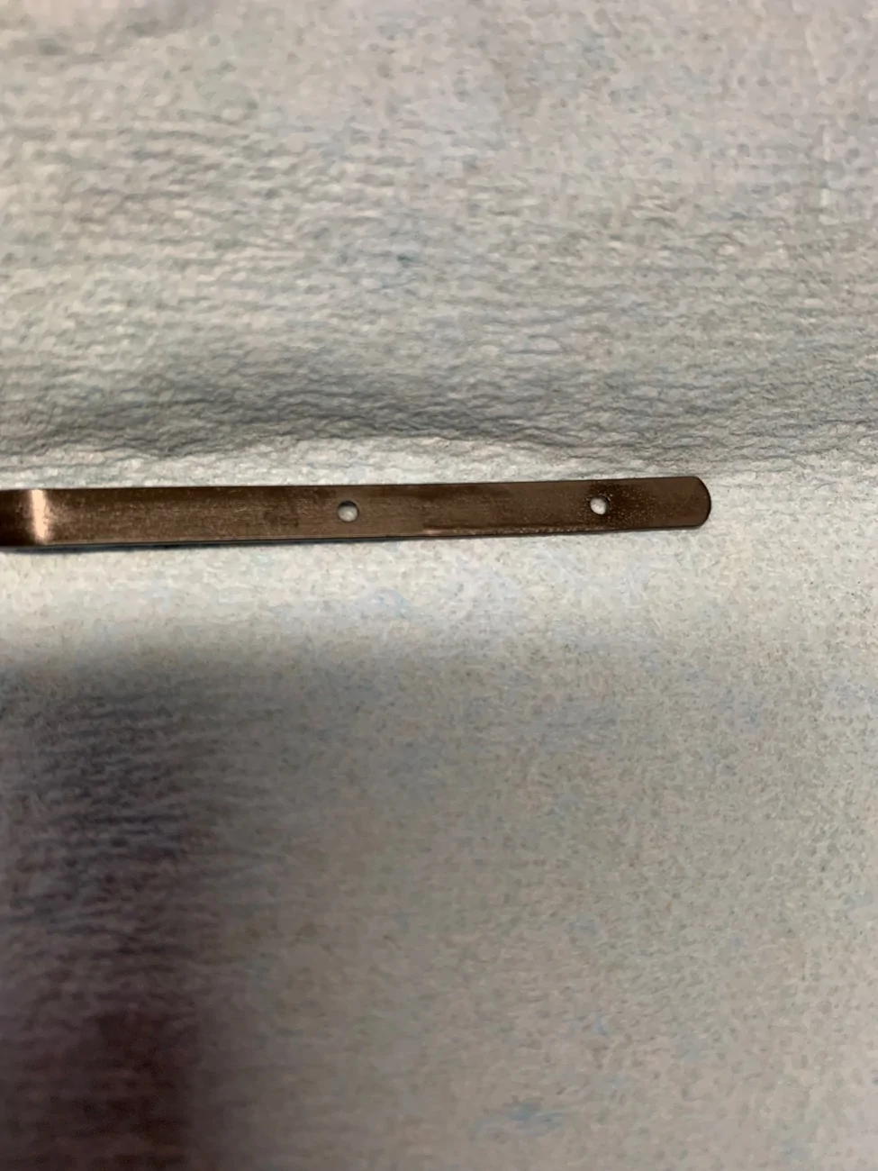

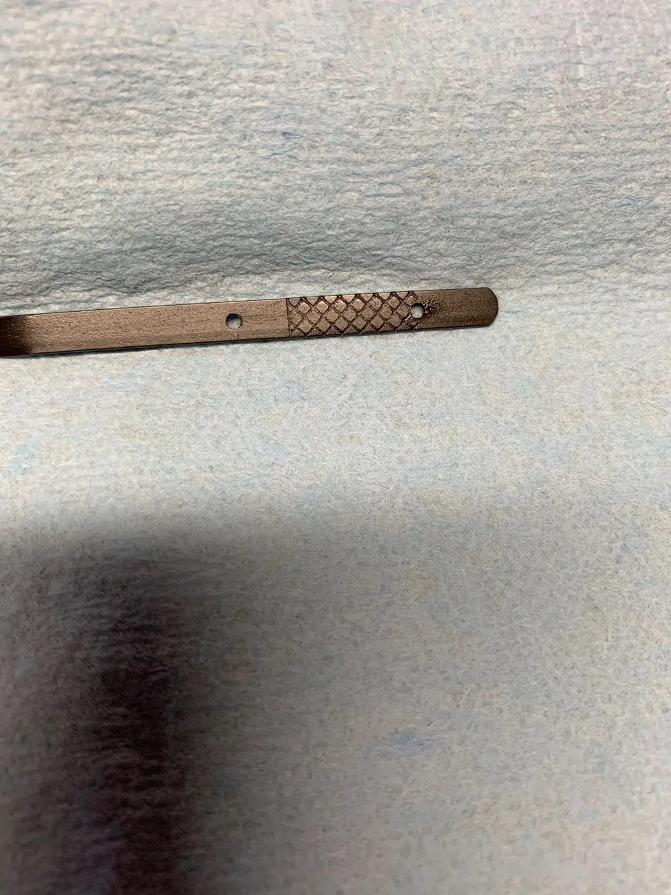

Fine then people,’24 EcoBoost FX4, 2.0 turbo, made in Mehico, sent to Canada, here is pics of my oil stick! No A,B, or C!

I like to fill mine to "B" (Nominal) or slightly below. In cold weather I've had the level increase to the "C" hole (I believe from fuel dilution) even though I avoid short trips as much as possible.

Duh, never mind, AB&C are just reference points to points on the dipstick, daft me🙄
