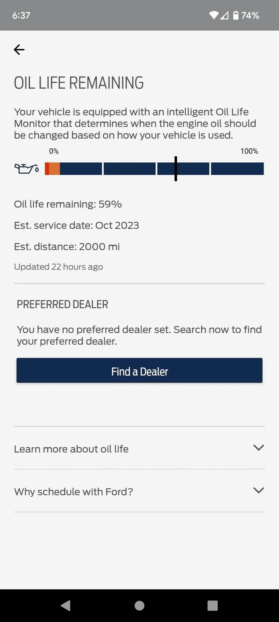

My Ranger has 1,5xx miles on it and I've owned it 6 months and my trips are short. Here is what the Ford app says (I am actually going to change the oil now):
Ford Maverick Oil Change Question 1678923543831
By the second oil change, I'll probably go with some 300V and sample as I go. I've already tuned the transmission and am about to tune the engine. This truck will be used for a bit of towing as well. The Maverick we ordered will be for my wife, so the usage will be different... Other than when I tune it and go have some fun with it. :)
