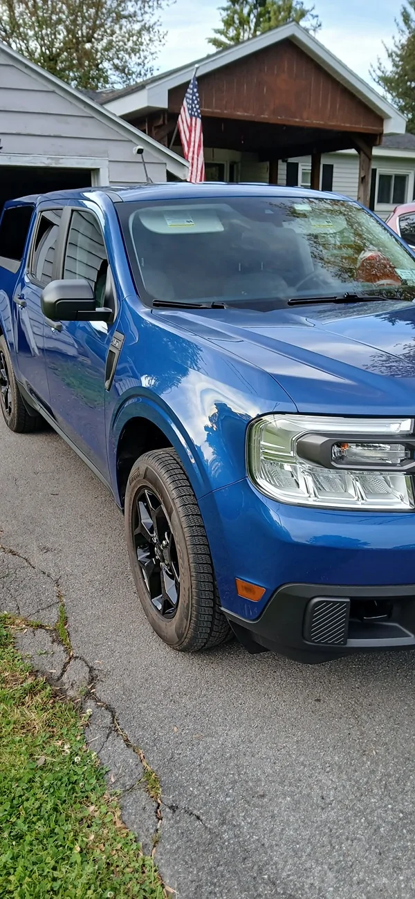

I'm currently running Sunoco 94 octane and while I don't notice the difference from the Sunoco 93 octane it makes me feel like I have to drive it harder 🤣 also just detailed it yesterday and put my Maverick Truck Club decal on 😎
Ford Maverick Tested 87, 91 & 93 Octane. 20260527_113122
Ford Maverick Tested 87, 91 & 93 Octane. 20260526_194124
