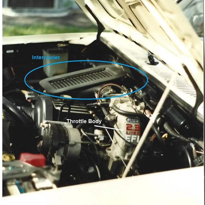

The one put into my 1985 Ford Ranger SVO (1987 T-Bird 2.3L with Intercooler).
Ford Maverick New Ford Racing Intercooler (Mishimoto) for 2.0 EcoBoost Maverick Opus1_2.3L Turbo_Intercooler-Detail
Was, Under the hood..
I take the location of the Mav's to be, under the Grille??

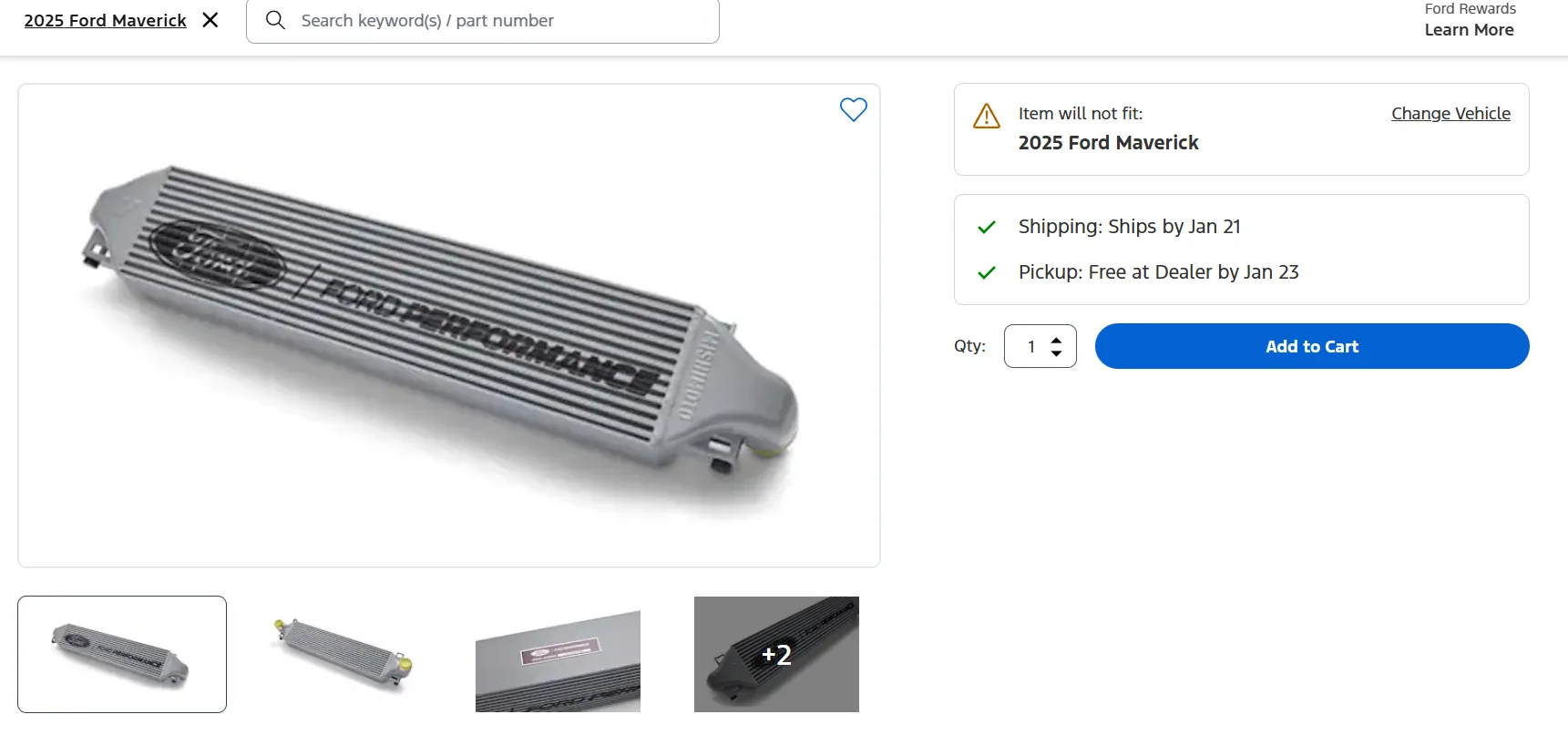

And just for fun I looked it up: 2025 Ford Maverick Lariat 2.0L ecoBoost
The vehicle fitment hasn't been set up for it, but it fits all non-tremor 2022 - 2025 2.0L Mavericks.

The vehicle fitment hasn't been set up for it, but it fits all 2022-2025 2.0L Mavericks.
The 25 has a different turbo than the 22-24. And the upcoming 2.3L turbo included in the 300T package will make 3 different turbos compatible with this intercooler? I don’t know how tunes work but I think it would be required?
