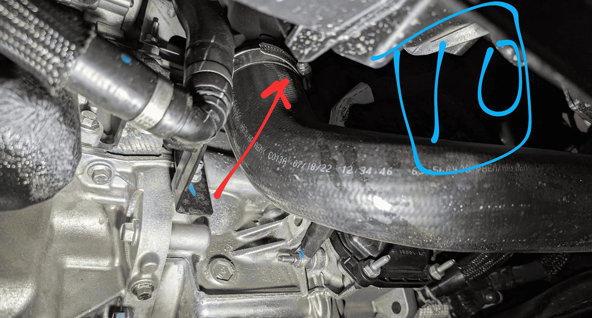

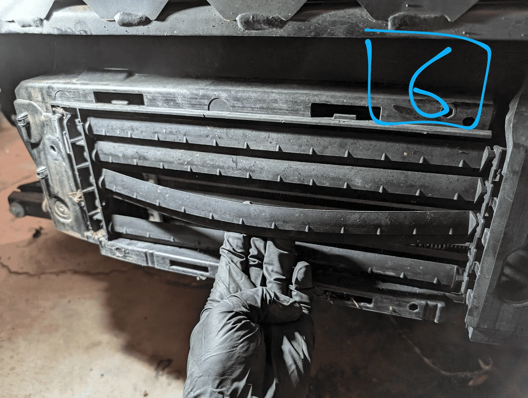

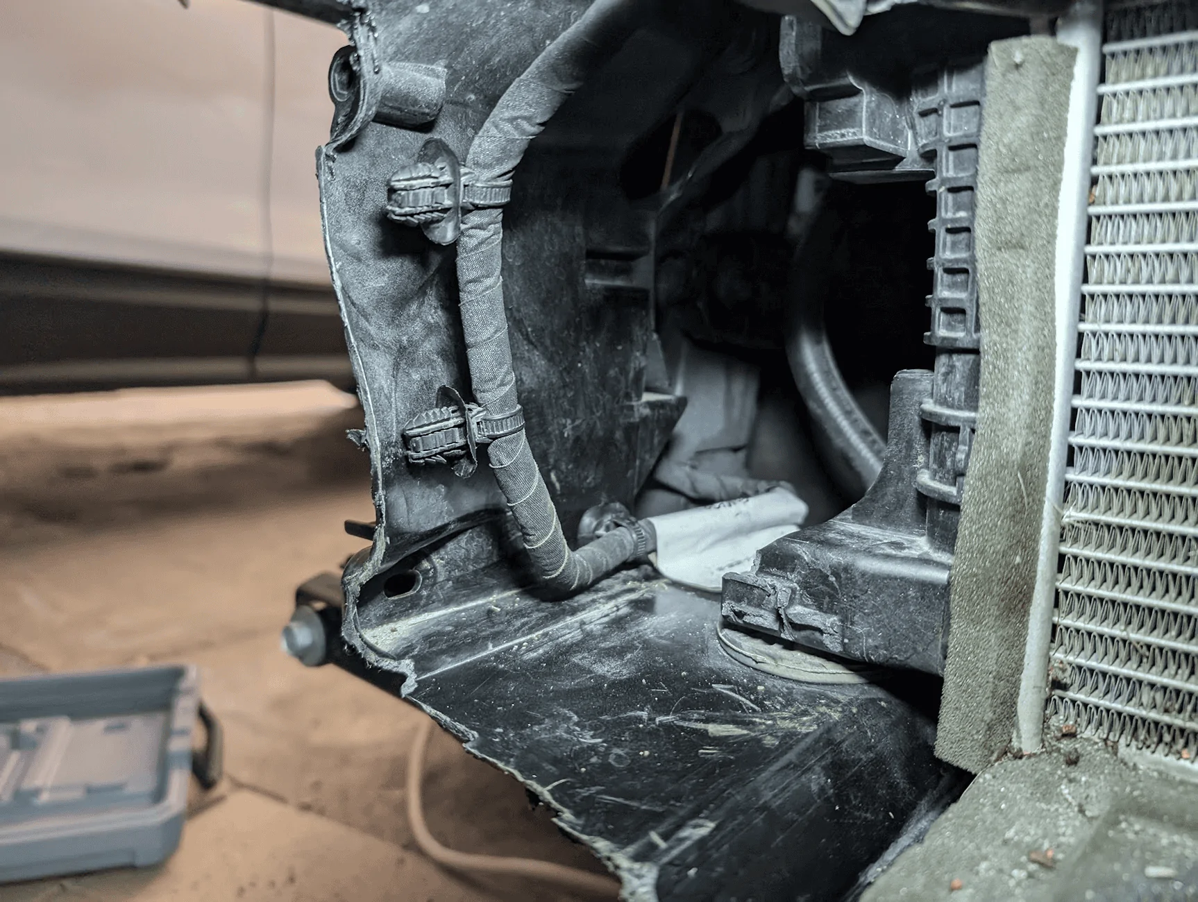

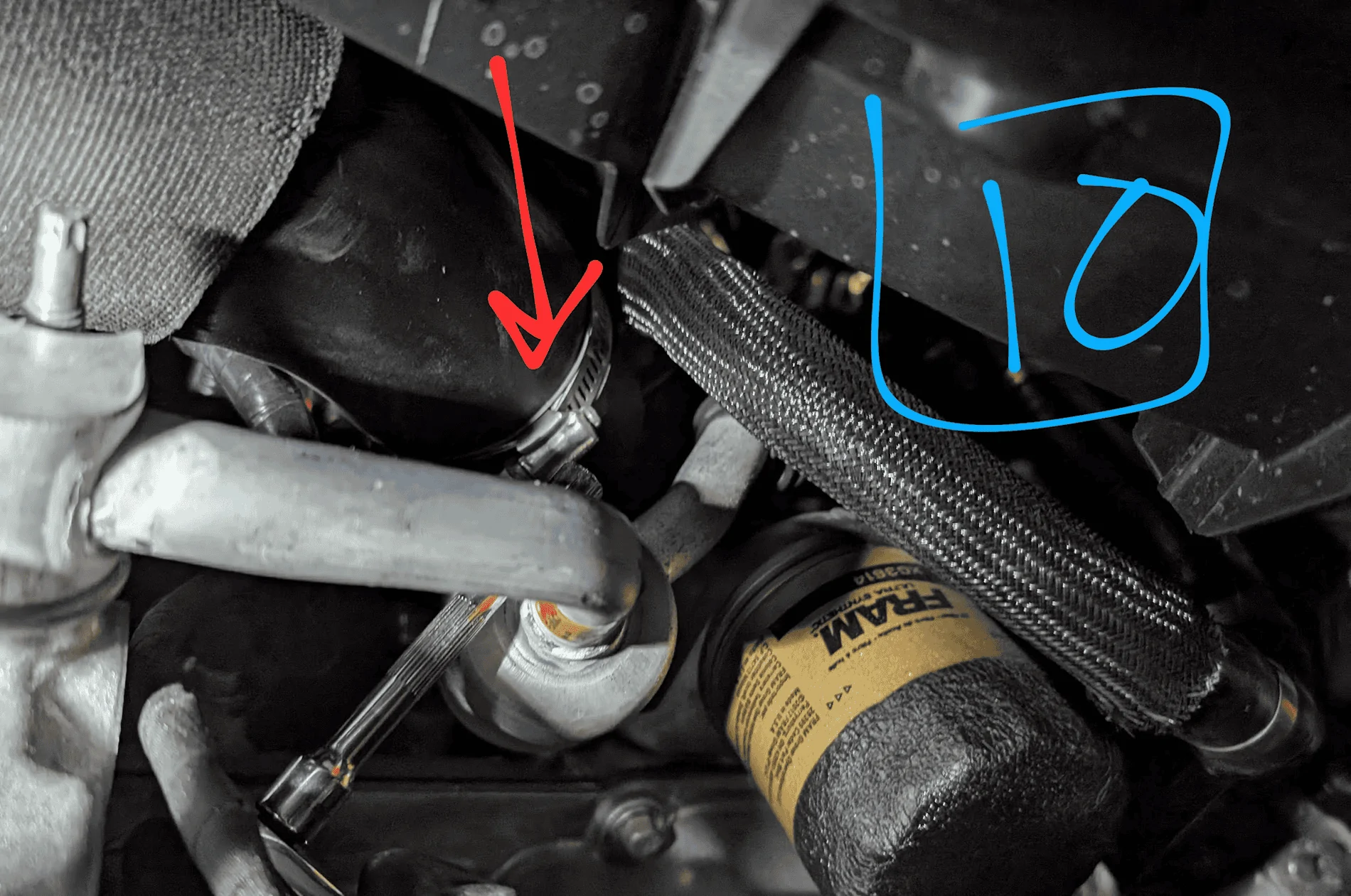

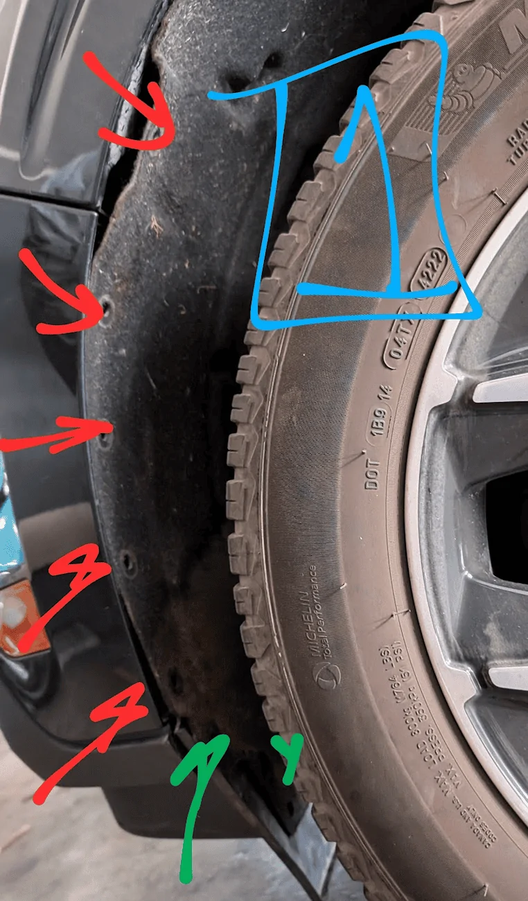

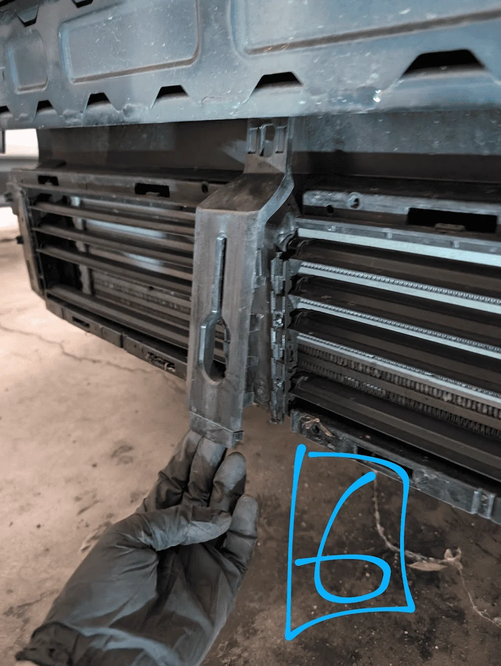

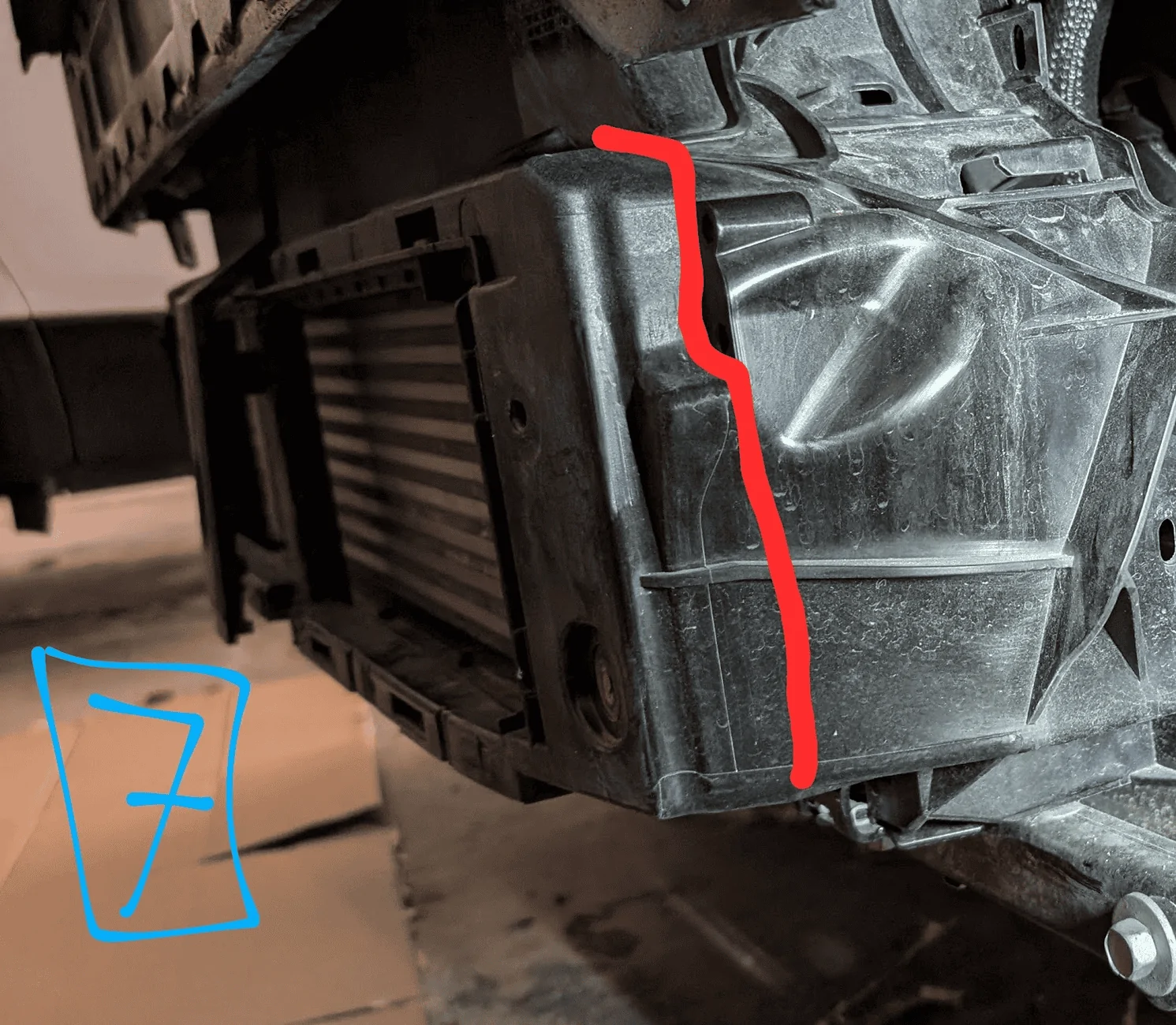

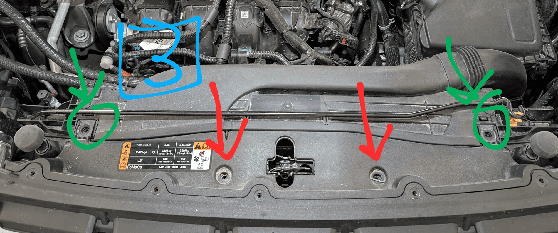

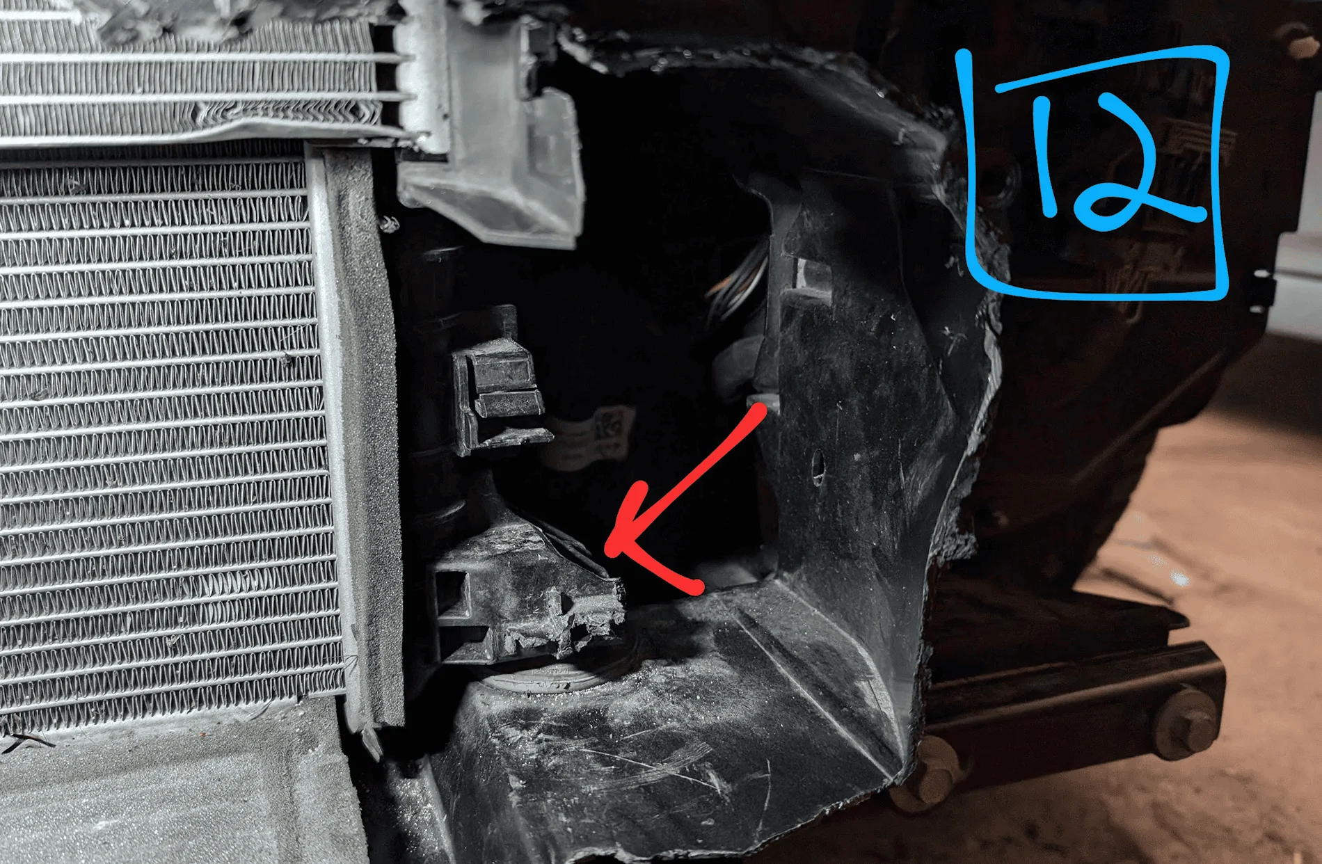

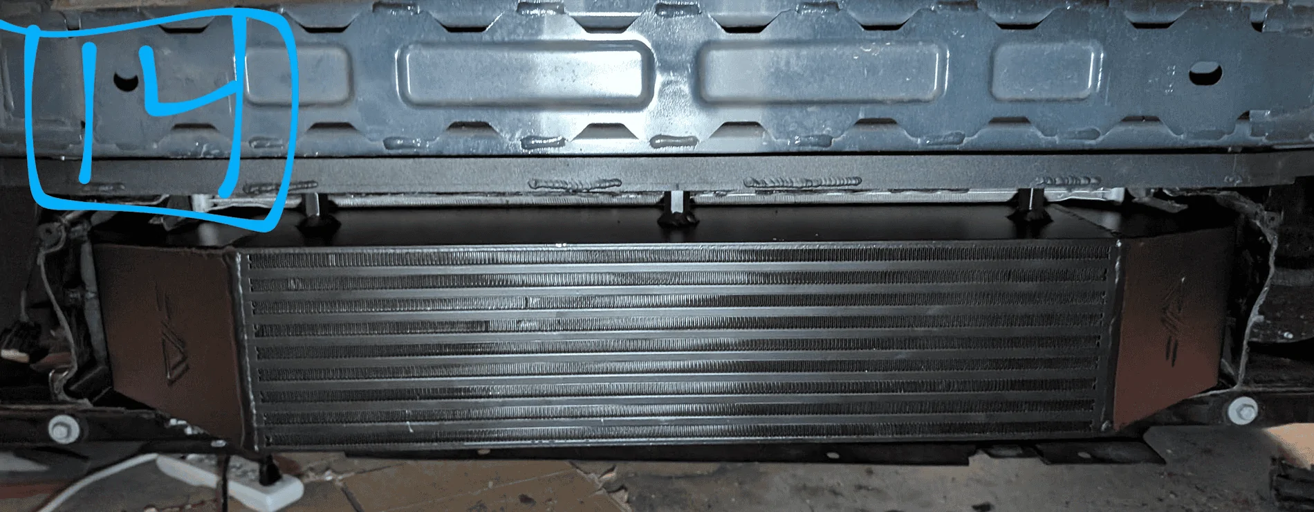

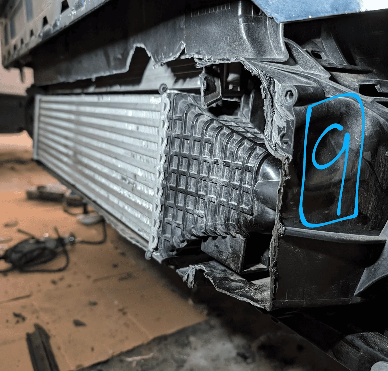

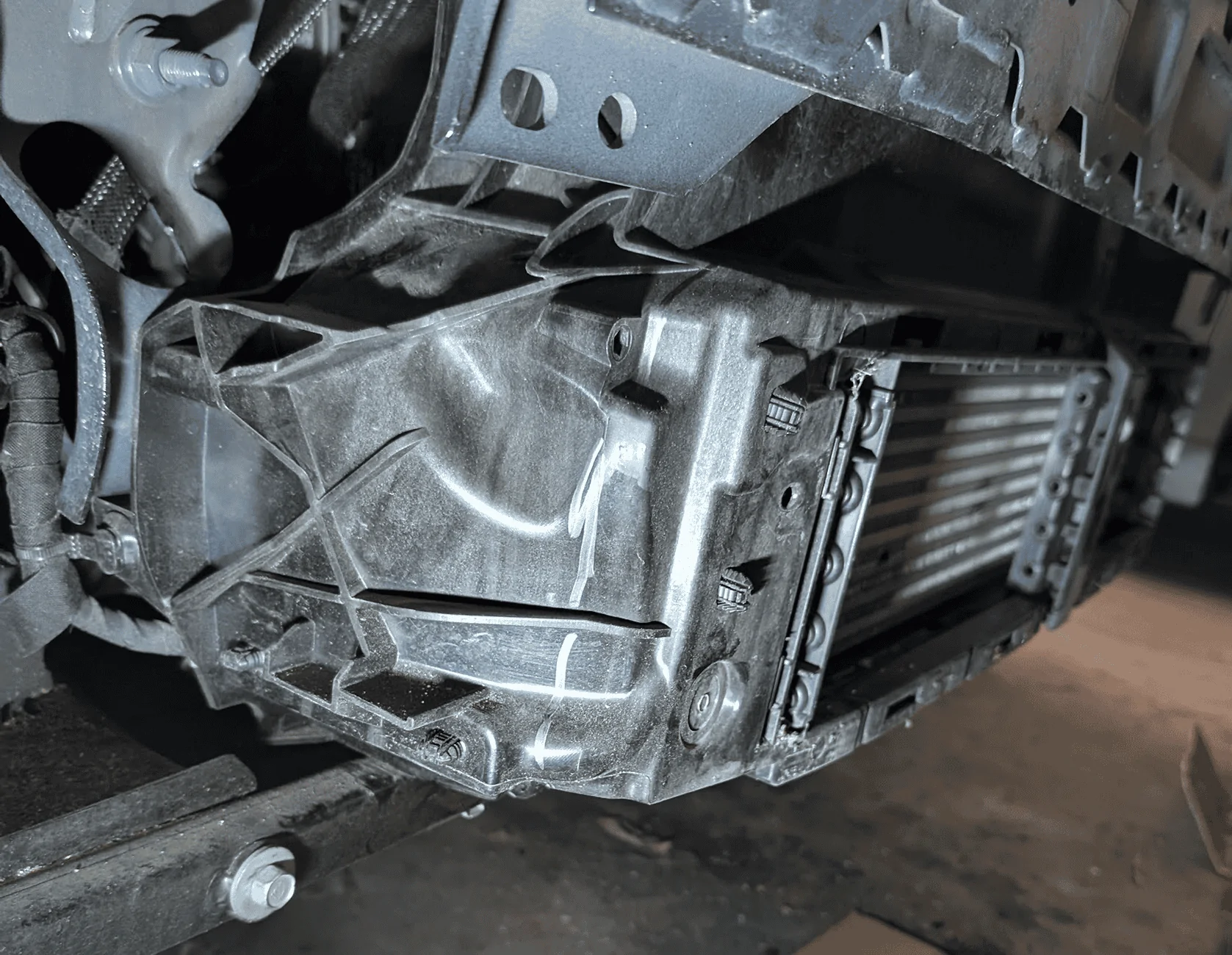

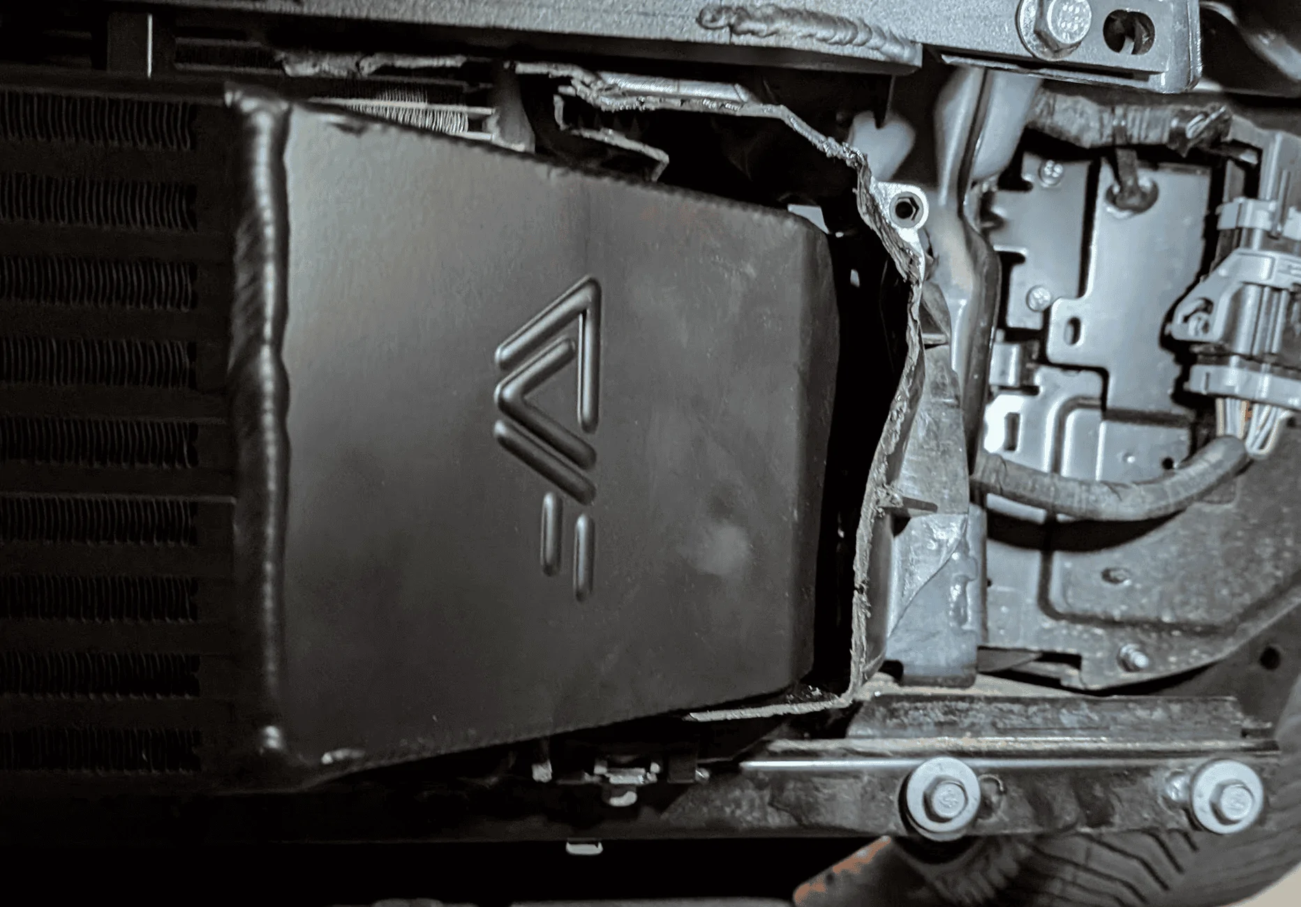

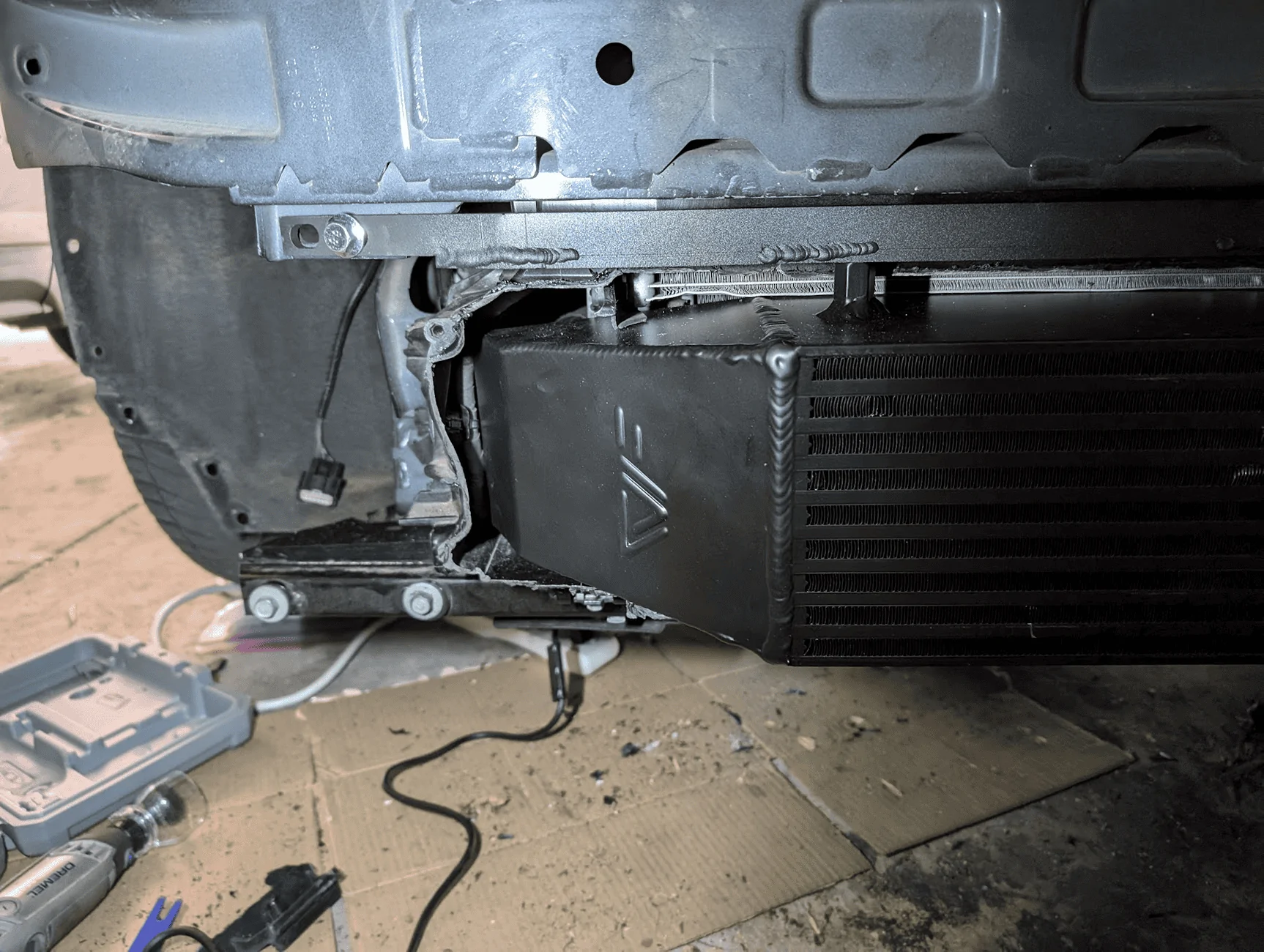

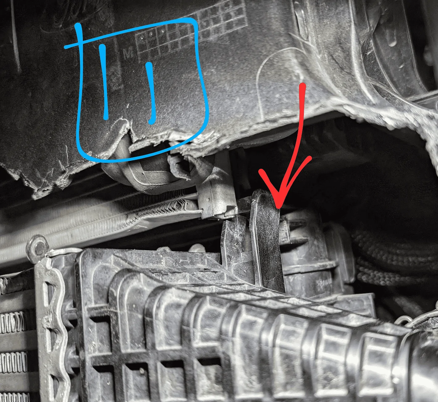

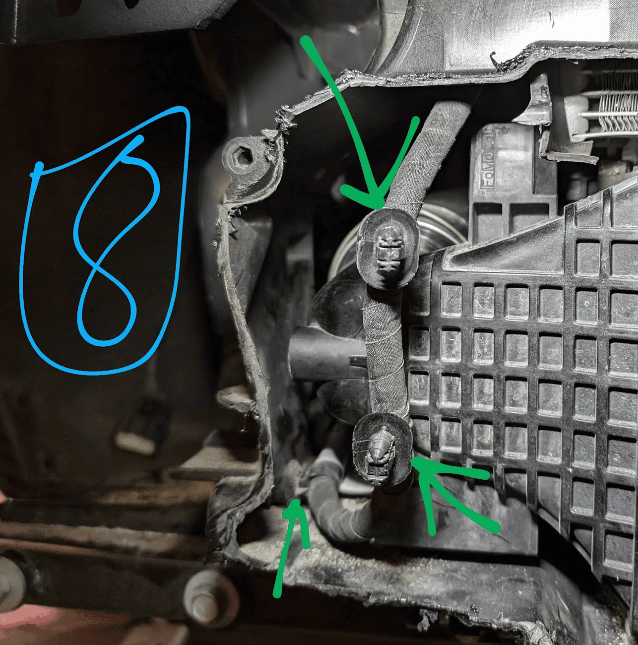

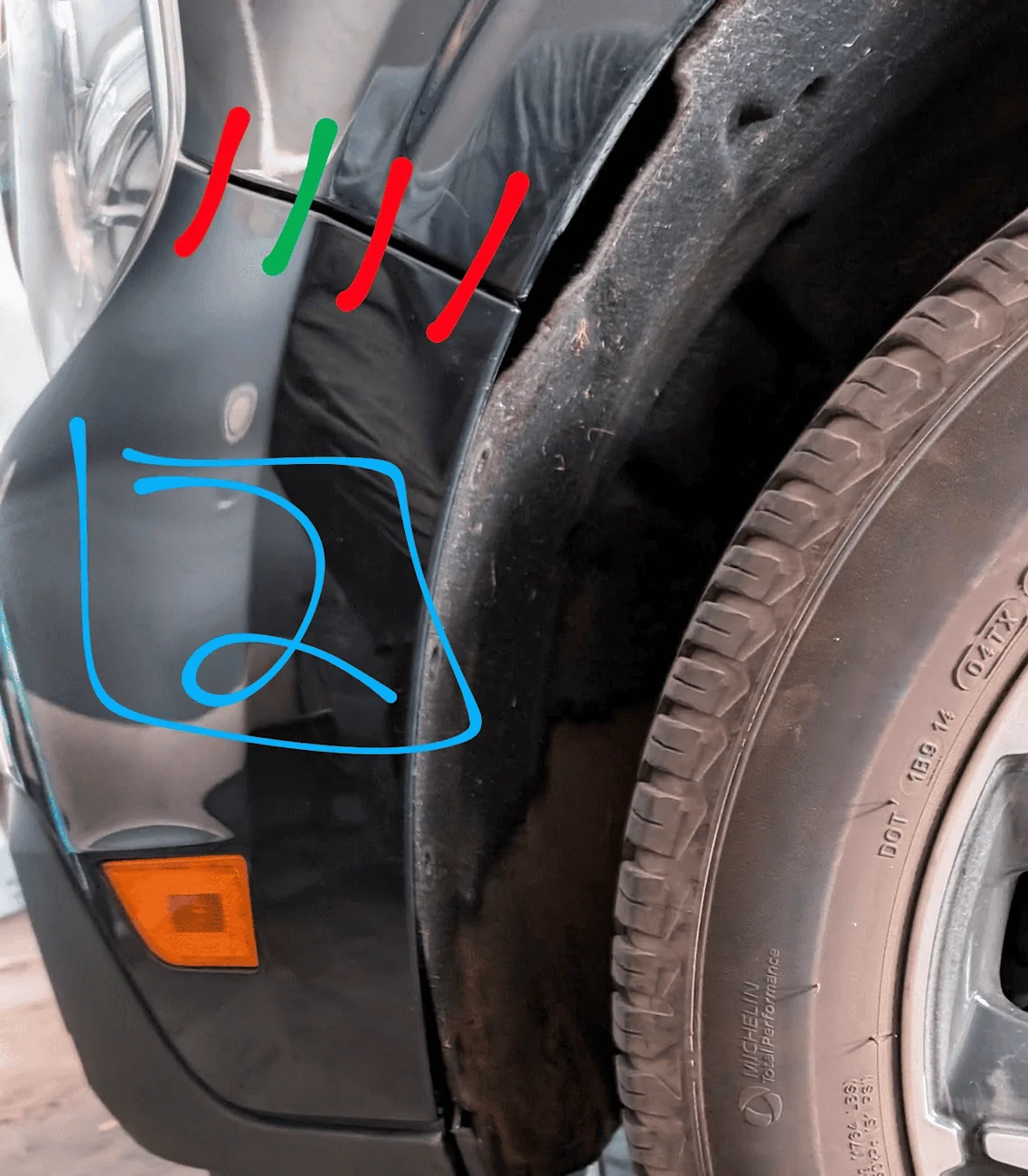

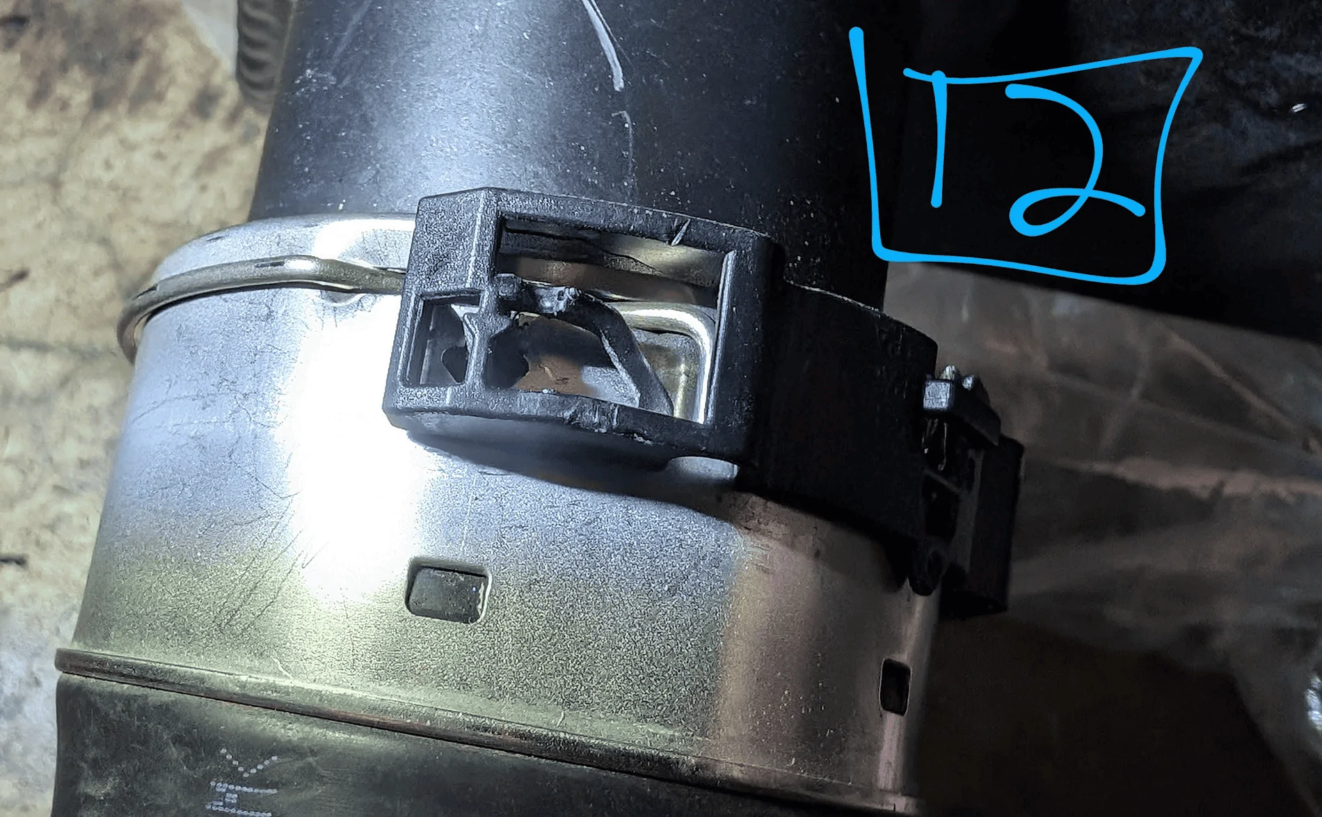

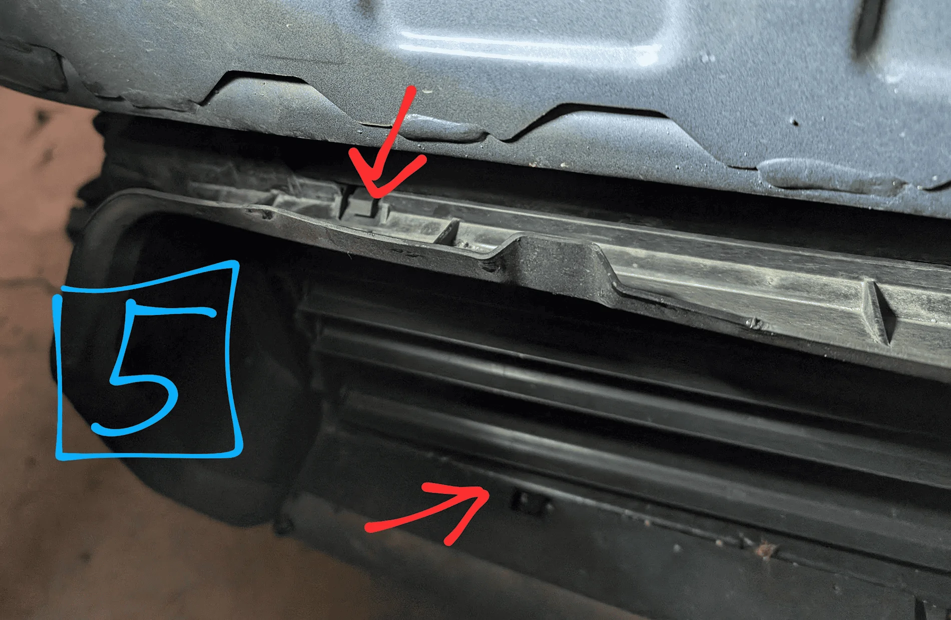

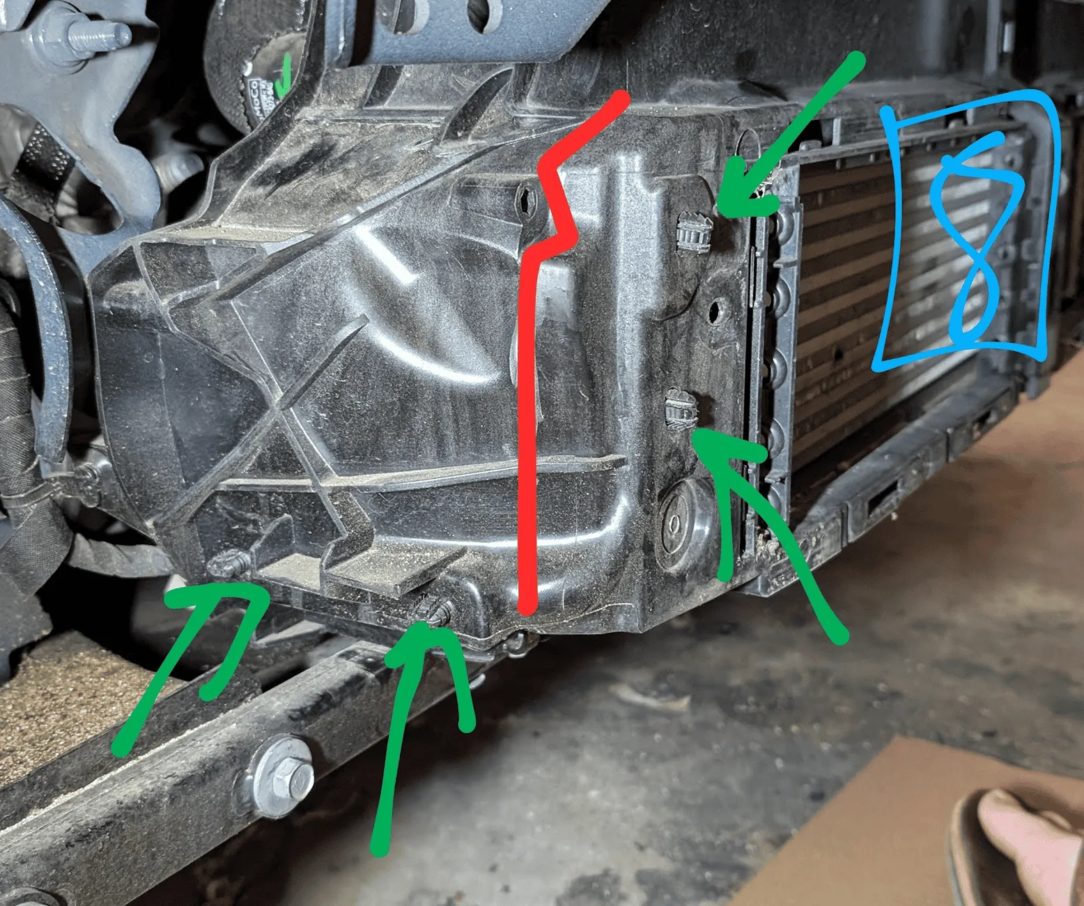

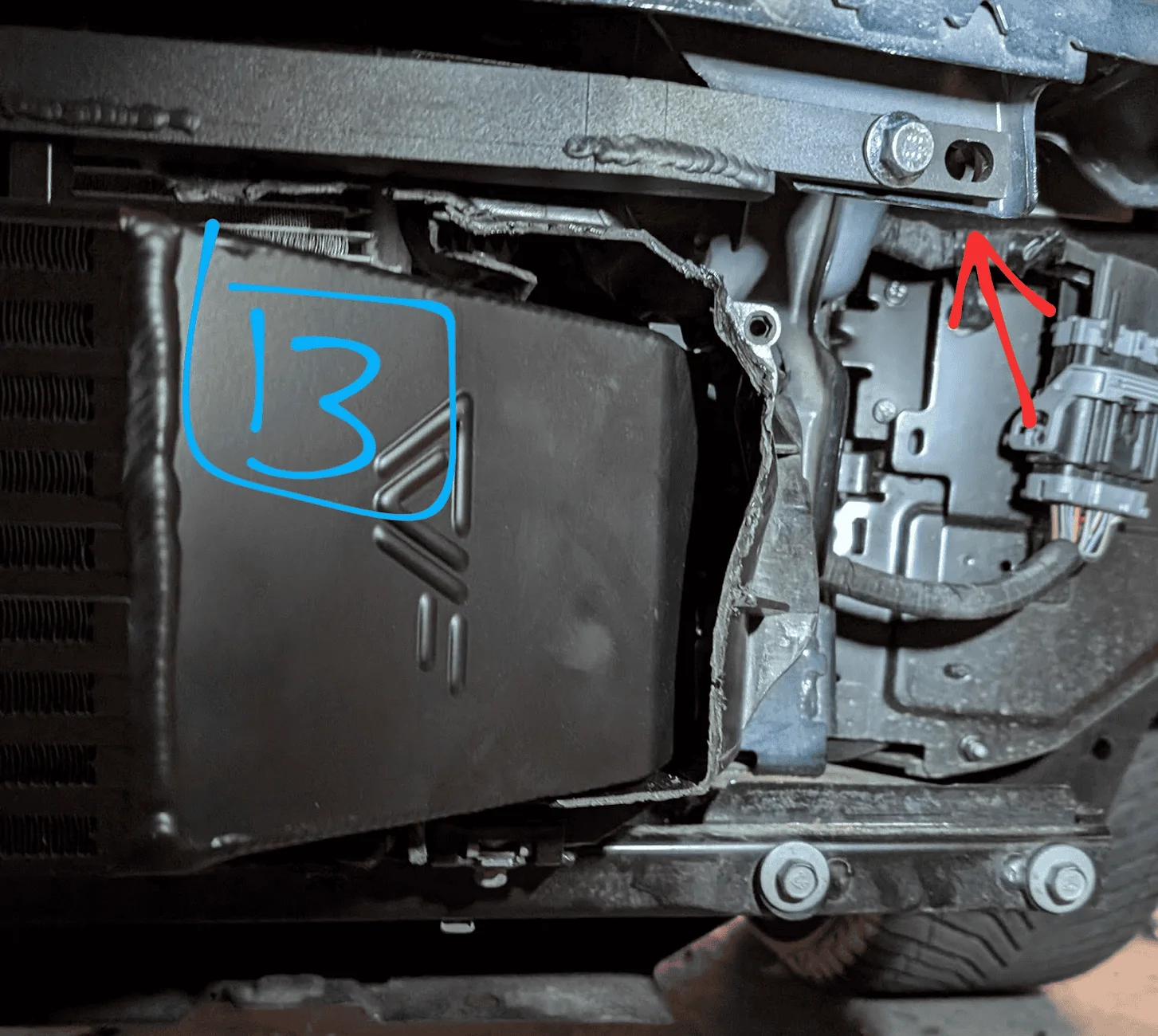

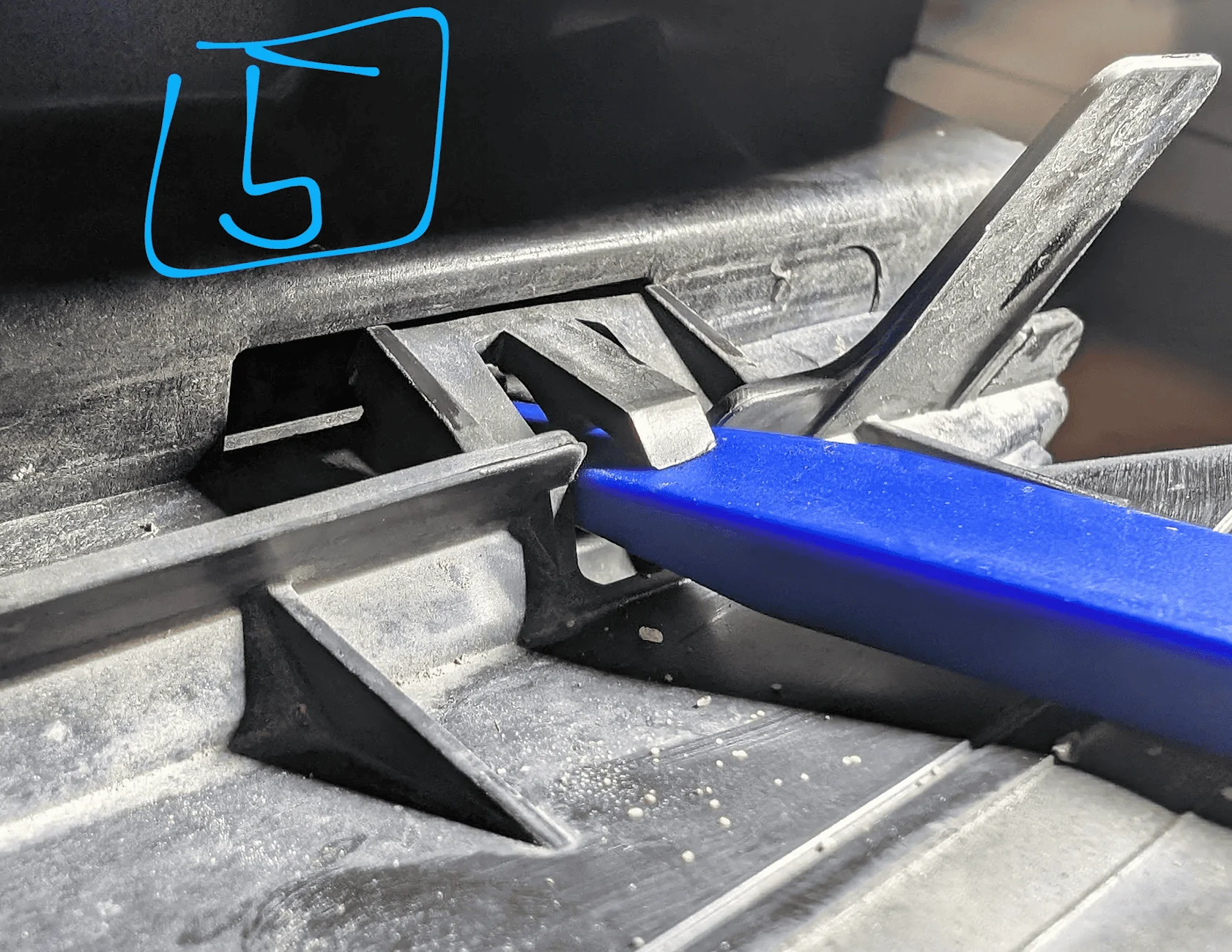

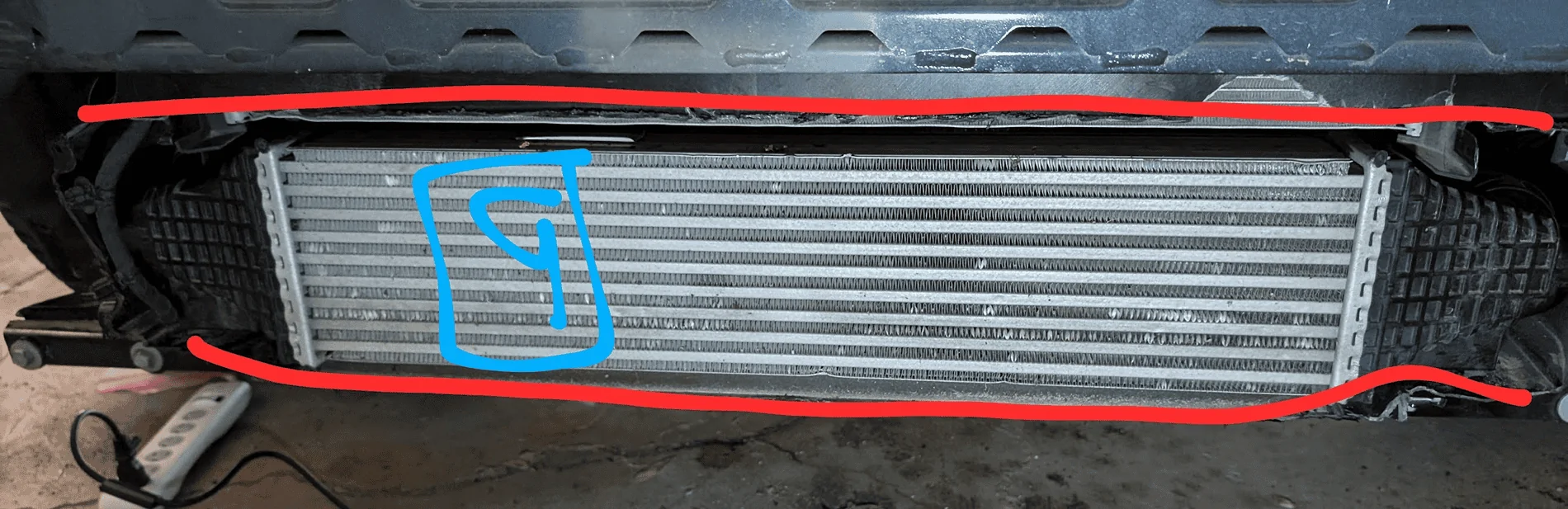

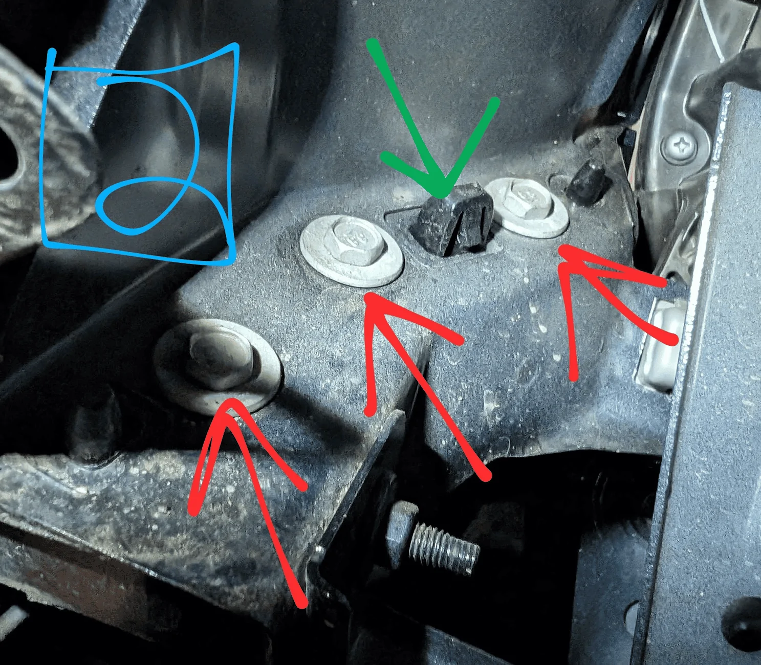

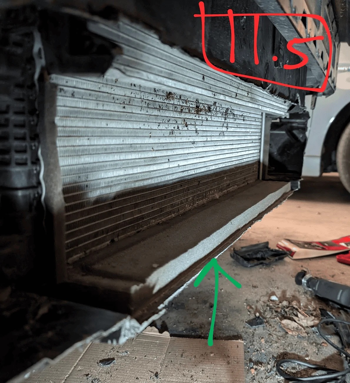

Hope it helps others with their install. It wasn't too difficult, just a good amount of cutting.
Main difference over the Tremor @Barksdale123 , were the recovery hooks (Tremor/FX only), plastic I left behind, and it looked like the plastic box around my intercooler was different.

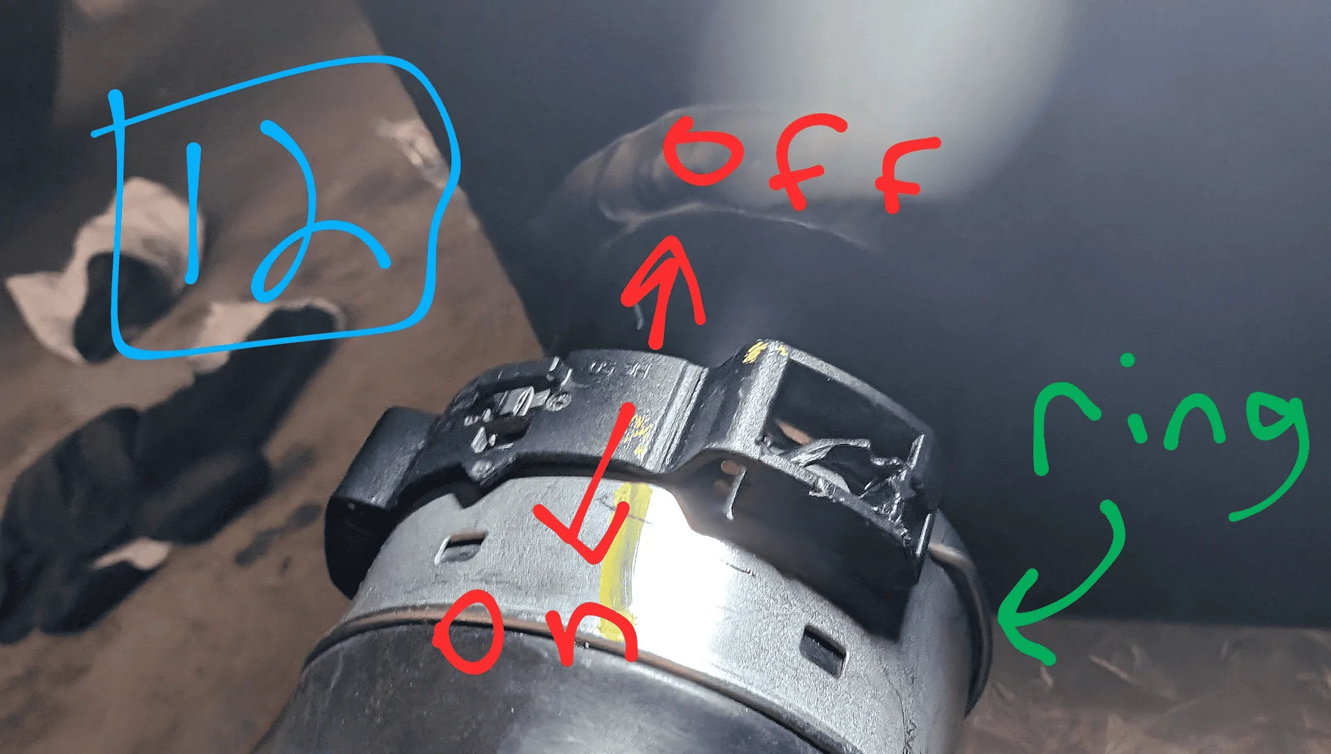

It could be a re-design after the 22', but I don't think I could have re-attached the hose the the new inter-cooler and had to do the hose clamps. Pictures below show the sides of the air box go to the frame. I may have just left a lot more of it, but the's not much space to re-attach the hose. I definitely saw the notch to release the clip, but not sure how to fit it back on

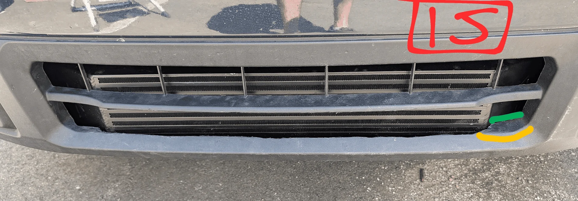

- I'd open up more of the bumper to let air flow on idle (maybe cut slits so it can rise from the bottom)
- Put in some wire mesh/screen over the whole bumper opening for bugs (there were a TON of bugs behind the old intercooler)
- Likely drill/cut holes for water drainage. Not sure if it's needed at this point

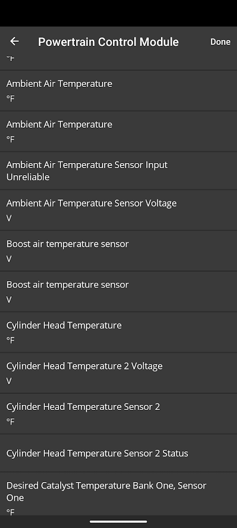

IAT is measured just past the air box. you want charge temp. 👍
Cheers! Thank you

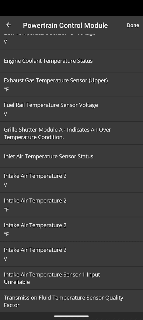

@colinl, any idea the exact name of the PID and/or what bank or network it's in?
I wasn't able to find charge or boost temp, and only saw boost temp voltage, meaning there likely is a gauge, but not sure what I'm missing
Here the options of network A
Ford Maverick CVF Intercooler Install on 2022 Maverick Ecoboost 2.0 -- DIY instructions writeup with photos 1722278683788-et
Ford Maverick CVF Intercooler Install on 2022 Maverick Ecoboost 2.0 -- DIY instructions writeup with photos 1722278647241-wi
Ford Maverick CVF Intercooler Install on 2022 Maverick Ecoboost 2.0 -- DIY instructions writeup with photos 1722278715433-kw
Intake Air Temp 2 in F is what you want to monitor.
Perfect! That's what I'm tracking already, thanks for the help.
Ford Maverick CVF Intercooler Install on 2022 Maverick Ecoboost 2.0 -- DIY instructions writeup with photos Screenshot_20240731-111822
