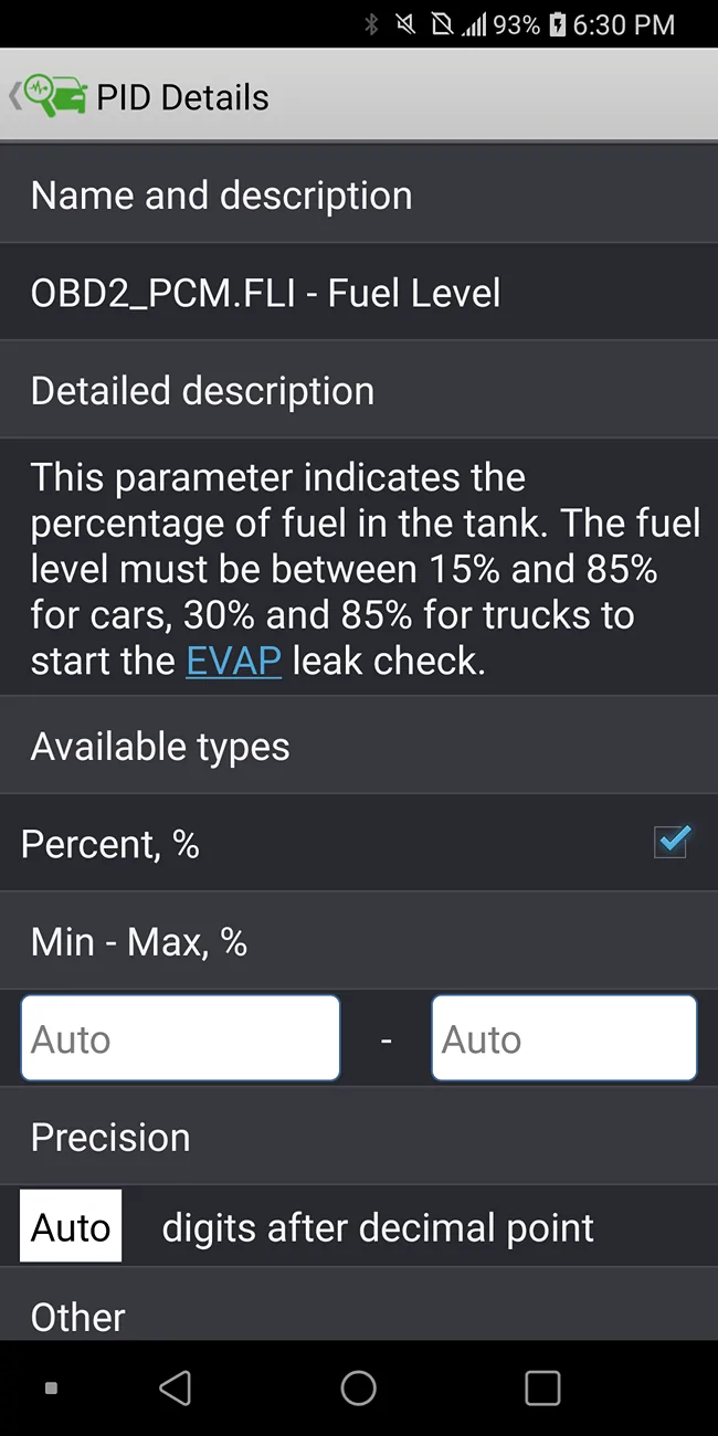

Well see that is a nice difference with the Maverick perhaps.
It will only test those EVAP system when 30-to 85% full.
So if full - no possible complaints since no testing!
Ford Maverick Never keep pumping gas after the nozzle clicks!!⛽ Screenshot_20251118-183040

To be fair all cars have been testing EVAP this way for like 30 years almost. It's pointless to test a full tank because there's not sufficient volume for evaporation, and with a nearly empty tank it's too hard to be accurate. I suspect his issue was something else and will likely come back at some point.
