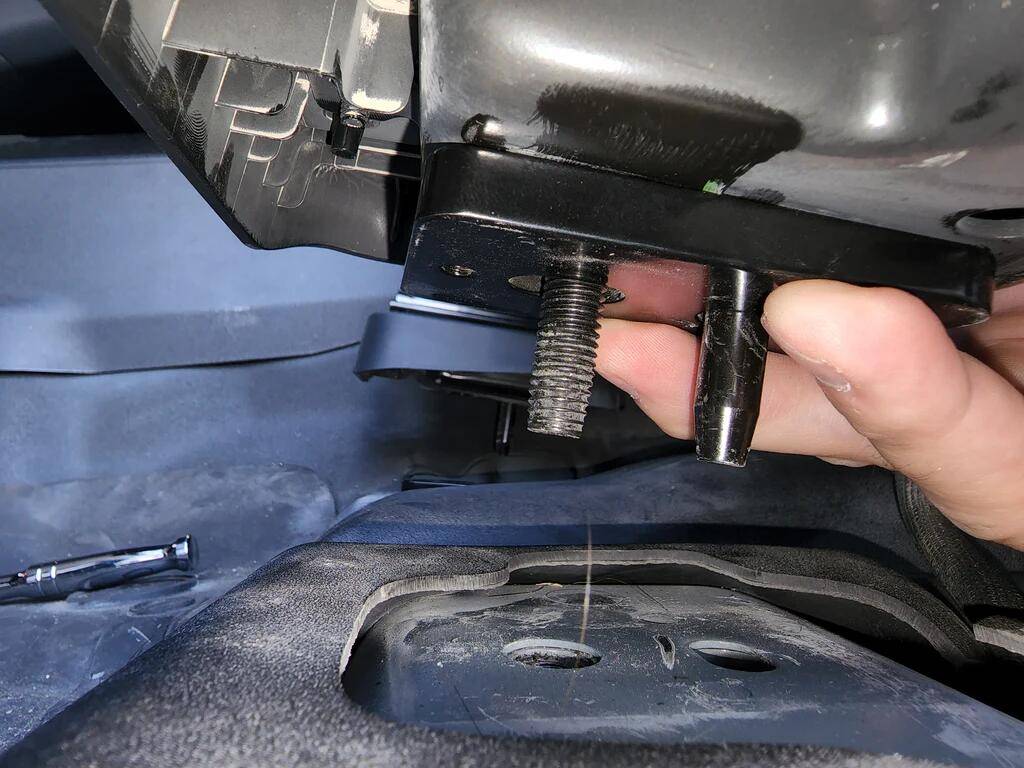

I added washers under the front bolts of the rails in order to lift the front edge of the seat. I think I raised it about 1/2" which made a big difference in comfort for me and cost about $2.25 and 6 minutes. I used 3 of these on each side.

As @Sovande said, I’ve personally found raising the front edge for better thigh support is very helpful. If the washers approach doesn’t give enough angle, there is a product out there (seat jackers) that include the hardware to raise even further. I ended up DIYing something similar.
As far as the “lumbar support in the wrong spot” issue goes, it would be pretty invasive to adjust that. Would need to pull off the upper upholstery, foam, and drill new mount holes in the side of the frame. In case you were wondering.
