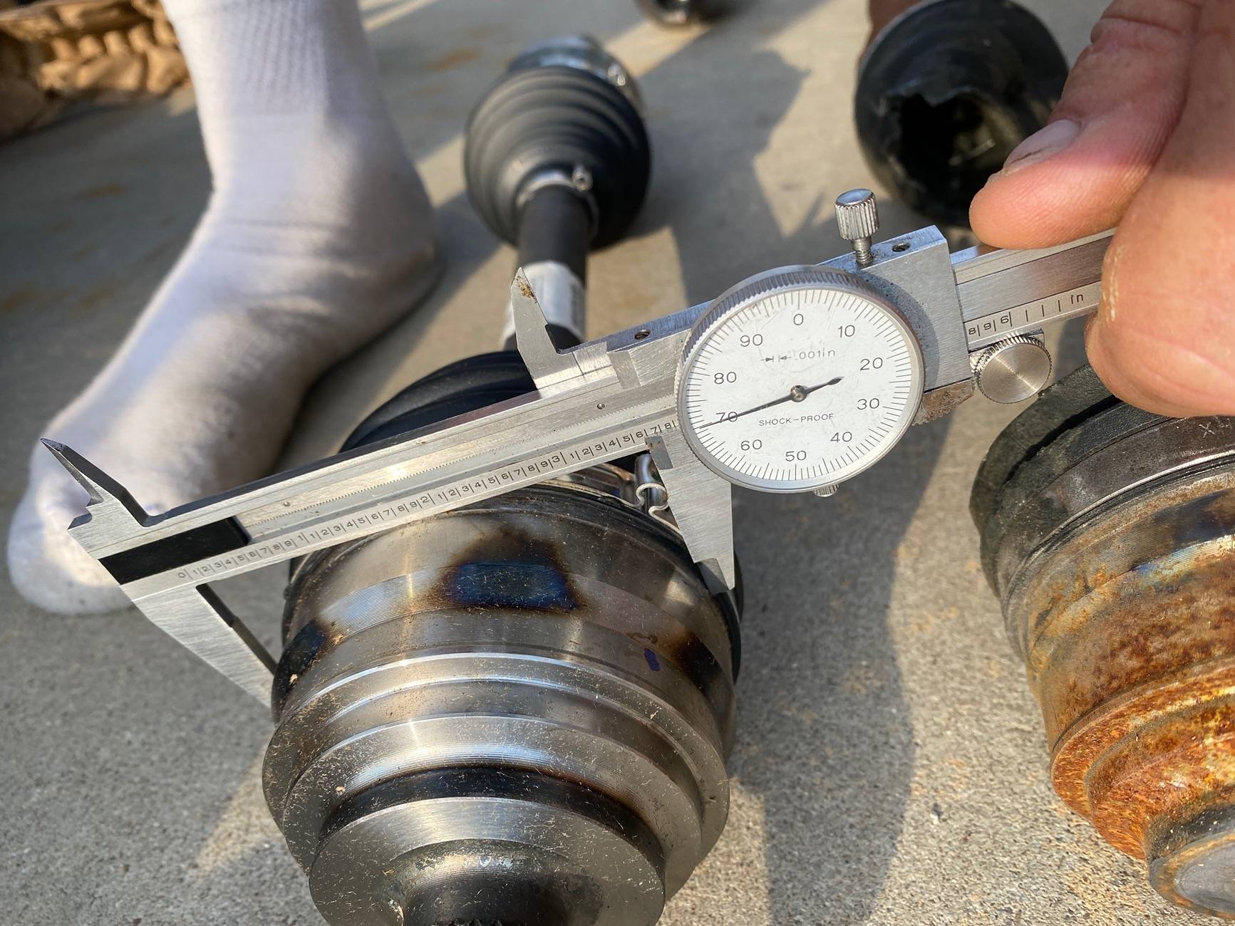

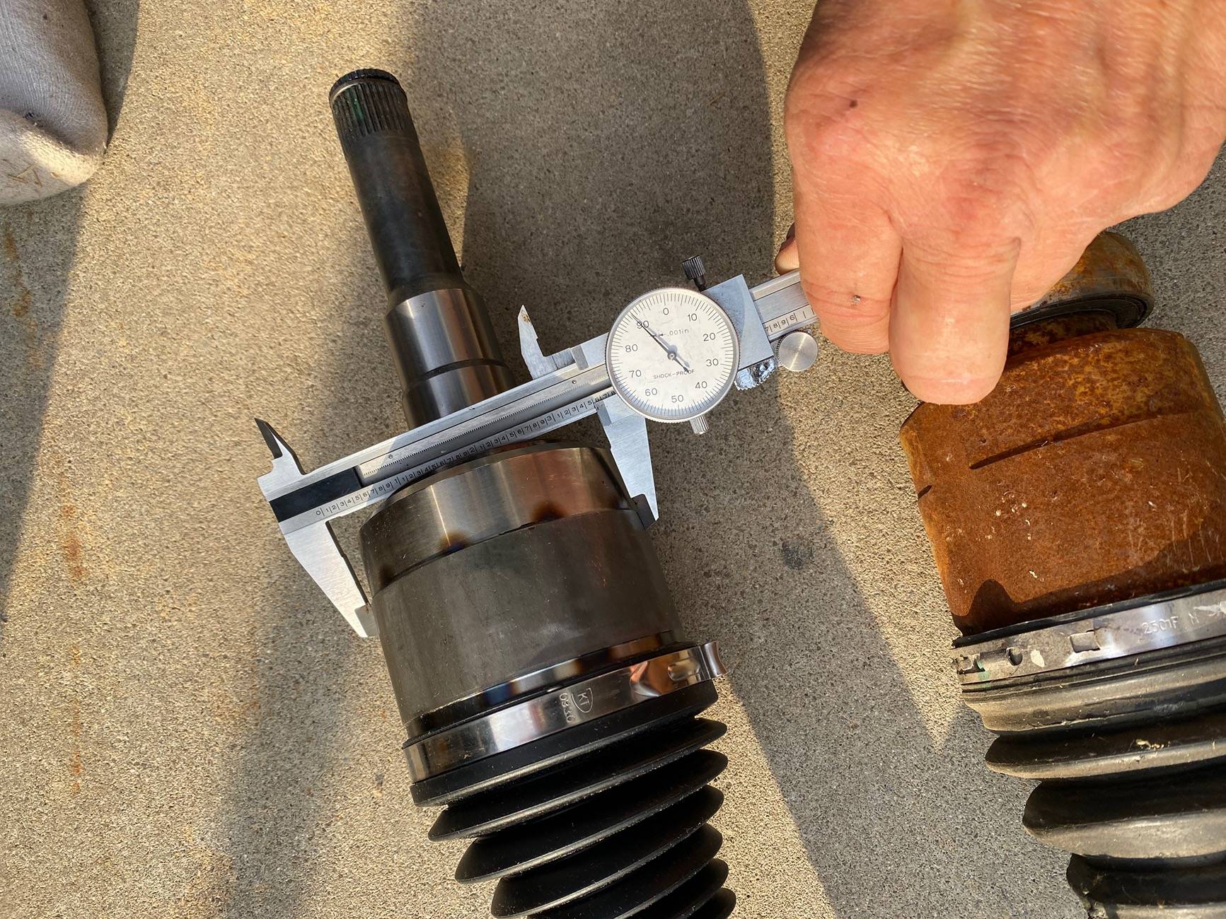

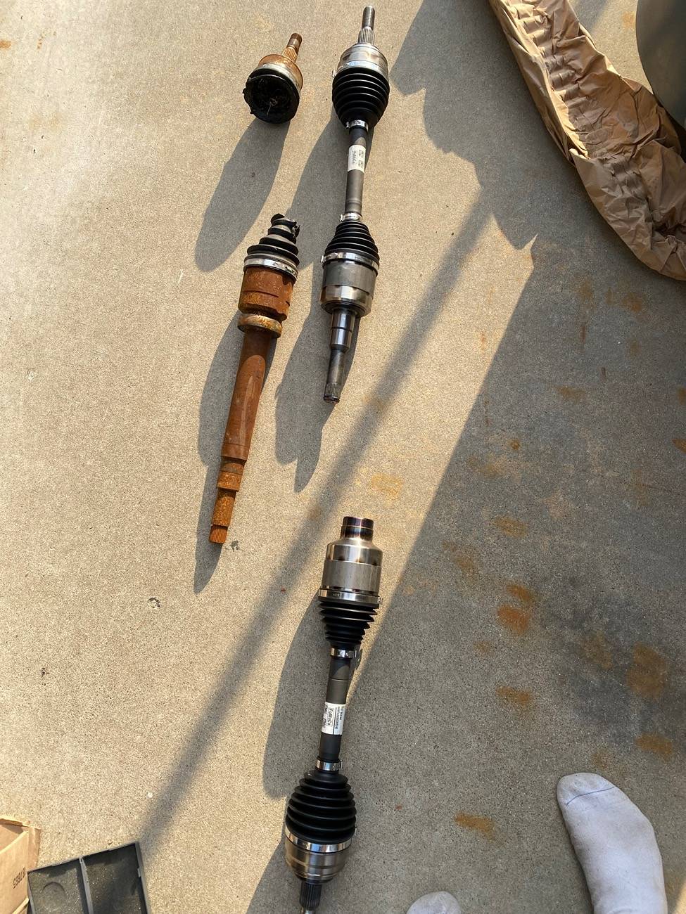

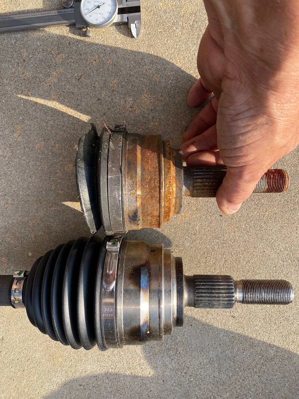

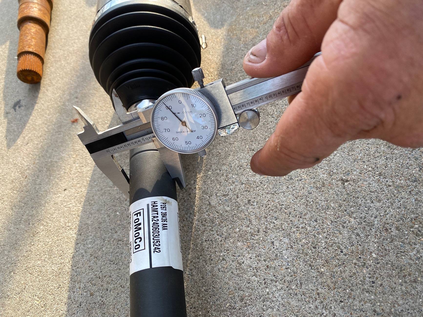

I think the problem is the Right Hand Axle with the female spline on the inboard axle. This was the only axle I could feel by hand that had play, it was wobbly when I grabbed and shook it (radial play) while it was installed on the truck. Looking at the splines, it has 2 splines that dont exist, I have no idea why they would do this, there is no master spline on the male end coming out of the PTU, the Male end is fully splined. With the 2 splines missing, I think its more susceptible to increased wear from vibration. The new Axle also came with the female spline with big gaps 180degree out.
Wear on the inside of the Inboard female spline housing
When this happens again, Im only going to replace the Right hand axle and see what happens.

Use tremors on the std ecoboost
about $ 405
The boots and grease suck on all of them.
Hybrid needs an equivalent to tremors .
Comparison of tremors to hybrid proken pass side i have too.
Do you have a photo of the female splines on the Tremor Axle? (right hand axle)

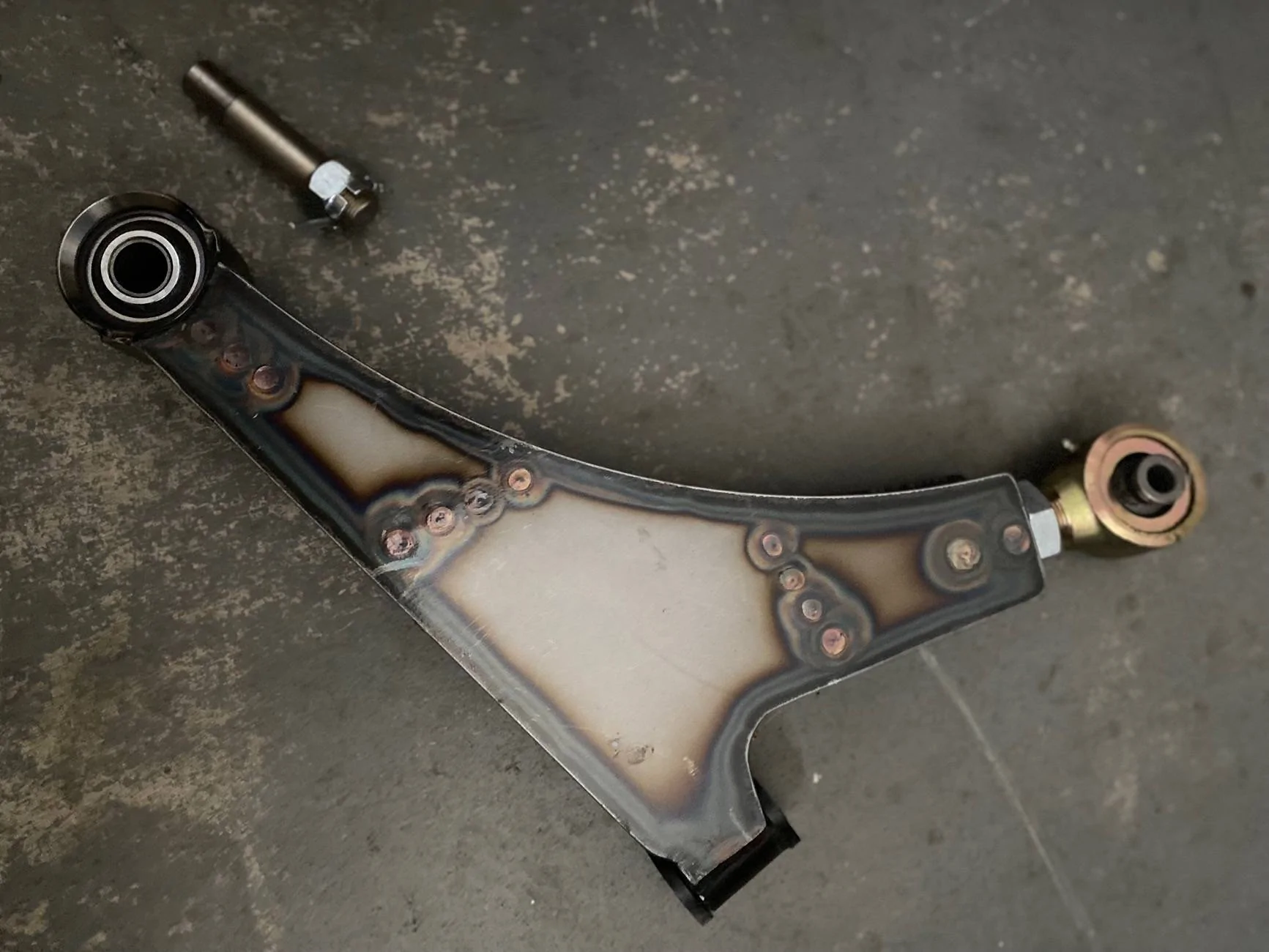

What makes the ball join unreplaceable? I am am machinist and have replaced lots of unreplaceable parts...
Well they dont even sell a seperate Ball Joint for the Maverick. The only serviceable item on the lower control arm is the Vertical rubber bushing.
All things are possible with the right amount of knowledge and tooling. If you figure it out, let us know.
I just went 1” uniball and a poly bushing and rebuildable Jonnie joint

I went 1” uniball , with a poly bushing inboard a rebuildable jonnie joint
May 8, 2024
Hunstville, AL
Maverick XL
The truck is pretty new. Probably not much aftermarket. How is it installed? I can't tell from the diagram. Pressed in and staked?
@Bwicka Nice man! You have skills beyond my current abilities. What was your goal with the new design besides repair-ability?
Survival, along with the lightweight sheatmetal crossmember , being replaced with chromoly too .in testing phase with that , will post once it is dialed.the new crossmember will be a 4” lift item with steering correction and slight correction for axle shaft angle and wheelbase to accommodate 33” tires with total clearance throughout travel .eventually a + 31/2” arm per side for up to 12” wheel travel .and about 6” total lift with the tires , while keeping axle angle at road going angles within a degree, degree and a half of stock.
Kind of old stadium truck stance and travel from mickey Thompson days.but 4 wheel independant.
