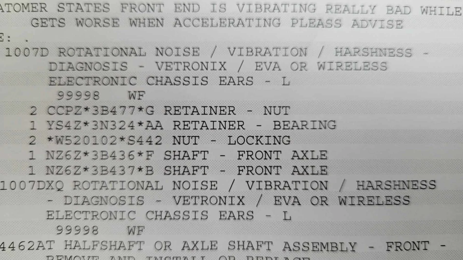

I think the problem is the Right Hand Axle with the female spline on the inboard axle. This was the only axle I could feel by hand that had play, it was wobbly when I grabbed and shook it (radial play) while it was installed on the truck. Looking at the splines, it has 2 splines that dont exist, I have no idea why they would do this, there is no master spline on the male end coming out of the PTU, the Male end is fully splined. With the 2 splines missing, I think its more susceptible to increased wear from vibration. The new Axle also came with the female spline with big gaps 180degree out.
Wear on the inside of the Inboard female spline housing
When this happens again, Im only going to replace the Right hand axle and see what happens.

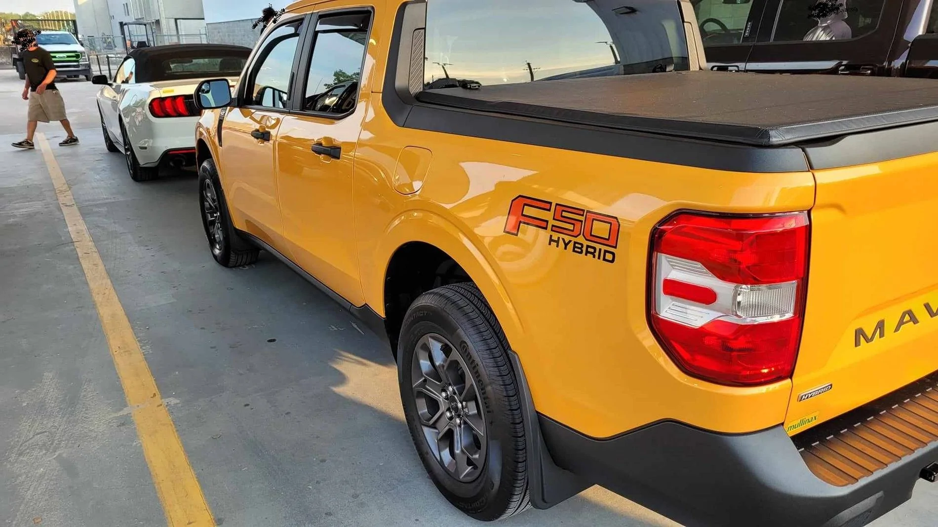

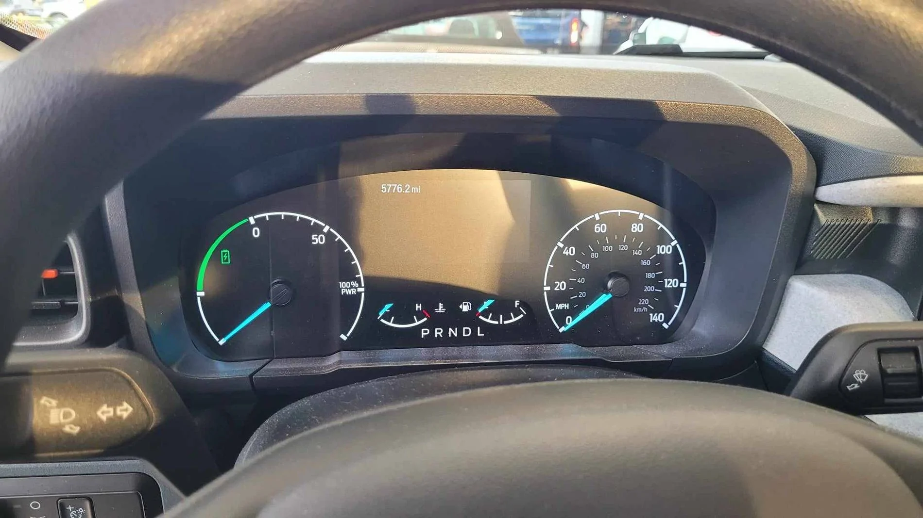

I had mine fail on my '23 hybrid at just under 6,000 miles, a few months ago. Completely unmodified suspension, never towed anything and never had anything heavy in the bed. Strictly used as a commuter to and from work and the occasional trip to the store. I'm almost 52 and drive somewhat conservatively, typically getting close to 50 mpg. The service manager told me it happens frequently with the Maverick. So frequently in fact, that I had to wait two weeks because the axles were on backorder. Central Florida area.
EDIT: Another thing I would like to add is that I wouldn't expect to see very many people post their issues in a forum like this. Most people that buy vehicles don't belong to groups like this. We just happen to be fans, or at least more interested in the Maverick than the average consumer. Those that modify their trucks would be much more likely to belong to a group like this. Therefore, I would expect more complaints to come from the modding community. But for my axles to fail at less than 6,000 miles, doing nothing but driving like a normal older dude, there is obviously something wrong with the design or manufacture of this system.
