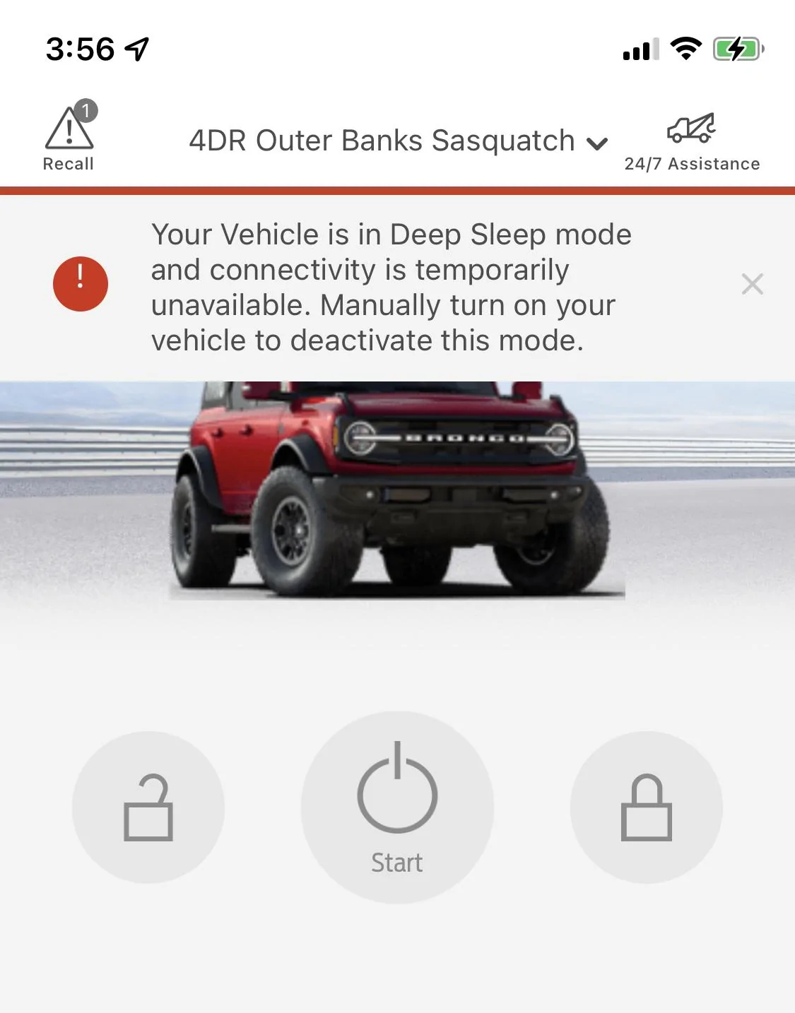

I believe it’s running tests, connecting, and sending data. Open up your fordpass app when it’s dormant and try updating and checking your tire pressure or such. It will make those noises. After 2 weeks of not being started up it will go into a deep sleep mode to save the remaining battery life.
