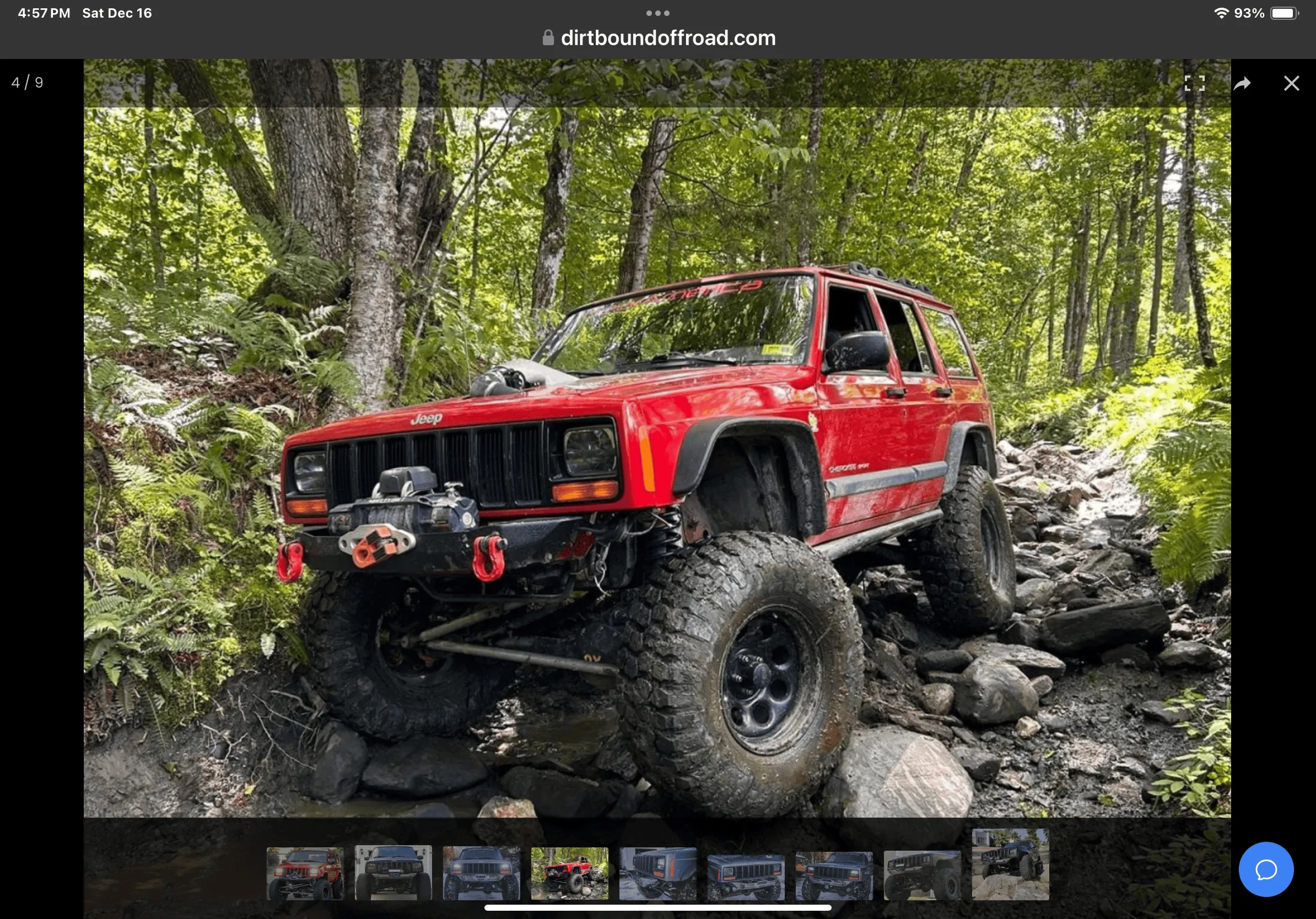

i Have considered a custom sheetmetal type bumper, but I’m going old rough rider ( team)style on my build ,maybe even the graphics.thats why mine is Oxford white.
Ford Maverick Mounting winch bumper on a Maverick IMG_0219
But as far as crashworthiness,insurance ,and airbag stuff , this kind of mod is no different than the 600,000 +jeeps out there with airbags(yj on up ?)that have all changed bumper , grills , winches , fenders ,flares ,axles ,transmissions ,engines, hoods and anything else jeep that doesn’t work off road.
keep it up !

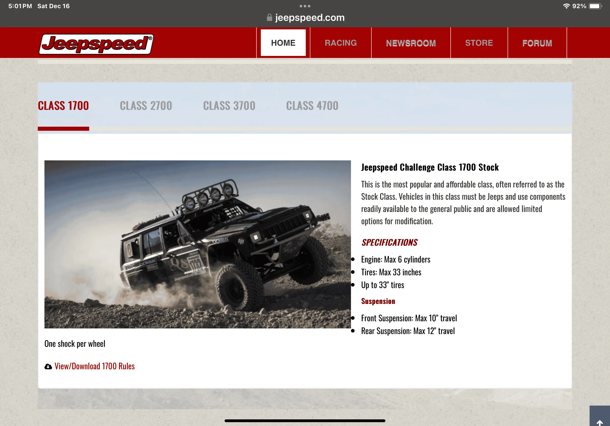

And to all the naysayers……
Ford Maverick Mounting winch bumper on a Maverick IMG_0221
THESE RIGHT HERE……
Ford Maverick Mounting winch bumper on a Maverick IMG_0222
ARE 100% UNIBODY VEHICLES!
have been for 30+ years
