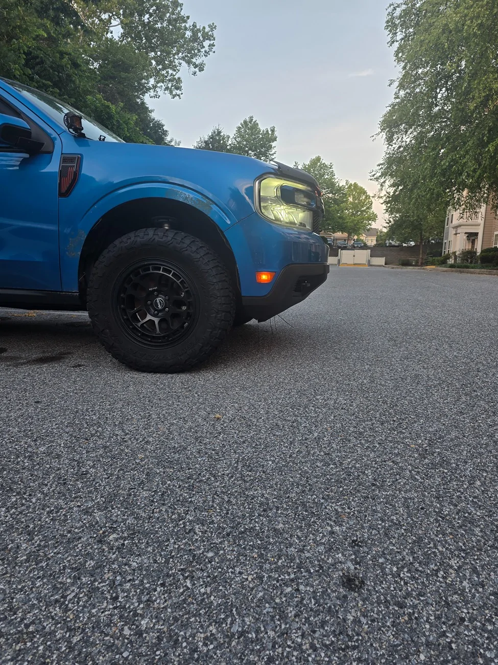

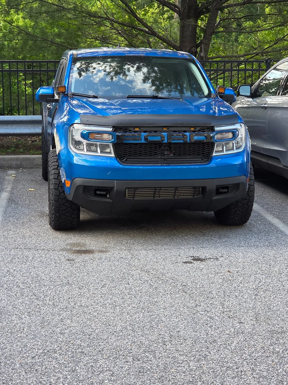

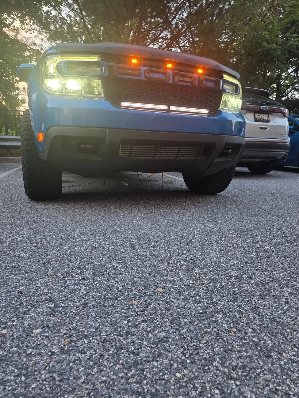

Not done yet, waiting for the new (tremor) skid plate to come in 2 days, then gonna swap out the wheel well liners and upgrade the fender flares (ones i initially went with are dog shit).

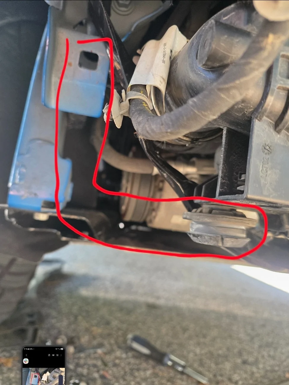

Ill be happy to post in depth instructions when its completed, but feel free to ask anything and ill answer with what I got so far. Attached is also some hideous brackets used to hold up the radiator/intercooler. They dont gotta be this ugly to work.

Did you swap out the radiator, or manage to keep the original, and make it fit?

I was able to keep the og radiator and intercooler, just needed to basically remove the entire bottom half of the housing theyre in, fabricate new brackets to hold it as high and far back as it (the radiator and intercooler) could go, and swap the support frame brackets (LX6Z-7810124-AL and LX6Z-7810125-AL)

FX4 radiator is bigger than Tremor
