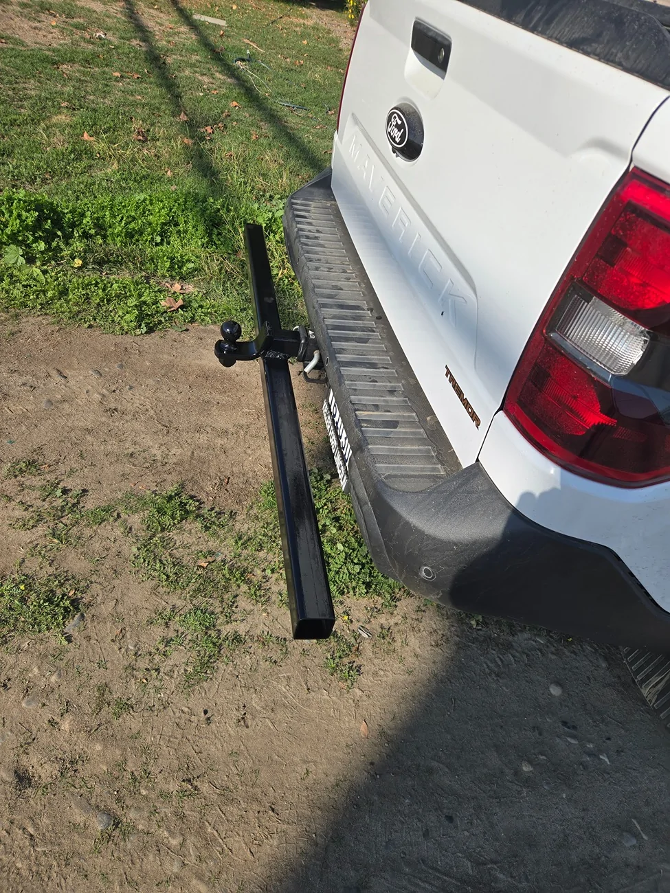

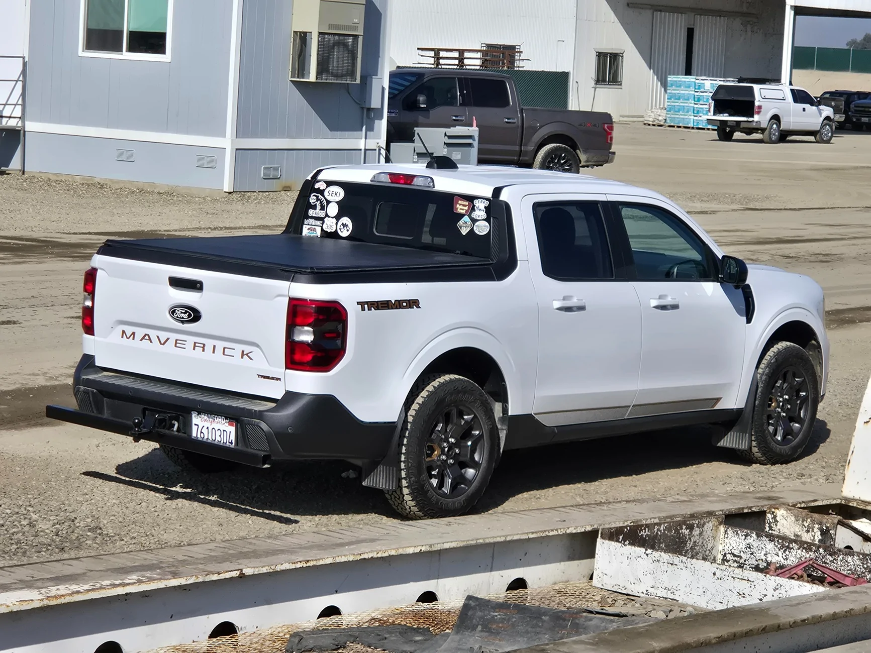

You may have seen a couple photos of my homemade rear bumper bumper that I just posted as comments in other posts. I have been thinking of making something like this because the departure angle on the Tremor is so bad compared the the approach angle. I was bottoming out the rear bumper frequently and I was afraid I was going to take it off one day. What I came up with is pretty simple. It is just a 6' piece of 2.5" square tubing welded to the underside of the removable hitch ball mount. I did not do any welding or modifications to the truck. If I want to remove it, I just have to take out the hitch pin and the whole thing comes off.

I see what you are trying to do, but I'm not sure if it's going to help in the long run. I say that, given that the hitch is attached to the unibody crumple structure. I suppose as long as you keep speeds low the chances of damage are low enough. I hope it works out.

I definitely take it easy. If I would have tried that same dip without the bumper bumper, the plastic bumper cover would have bottomed out instead. Sure, this is my fun off-roading camping vehicle, but it is also my daily commuter and my only vehicle. I don't get too crazy with it. When on the trail, my mantra is, "I have no where to go and all day to get there" :)

Looks practical for your use, but my shins freaking hate it. :crackup:

That's cool :) I didn't hardly spend any money on it. I already had the hitch. I got the tubing from the scrap metal pile at my work. All that it cost me was the electricity to cut off the ends, clean it up, and weld it, and then one rattle can of black paint :)

that's a lot of leverage waiting to happen to the hitch receiver
I intentionally did not make my welds very strong and hopes that it will give out before Ford's welds do. It's not the kind of truck to do much rock hopping. I mostly stick to mud and sand. Hopefully I never have to find out who's welds were stronger :)

Yes, that is still the original factory tires and wheels and suspension height that the truck came with. I have only added those mud flaps, the tonneau cover, and now my bumper bumper. They do make much narrower skid plates that attach to the hitch but I wasn't looking to protect the middle of the bumper, I was looking to protect the corners of the bumper. I had already partially taken off the plastic bumper cover on the passenger side and to this day it usually will not stay snapped in right there below the tail light. The reason why I wanted to protect the corners is that if you are going over a dirt embankment or something that you know will be too much for the angles, you just take the obstacle at something like a 45° angle, letting each wheel take the transitions separately and reducing the problem with breakover. What this does though is bottoms out the corners of the bumper when departing. This is my first solution to that problem. I did not want to cut the bumper which is a more extreme solution to the same problem. If you always plan on going through dips at a 90° angle like I did for this video, you could probably get away with a much shorter piece of metal underneath there to reduce the chances of breaking your weld on your hitch or the Ford welds attaching the carrier.

I'm going recommend naming it the Shin-Killer!
I am happy to report that I haven't hit my shin on it yet. After a lifetime of bashing my shins on assorted hitches, I think my body subconsciously stays clear the rear of pickups LOL
