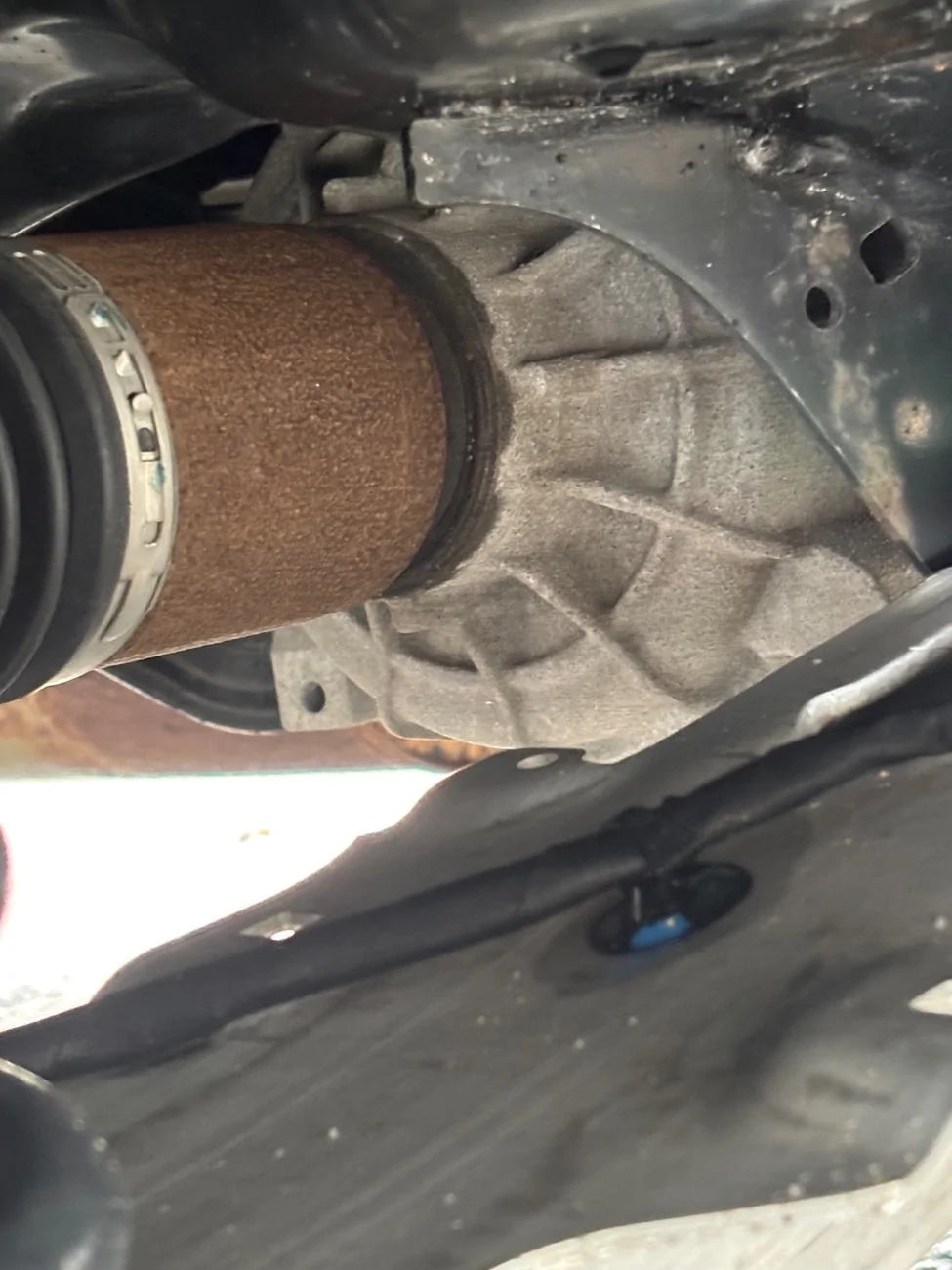

My 24 is also doing this when it's cold. 24k miles but I'm going to change out the trans, ptu and rdu fluids. Absolutely fine when warmed up so I'm hoping it's just underfilled or a drain and fill will rectify this. Love the truck but man...the trans. I have a cpo 100k warranty on the trans so I will also be taking it in if this doesn't help.

I HAVE AN UPDATE.
Have them do the RDU Fluid, they found metal and pieces of the clutch pack. They are replacing the clutch pack but the not the entire RDU and I will update if that solves the issues.
