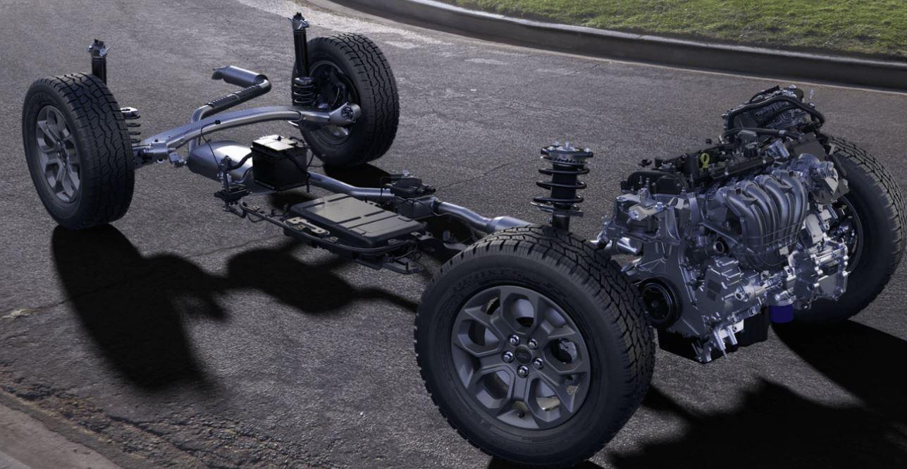

So is the battery under the seat the only battery and the one that powers the electric motor when the hybrid is running off electric power only or is there a second battery elsewhere?
Yes there’s two batteries, both different. Even Tesla has a 12v.
The Hige Voltage (the "second") battery is the bigger, flat, square thing in the picture above this post.

So hybrid battery in Maverick is old-fashioned lead? Why isnt it L-ion?
The High voltage battery for the electric drive system is Lithium Ion, we are talking about the 12 volt battery, which yes is a AGM Lead acid battery. Most likely due to price. A Lithium 12v battery likely costs 2x what a AGM does.
